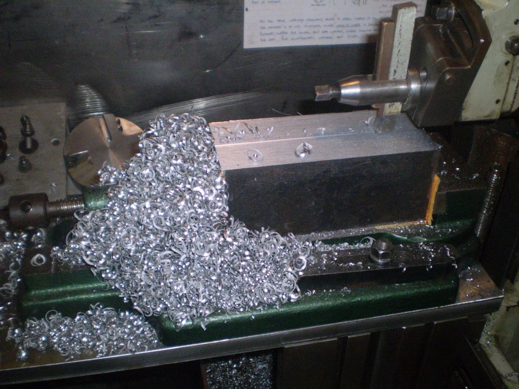

                          #310933
                          thaiguzzi
                            @thaiguzzi
                            #310934
                            thaiguzzi
                              @thaiguzzi
                              1978 Boxford 8", well the metric S200 version.
                              Table extension, large capacity rack vice fitted. 2 pieces of nasty flame cut steel long enough just for full stroke extension. Got 5 Dickson/Bison toolholders out of 1 piece, so you're looking at the start of 10 holders.
                              Table top extension also allows fixturing of Vertex 6" HV rotab and tailstock centre.
                              Swarf, 2 very different types.
                              Bottom pic is roughing out, probably a 0.040- 0.060" DOC.
                              Top pic is fine finishing with a shear tool, not more than 0.002-3" pic does not do the stunning finish this tool gives.
