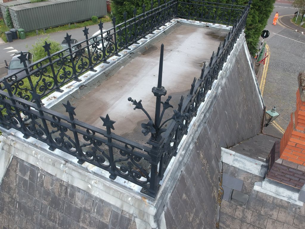

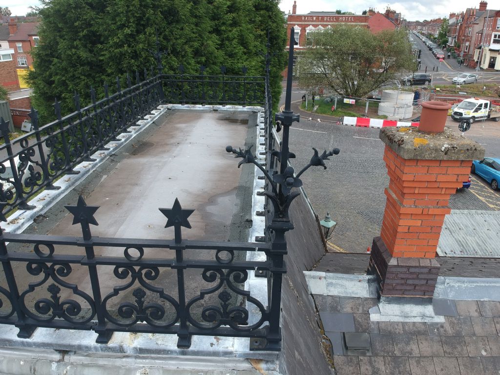

              Posted by Andrew Tinsley on 14/07/2017 14:20:38:
              My advice is to avoid powder coating like the plague! It is great until you manage to damage the coating through to the base material. If it is steel, then rusts creeps underneath the coating and spreads like wild fire. The amount of powder coatings I have had to strip and repaint properly,runs into many hours of work. It has now got to the stage where I will not buy items that are powder coated and that is an awful lot of stuff!
              Andrew.
              Andrew
              You might like to know the crestings at Kidderminster SVR station were installed well over 20 years ago. These are cast aluminium and were powder coated before installation.
              Other than the toning down of the original garish high gloss finish there's no visible sign of deterioration despite being exposed to the elements for all this time.
              I do agree, great care was taken to avoid any damage to the coating during during installation.
              The design was closely based upon those crestings that were created at MacFarlane's Saracen works in Glasgow.
