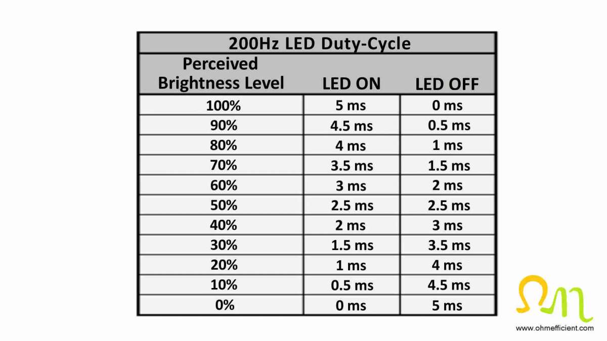

                  If the shunter is battery powered, might be worth dimming the LEDs by pulsing their power input.   Dropper resistors work by converting unwanted current into useless heat, not good.   More efficient to chop the power up, so that the LED is dimmed by only being ‘on’ for part of the time.   The human eye won’t detect flicker provided the chop rate is faster than about 40Hz.  This table is for 200Hz:
                  200Hz-LED-Duty-Cycle
                  The NE555 chip was/is popular for this, there are some dedicated chips, and the functionality is trivial for a microcontroller.   The cost is extra complexity.   Dropper resistors may be inefficient, but they’re nice and simple.

                    Er no, not unless there is a circuit with an inductor rather than a resistive dropper. Pulsating a resistive LED dropper will make the efficiency slightly worse.

                      I got as far as typing “Er no, but no” when it hit me Macolm is on to something!   Gut feel is my PWM suggestion is misguided, no use to Colin.   Belly hurting too much to get my head round why not!  Yet  another problem on my ‘To Do’ list…

                        Actually using pulse drive on LEDs is very effective.  While Macolm is correct and an inductor is normally used to smooth the current in a PWM supply this is not the best approach for LEDs.
                        It’s a physiological thing. The human eye responds to peak intensity not average. So a LED driven with pulses looks brrighter than the same energy used for constant illumination. The trick is to use something like 80% of the peak current rating and appropriate duty cycle. A couple of random datasheets for Red LEDs rated at 20mA nominal shows 100mA peak and 10% to 30% duty cycle.
                        https://www.farnell.com/datasheets/2925628.pdf
                        https://4donline.ihs.com/images/VipMasterIC/IC/AVGO/AVGO-S-A0004682023/AVGO-S-A0004682023-1.pdf?hkey=6D3A4C79FDBF58556ACFDE234799DDF0
                        So if we use 80mA and 15% duty cycle the average current drops to 12mA, The total power drops to 0.089W (down from 0.148W)  and the average power “wasted” in the resistor (now 68 ohm) drops to 0.062W
                        All this and the LED looks brighter.

                            An inductor used as a simple buck regulator where the LED replaces the capacitor, and with the feedback to control the current will deliver pretty good DC and stable brightness to the LED. For many applications that is a very good solution. Granted pulsed LED operation may provide a slight boost to subjected brightness, but it also risks strobe effects which can prove a nuisance. Both will also need supply filtering.
