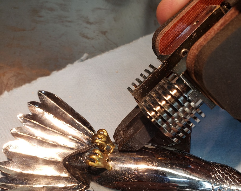

      Hi. My name is Patrice Lemée and I am a metal sculptor. I need help with resistance soldering and this seemed like a good place to ask. It’s hard to find people using this and I think you guys do. It’s not about models per say so I hope it is still ok to ask. Let me know if it’s not.
      I have purchased a soldering unit from American Beauty. Very happy with it so far but I am having a small problem. Well I hope it’s small. I am trying to solder a small piece to a much larger piece as you can see in this picture.
      The thing is I need to put a lot of heat into the larger piece for the solder to properly flow to it. The result is a perfect solder joint but the carbon electrodes leave marks. Since I am doing this on a near finished sculpture and in hard to reach places I need to minimize this scarring of the surface. Not sure how to do that or if it’s even possible. These are carbon electrodes and they glow red hot from heat, more damage from the electrode e that glows more and also a little powdery residue on it afterwards.
      Not sure if I explain myself well or if anyone here has an idea of how to do this better but I am taking a chance and would be very grateful for any help. Or of course if anyone knows of a better place to find info on this that would be great.
      Here is my latest sculpture and the small feet are what I am working toward soldering.
      Thanks for you help.

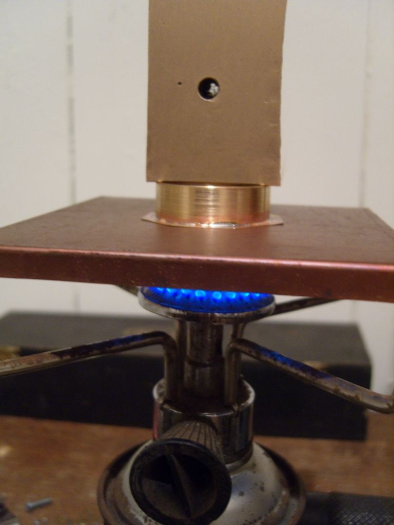

                  Hi Patrice, I'm not familiar with resistance soldering or its techniques, but like Kiwi Bloke has said, maybe pre-heating could be an answer. If using a flame directly is not desirable, then maybe a hot plate of some description might in order, which could be heated in a few different ways. One way I used a hot plate instead of a soldering iron or a direct flame, is shown below where I soldered a thin piece of brass shim to a thicker brass ring and then turning it over to solder another one on the other side.
                  The heat source is a cheap camping stove type attachment for a gas blow lamp cylinder and the block on top is just to hold it down. Hope it can help or give you inspiration for some other technique.
                  Regards Nick.

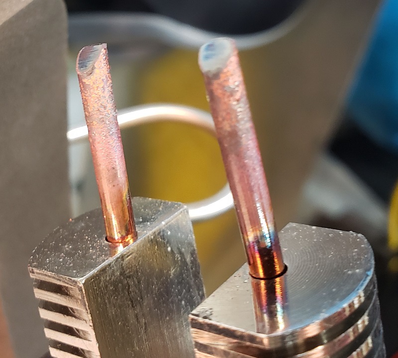

                              Patrice Lemée
                                @patricelemee72098
                                Vidar, thanks for the info, definitely worth looking into

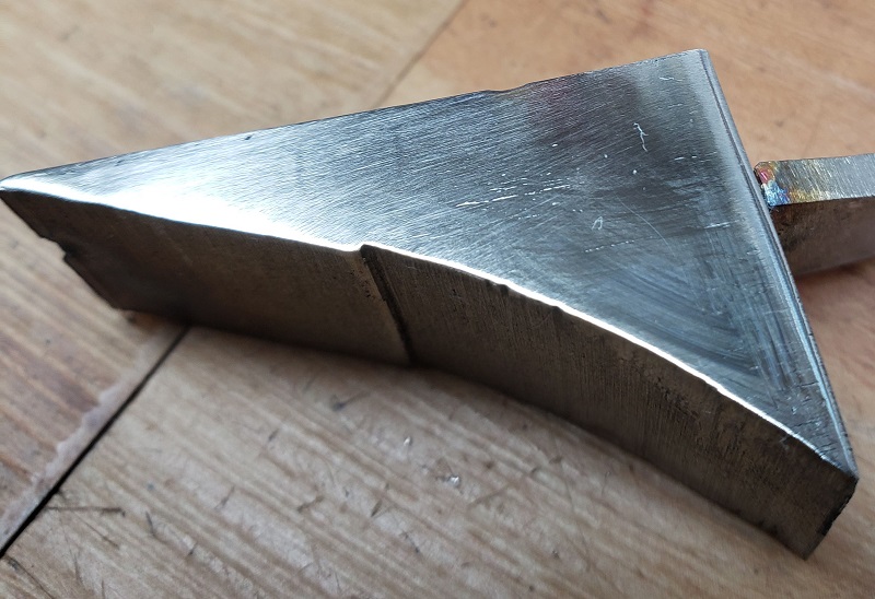

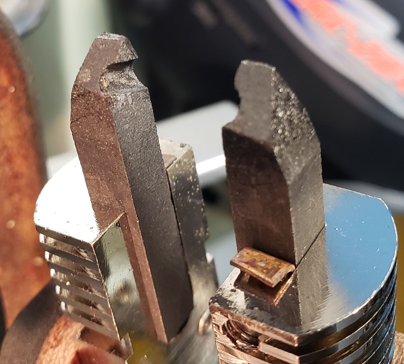

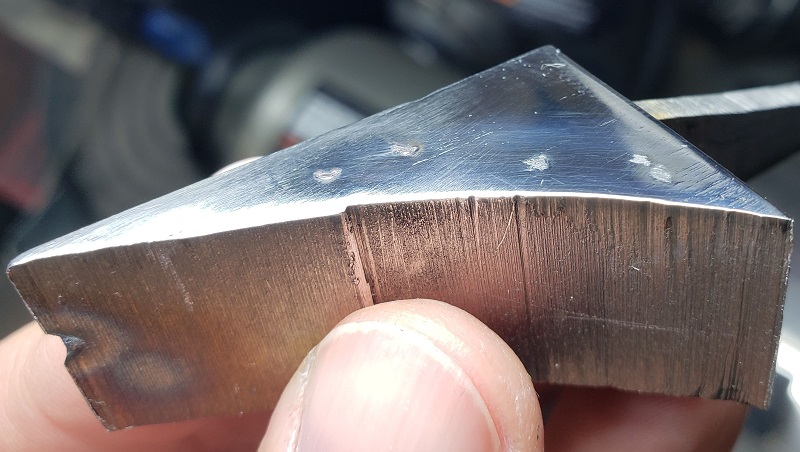

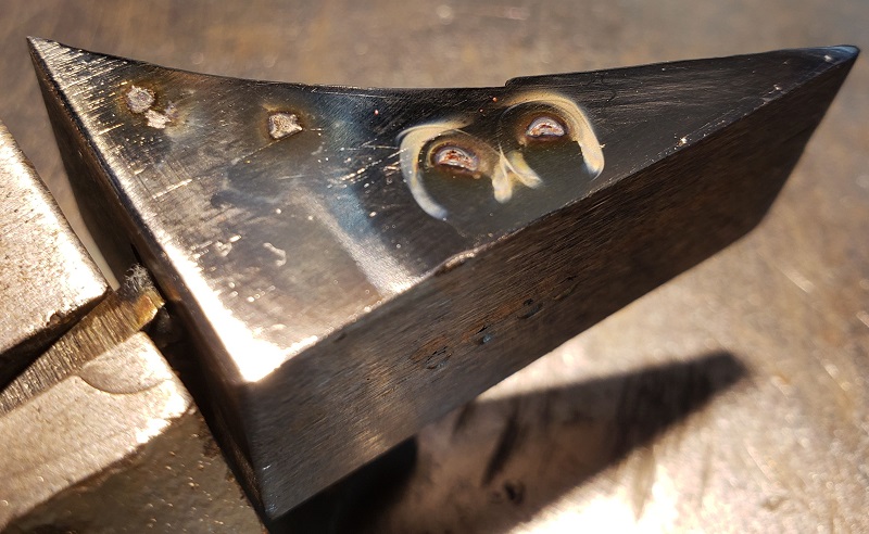

                                Here is what I did today in the shop.
                                First I cleaned up a piece of 304 stainless and put somewhat of a mirror finish on it as I would on a sculpture for example
                                Then flattened a pair on electrodes, these are the copper coated ones.
                                and cleaned up the flat on the carbon electrodes
                                I then applied some heat using the highest output my machine will do and about the amount of time needed to melt the solder. Here is the resulting marks. Carbon electrodes on the left and copper coated ones on the right.
                                I then cleaned up a bit with a small buff wheel and green chrome using a rotary tool like I would in tight spaces. Sorry, this time the carbon are on the right and copper clad on the left.
                                As you can see the carbon ones leaves much less of a mark. The copper even deposited a bit of copper on the surface. So I think the carbon electrodes are my best bet and what I need to try and improve.
                                Here is a pic to give an idea of size and other concerns like a curved surfaces and also to show how hard it is to get close keeping in mind that I also need to be able to stick a solder wire in there.
                                That’s why as much as I like the sacrificial plate idea I don’t see how to implement it.
                                Mind you the amount of scarring is not that bad. I might have to live with it or find a way to incorporate it in the design. But I would still like to see if I can’t minimize it some more first.
                                Thanks again for looking and all your help. I’ll post more as I find it and of course feel free if an idea no matter what jumps to mind.
