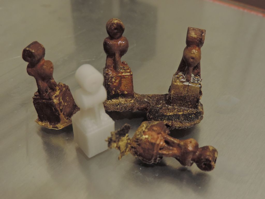

                    #637708
                      Thanks for the thoughts folks.
                      I know you can get SLA resin with a high wax content specifically for lost wax casting.
                      Cleanup seems to be something of an issue, the review will look at that. It seems the resin can sit in the printer for about a week without ill effects. I have got a washing and curing machine, but obviously that's for prints not the 'vat'.
                      Those links are useful too.
                      Rather like when I explored FFD, I'll start with what I'm supplied which is a standard resin and chiefly 'decorative' parts for models. In fullness of time, I'm keen to explore the potential for making working parts with the better definition of SLA.
                      I've enjoyed my first experience of the supplied slicing software. Hoping to do my first print tomorrow! Wish me luck.

                                  Noel Shelley,
                                  PLA is often recommended for 3D printing to produce castings for lost wax. My experience is that this did not work at all well and resulted in a high percentage of spoiled castings. I don't however know if this was due to lack of knowledge on the part of the foundry. Certainly things were much better using MOLDLAY. I could not simply change foundries because there are no foundries here in Australia that will lost wax cast in stainless in the smallish quantities I need.
                                  In my case I make motorcycle parts in stainless steel and I need to get the best finish and detail I possibly can. Otherwise the work involved is prohibitive e.g having to polish out lines resultant from poor 3D prints. Especially when these occour in hard-to-polish areas,
                                  As usual It is all a matter of horses for courses. I don't doubt that the castings shown in Neil's photo are suitable for his requirements but they certainly would not be OK for me.
                                  The comments made by Jason in this post are spot-on correct! The process of 3D prints to lost wax castings has many advantages – you just have to make it worksmiley
                                  Chas

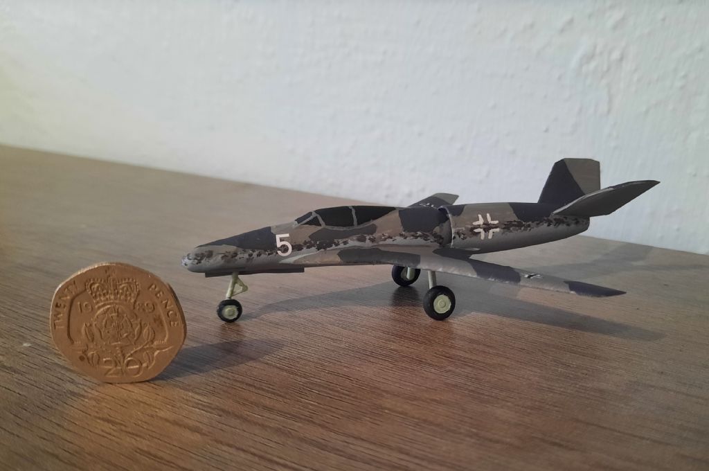

                                                    Sneak preview… something I designed a long time ago to try out Alibre for the first time. Please excuse hand-painted insignia!
                                                    An old render of the design
                                                    I bulked up the undercarriage a bit.
