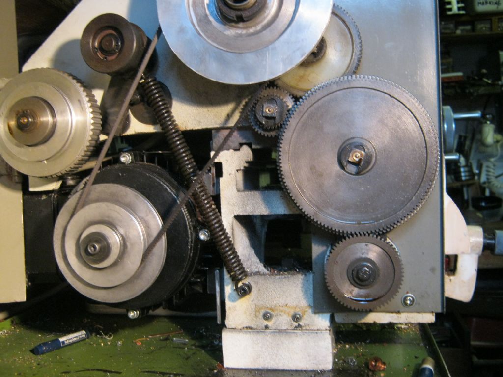

                                        Here is a picture of the drivebelts on my Chester DB-10G before I modified it with a 3 phase motor and VFD
                                        I think it is similar to the 920 lathe so it may be some help.
                                        Les.

                                          I wouldn't argue with anything that Redsetter has given you in the way of dimensions. The set up that Les Jones has photographed is pretty much the same as my 920 except that the belt tensioner bears down on the top of the drive belt. I took some photos this morning but because of the positioning of my lathe it was very much a case of pointing the camera and hoping that something useful was snapped. I think I mentioned that my lathe is inverter/variable drive and I would never go back to the original set up. With variable drive you do not need the upper pulley / clutch setup which would normally be driven from the motor via a toothed belt. The drive is taken from the pulley set on the motor direct to the mandrel pulley. I loop the belt over the centre drive pulleys and don't even use the belt tensioner so I have a built in clutch. I used to get through quite a lot of those drive belts before I fitted the variable drive and they are now mighty expensive. Touching wood, I have not replaced a belt in 2 years since fitting variable. I think that you said you have an inverter/motor…….if you use that you do not need a backplate and in my opinion you will have a much better, more tractable machine. A piece of 8mm mild plate would suffice to fill the gap. If you wished to incorporate the belt tensioner, the design is a bit crude with loads of latitude for a positioning bolt. Have a look at my set up and I will be happy to answer any further questions. Ihope this will have been of some use. Mick

                                              Hello Les and Mick,
                                              Thanks for the help and encouragement. Mick your suggestion of just using the 3 step pulleys and a VFD has really put the cat amongst the pigeons! I would like to get speeds between 50 and 2000 rpm. Is this feasible without running the motor too slowly (cooling concerns)? I suppose I could work it out, but it is easier to ask!
                                              Thanks again,
