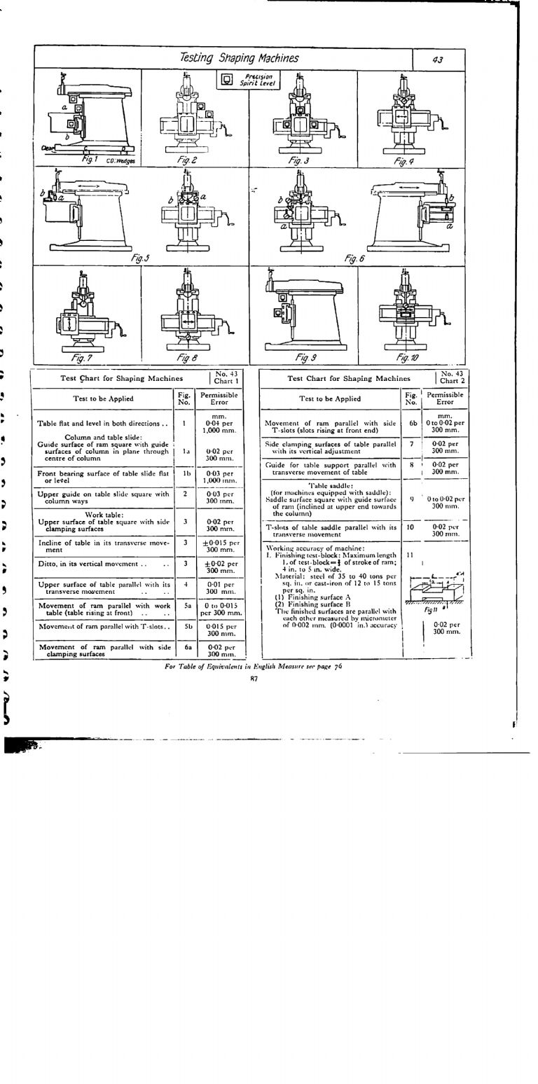

            Thanks Steve. I suspect lack of oil was the major culprit – the oil 'holes' were all well block with crud deep down.
            It is difficult to photograph the whole way length while simultaneously providing decent resolution of the grooves – not sure how to do that. I am not sure how to scrape this either – the right way has a section of about 250mm ( the rear part) that is partly shown in the bad images, and that scoring is deep, up to 0.4mm in places, so a lot of scraping!
            What also bothers me also are the oil distribution channels – there are three oil 'holes' per side, one forward, one rear and one about center of the ram slide length. The first photo in my post above shows a V shaped channel routed out in the base to take oil from the hole and spread it. This V channel is present in the rear and forward oil holes, both left and right slides, but NOT in the central oil hole – maybe that is why oil never got to the central part of the slide in the first place. However, the left slide is in very good condition, and also lacks this V channel…The damage is however done, but maybe I should route similar channels in the central hole area as well anyway.
            Thank you for the test info page – is this general, or did this apply to a specific shaper or manufacturer?

              I think it is perfectly acceptable to add additional oil channels. After all if the oil does not completely cover the bearing way you will get wear. Some of these old tools can be improved, afterall they were built to a compromise and the wear patterns you see when you strip tools down don't lie. I use a carbide burr and the dremel for adding oil channels. When I get round to it my Elliot 10M needs some modification as it needs lots of oil on the ram and its a real pain to stop the job to squirt oil in as often as it needs it.
              The test page is from George Schlesinger's book "testing machine tools". I've just sent you a private message.
