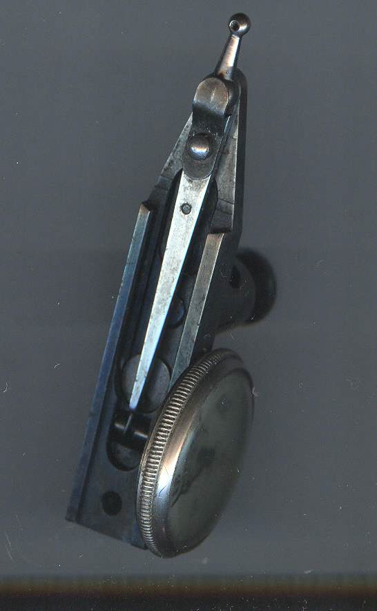

      I've been given an elderly Verdict DTI (lever arm type) which appears to have a fault. The needle fails to return to zero with no load and on opening it I'm unclear how it is supposed to. The hair spring engages with the internal arm, but it's not clear whether the small knob-ended lever does what it should do; it biases the needle one way or the other but there seems to be no other centring action to do this.
      I can take a picture but not sure if I can post it here.
      Any help would be welcome; seems a shame just to bin it.

                        Just for Martin's sake (and if we have diagnosed his problem correctly) I have put some pictures in an album of what the lever under the dial should look like. The washer is chamfered on the outside and creates friction with the lever to hold the lever in place. Have a go Martin. Don't sling it.
                        Dennis

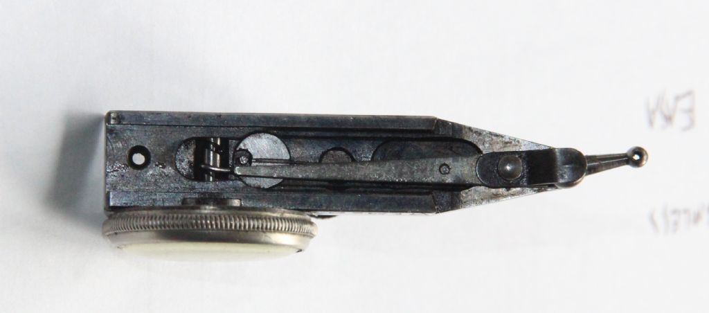

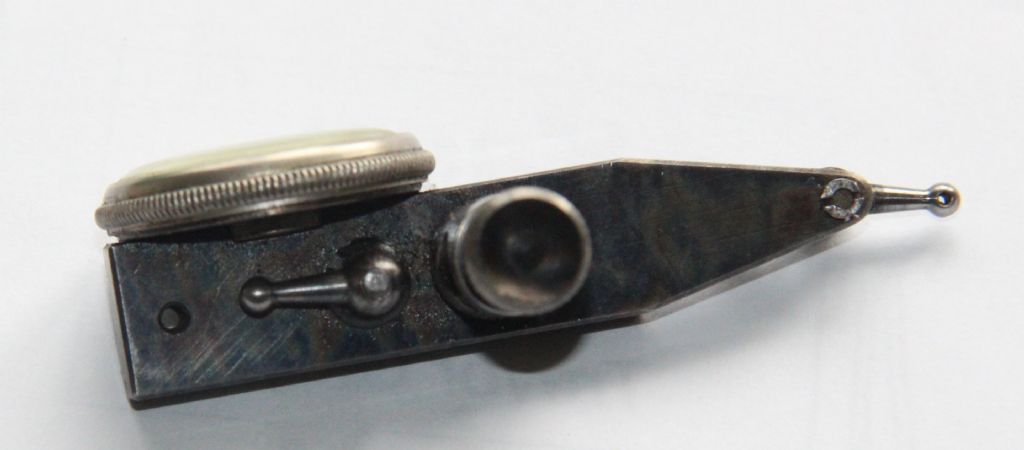

                                    verdict 1.jpgverdict 001_edited.jpgI thought I'd attached three photos to yesterday's post but nothing seems to have happened. Let's try again.verdsict 2.jpg

                                        To me, your verdict is not just elderly, it's very elderly/old and nothing like the pictures posted. Does it say Verdict on the dial or are you just referring to it as a Verdict type? Go back to my first post and consider that the dial pointer only travels just over one full turn. Move the lever under the dial to each extreme and you should find that the dial pointer reverses its action by one turn. The probe then works the dial in the other direction. It is not a centre-zero device. Rotate the dial's bezel to reset to read zero if required. If you do have a fault the spring wire (your "hair spring" description I think) on the inside end of the external lever looks bent in your top picture.

                                          Yes, it really is a Verdict (or so it says on the dial), but I suspect it's pretty elderly, as you suggest. I'll ponder some more. Maybe a trip to a Museum of Bygones…
                                          #352581
                                          DMR
                                            @dmr
                                            So it is a Verdict.
                                            Your "hair spring' in your top picture is bent such that it appears to be trying to move the main lever upwards but the lever has not moved upwards. Couple that with the external ball-end knob in your bottom picture being apparently centre biased then the spring should be quite straight and unseen under the main lever, unless things have changed between pictures.
