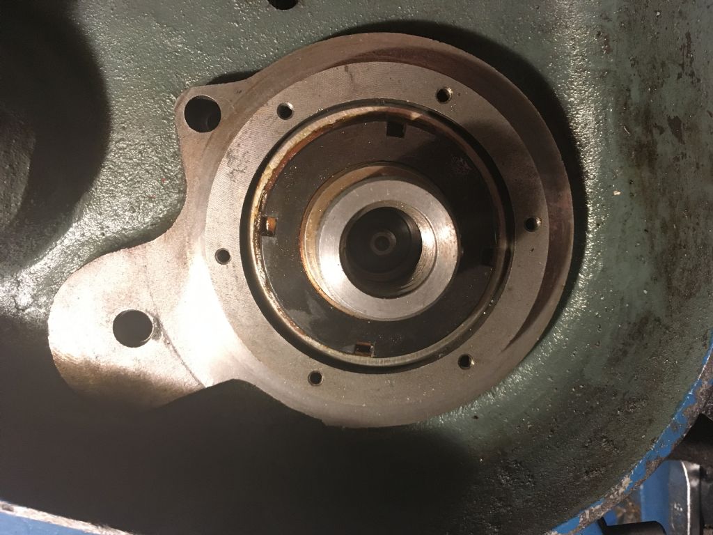

      I give up.
      I've tried getting this gear box off for something like two weeks now. I've taken every screw I can see out of it and it won't budge. The whole gear box is a layer cake with four parts. I've gotten the front end off, which holds the feed rod for the apron. What is left is the rear cover for the changewheels and the tumbler mechanism in a separate housing behind it. I've take pictures from inside the the rear foot of the bed and can see at least one threaded hole there which I assume holds a screw that I haven't undone. To get at it I need to get the change wheel cover off. I've removed everything fastener I can see except for the large flange nut pictured. It holds the large bearing for the leadscrew (this lathe has dual feeds). I find it strange because in the rest of the lathe the bearings will come out of their housings rather easily axially. Then again, this is a bearing that will see a fair amount of axial load being a lead screw bearing. So you'd want to keep it very closely aligned axially.
      The casting flexes a little bit when I apply pressure at the top and reveals the separation between the parts. It does not at the bottom. Almost all of the parts have been painted over so it's hard to tell if that's why the parts are stuck together of if there are som fasteners I've missed left in there. The only thing I can SEE though is this nut and I think it may be compressing the other parts.
      This became a long winded buildup to my question, just wanted you to know what I've tried so far and how the problem looks at the moment.
      How do I get this nut off? This is the largest of its kind on this lathe. I have a single pronged spanner that I've used on the others and the best way to use it has been to use it to lock the nut and then turn the screw. I can't get a grip on this without damaging I'm afraid. I've used one of the change wheels for leverage but then getting the spanner in behind it becomes a problem. Plus I need to hold the change wheel by hand as not to damage it. I've put some penetrating oil on it now and I'll revisit it in a day or two.
      I know this is an unusual lathe but if anyone has any specific advice on this lathe I'd love to hear it. Or if someone can point me to an authority on Habegger lathes. This is a Habegger DLZTE.
      I'll also take any advice I can get in regards to removing nuts such as these.

                Good question … But I think the answer is reasonably evident from Karl's first photo.

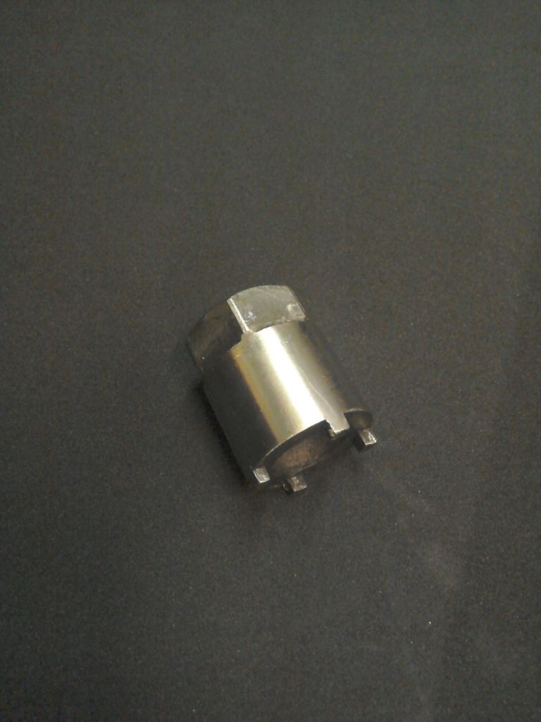

                      For my M/Cycle clutch basket that had the same nut and was both tight and recessed, I modified the end of a socket to fit the slots and used an air impact wrench to undo.

                        Whats worked for me with similar ultra stubborn nuts is to make a shallow, T handled, tube spanner with lugs for all the slots so that a balanced couple can be applied. I also used a big washer like spacer on the shaft to limit any attempt by the spanner to tilt. Obviously needs a little bit of clearance so the nut can unscrew. 50 thou / 1 mm should do. Usually by the time its come that far it will unscrew fairly easily. If it is still so tight that the spanner wants to tilt just add some smaller washers under the spacer so it can go another turn. Alternatively you could make the spanner bore a running fit on the shaft so it can't tilt but this will still let the spanner move endwise.
                        I think the single hook C spanner fails with really tight nuts of this form because the heel of the spanner pushes hard down in one place distorting the nut so the harder you push the more it distorts so the more it locks up. Obviously if its not super tight distortion will be negligible or non existent. The two handled, balanced couple spanner engaging all the slots simply tries to turn the nut with no attempt at distortion with its potential locking issues.
                        Of course as its my idea I'm gonna say its wonderful aren't I.
                        Allegedly butchering a big long reach socket by cutting lugs to match the slots on the end and applying an impact wrench works well. Not something I've done myself but many years ago I did see a properly made device of this type hanging on the special tools wall board at a vehicle main dealer. Possibly BMW car / motorcycle place.

                            Here is one I made for a similar nut. Don't know what size your nut is but this tool will not damage the nut and is less likely to slip than a hook wrench. This is what the earlier posts were refering to as modified sockets which is one way of making this tool.

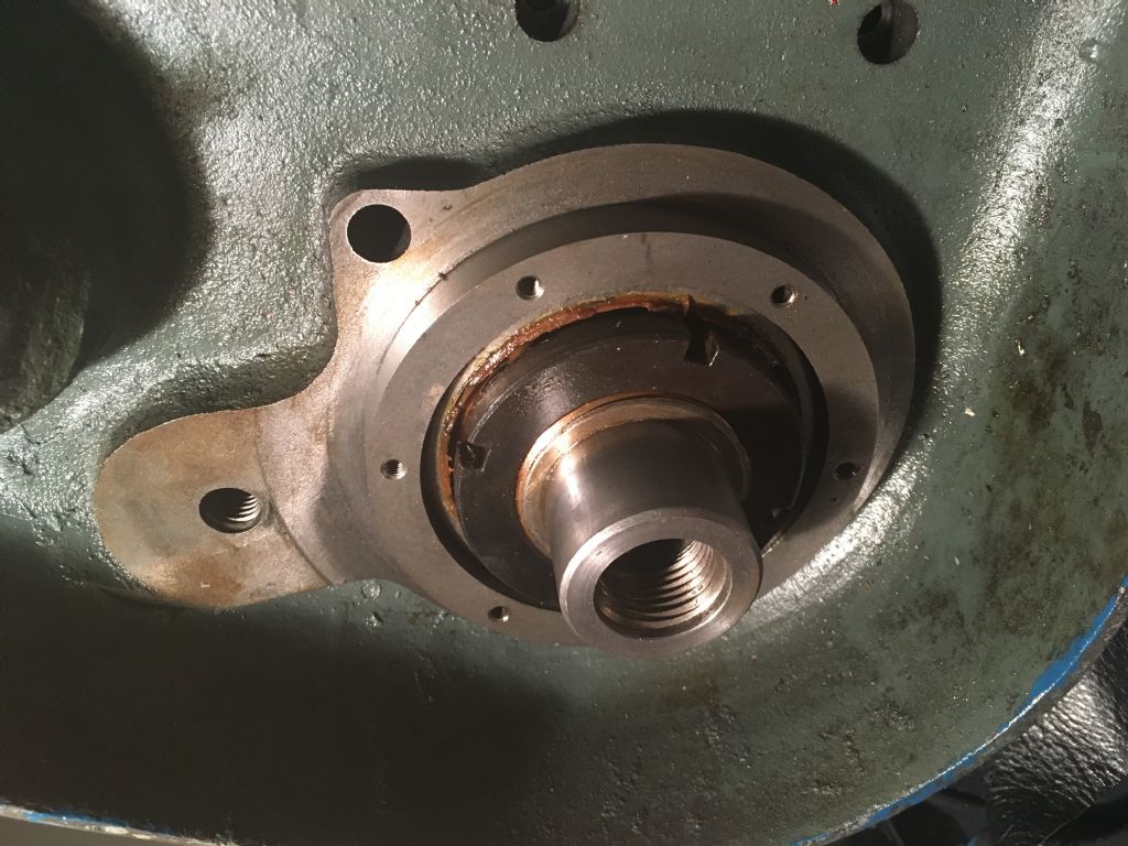

                                  I did get the nut loos last night! I got myself a larger c-spanner and grabbed the shaft with a pipe wrench with some aluminium in between as protection.

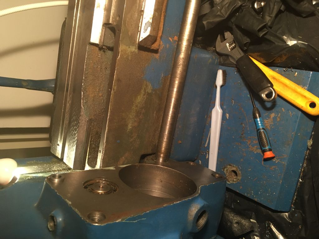

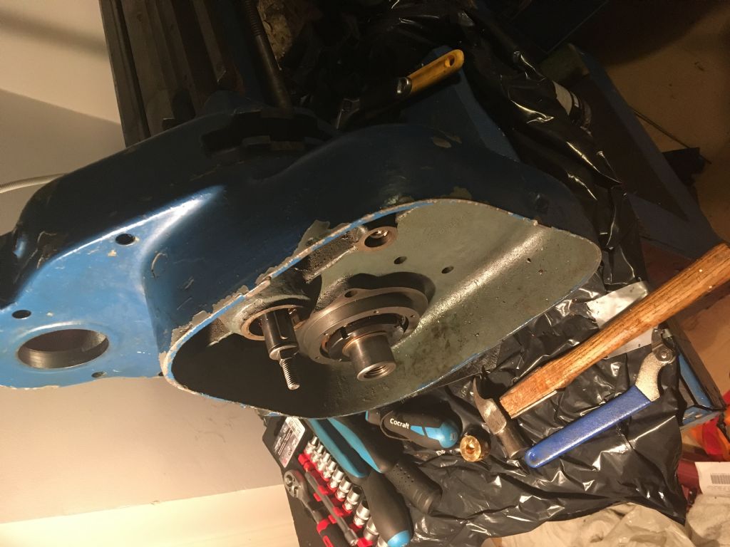

                                  The bad news is that it made no difference whatsoever. I got the leadscrew out but the sections of the gearbox still won't budge. I removed a C-clip from a shaft that I then tried tapping out. I soon realized that it was probably designed to be removed once the cover for the change wheels was taken off and had an integral gear on it. So I stopped and tried tapping it back the other way but I must have moved someting on the shaft because now it won't seat fully. So now I HAVE to get the thing apart.
                                  Suggestions? I'm afraid I'll break a casting if I try prying more. I've tried tapping a knife edge into the seams between parts but so far nothing has given way. I'll inspect it again today with fresh eyes but I've already gone over it something like 20 times and still can't find any screws holding it together.

                                    I have a nagging suspicion that you will find that the parts are dowelled together … if so, you are right to stop trying to pry them apart.
                                    A bit of 'hands-off' research would seem a good idea at this stage.
                                    #400670
                                    Mike Poole
                                      @mikepoole82104
                                      Don’t be surprised by a very long bolt coming in to the rear or the casting, check unexpected places like under the bed of the lathe and any other places that could be hiding a long bolt.

                                          I got the parts apart! The last two screws were hidden behind the large bearing for the lead screw. Very complicated disassembly, this… I got the gear box off of the shaft but now I can't get the tumbler out of there.
                                          As I mentioned earlier the shaft for the central tumbler wheel had a C-clip on it, indicating that the shaft is supposed to be a sliding fit through the bearing. I tried tapping it out earlier but it went a mm or so before sticking. So I thought I'd try to get the bearing out of the housing instead as most other bearings have been a slip fit into the castings on this machine. Got it a cm out or so but the the sound from my brass drift became very solid. I think I may have wedged a piece of dirt between the journal and the bearing. I've tried re-seating the bearing on the shaft and I've used a plastic bushing to take the strain off of the bearing while attempting to tap it home. I'm going to make a better bushing out of brass or copper as I suspect the shock isn't transferred properly. I don't have a press so I'll have to use my trusty old hammer and a brass drift.
