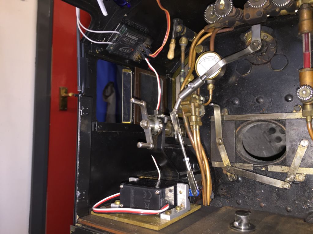

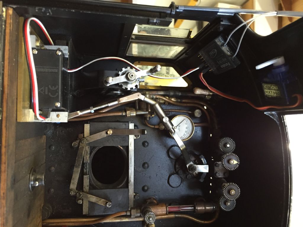

                      Do you have any pictures of how you mount all the servo’s?
                      #231465
                      Barrie Purslow
                        @barriepurslow11592
                        Hi Dave,
                        I am about to try and post a couple of pictures. The regulator servo is a standard Futaba servo (S3001) and the whistle valve servo is a blue one that cost two quid. Right, here we go…………

                                img_0679.jpgimg_0676.jpgThanks to Duncan Webster and a few hours in a dark room I believe I am about to post a couple of photos of the servo installation in my Black Five. One small step for BP……….
