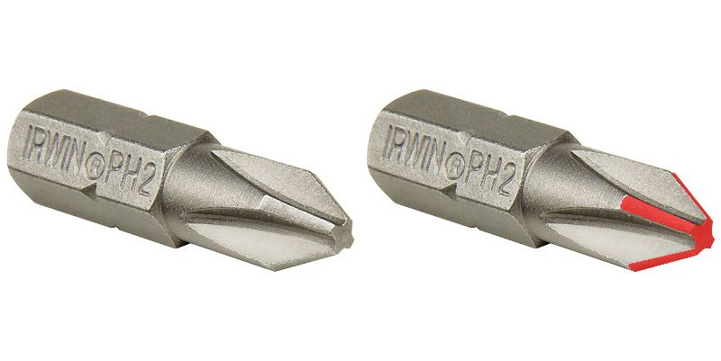

                      bugbear6502
                        @bugbear6502
                        I'm not planning on grinding a "new shape". That would be "quite difficult".
                        I just want to grind-back the prexisting cruciform shape the sharpen up the burred leading edges.
                        As per the red (lipstick?!) on the right picture.

                                  Bugbear, you can't just regrind those red edges. If you look at the image you posted the thickness of the 4 "lobes" gets thicker dute to them being hollow ground hence the curved surface.
                                  Pozi will be even harder as there is the extra bit of metal between the 4 main lobes

                                  bugbear6502
                                    @bugbear6502
                                    I certainly can't grind them "much".
                                    And I can grind Pozi even less.
                                    But a little may be enough.
                                    BugBear
                                    Edited By bugbear6502 on 30/06/2016 12:03:19
                                    #244782
                                      But then they are shorter and don't fit as far into the screw for a given size bit and you end up risking chewing up the screw.

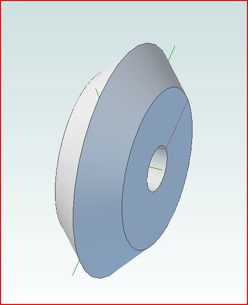

                                          I think it would need a larhe dia grinding wheel like this to go between each lobe first and then grind the red areas toi get it back to original size.
