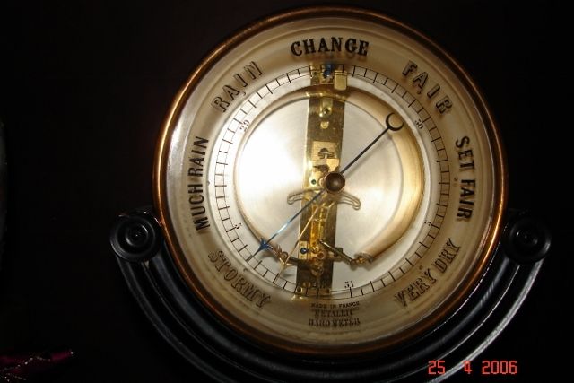

                                      #322275
                                      Ian S C
                                        @iansc
                                        Your Barometer case looks similar to mine, I'v decided to leave it as is.
                                        Ian S C

                                        #322318
                                        Samsaranda
                                          @samsaranda
                                          Hi Ian, yes appears similar but the face on yours is much more readable than mine, the silvering on the face of mine is very tarnished and will need some restoration to render it legible. I am still of the opinion that the brass outer case does ned to be stripped and repolished then re-lacquered, it all depends how easily the old lacquer is to remove.
