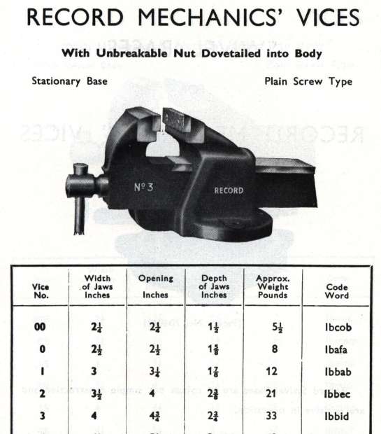

          Just checked my spare one;
          Overall height 6¾”
          Vertical clearance inside jaws 2¾”
          image_2025-11-25_202356863
          Screenshot from Record Catalogue No.16
          If you’re anywhere near Buxton Derbyshire, it’s not perfect, but going spare.
          Bill

            Thank you for this, Bill. It is just what I wanted to know.
