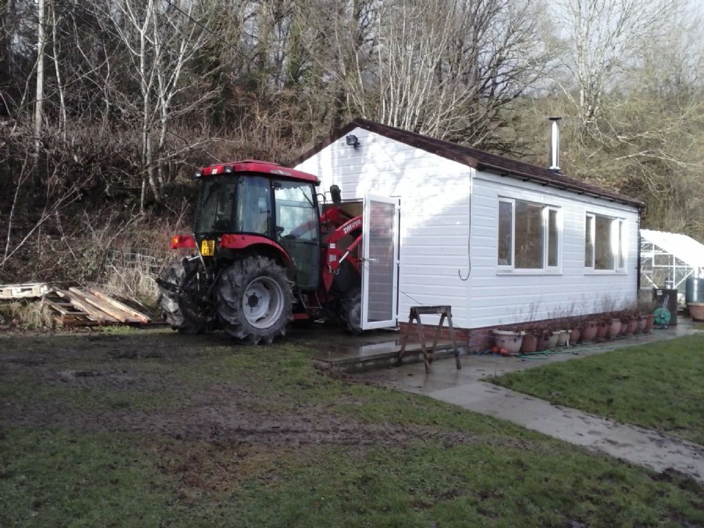

              #372078
              pgk pgk
                @pgkpgk17461
                my upvc shed

                                  #372117
                                    Posted by pgk pgk on 17/09/2018 12:49:17:
                                    my upvc shed
                                    Try all you like, but I'm afraid that tractor just isn't going to fit through the door
