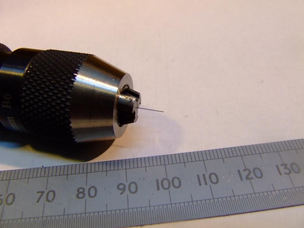

                                I purchased my ER11 collet chuck and collets from CTC. They are based in China but I believe they have European warehousing. The quality was fine for my needs.
                                **LINK**
                                I also have a small, 0.2-3mm, drill chuck from RC in Luxembourg which I have used down to 0.2mm.
                                Best regards
                                Roger
