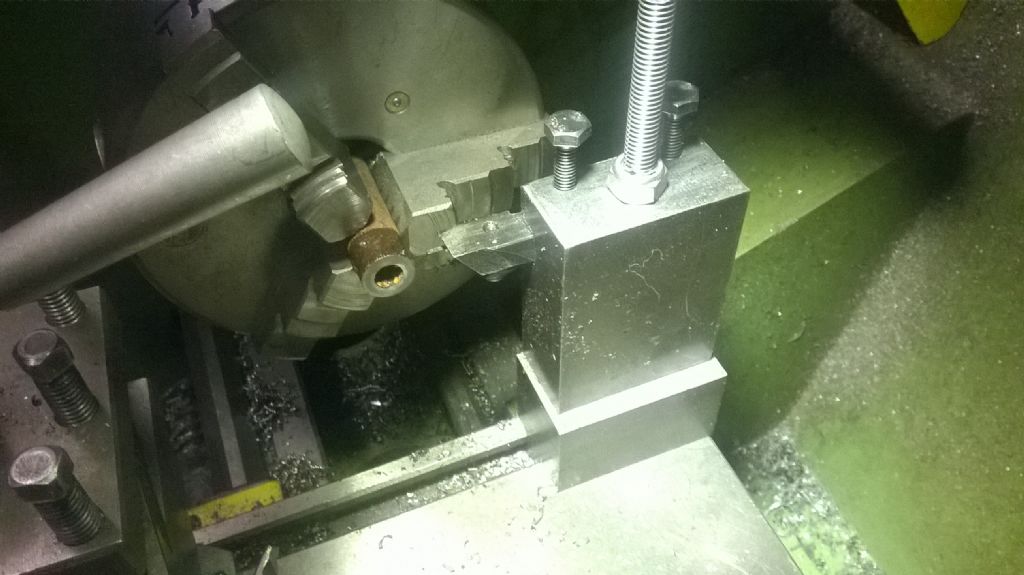

                              wp_20171230_003[1].jpgSorry to resurrect this post . Finally made the prototype rear tool post for my lathe. Warco wm240. To make life easier there is no top rake to the tool, just clean up front face on grinder and the tool holder/ tool post is set for centre height so no adjustment. Works suspiciously well. It has transformed the parting operation so a worthwhile addition. Cost very little to make 1 1/4 sq and 2 1/4 x 1 inch, homemade T nut bit of studding and two bolts. Finished one will be painted yellow for visibility and to avoid parting off the chuck.
                              Gordon
