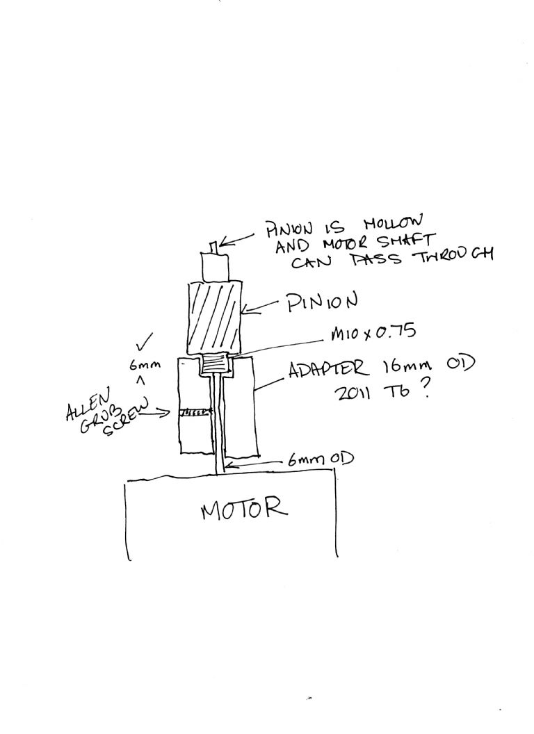

      I have a motor with a 6mm shaft, and a pinion with a 5.7-5.8mm hole.
      I would prefer not to remove the shaft from the motor and turn it down as this invalidates the warranty, and it’s quite expensive, only 50mm long and 3.6KW!
      1. How do I go about enlarging a 5.75mm hole to fit a 6mm shaft? What would be the best way?
      2. This will reduce the wall thickness at one end to approximately .6mm, the overall diameter of this threaded end is 9mm, and will be screwed into a 16mm diameter aluminium adaptor which will also be fixed to the shaft with a grub screw.

          I assume you get your 0.6mm wall thickness by subtracting 6.0mm from the lowest part of the helical gear, this being 7.2mm. Surely as the helical gear has been cut along the whole length of the part the wall will also be reduced to 0.6mm along the whole length not just part of it. I don’t think reducing teh wall thickness by 0.1mm will make a great deal of difference to teh strength of the part.
          My thoughts would be to hold the gear in an ER collet or failing that make a split bush to hold it so it can be reamed in the lathe.
          J

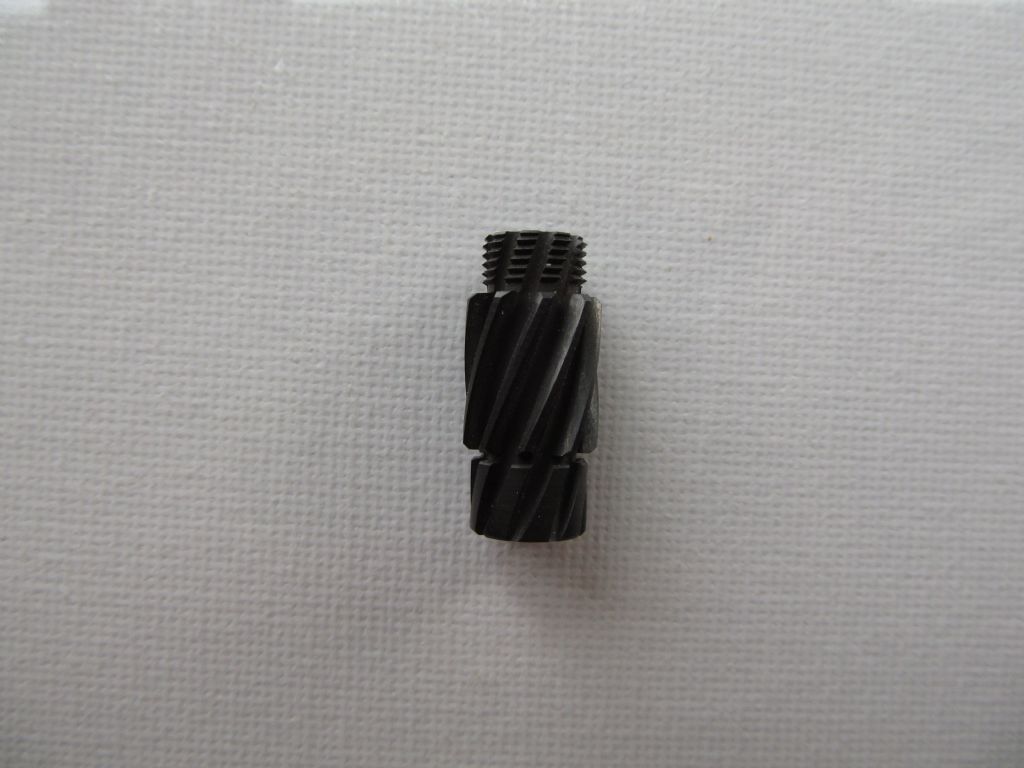

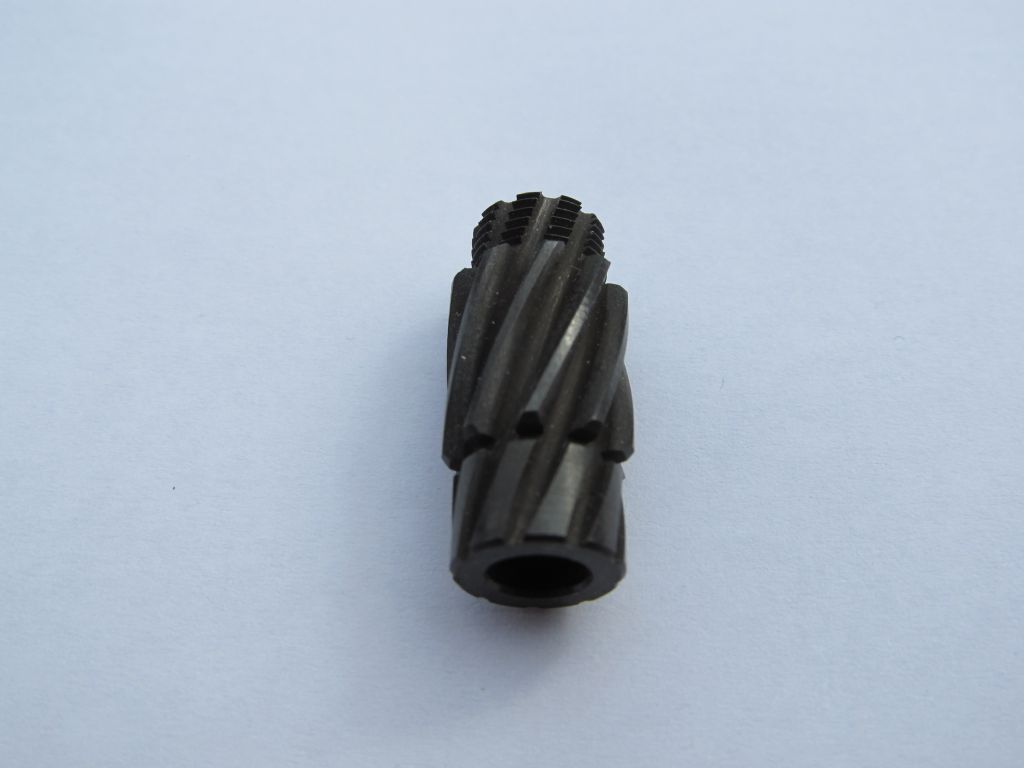

            As you can see the pinion gear is stepped, at its widest, the centre section, it is over 11mm. The wall thickness will only be reduced to 0.6mm at its narrowest end, where it is threaded, and only where the grooves of the helix cut through the threads.
            What sort of a reamer do I need? When I look through the catalogues there seem to be so many?
            #74281
              It may be stepped on the OD but the root of the gears runs along the whole length, so there will be spirals running along the whole part with a thickness of 0.6mm.
              A 6.0mm hand reamer will do, you may want to open it out a fraction more with a drill. Before you try reaming is the gear hardened by any chance, the black colour could indicate it has been heat treated, this will likely blunt your reamer.

                It probably is hardened, although it is designed to turn what is probably a Delrin main gear.
                The root of the gears taper off at the wider end so the wall at one end is quite a lot thicker. The motor shaft measures exactly 6mm, do I ream to 6mm or slightly wider, 6.1mm?
                Are there reamers which will better handle hardened steel?

                  Clamp the motor, start it up and polish the 0.2 to 0.3mm off with some emery cloth.
                  By the sounds of the motor , 50mm long 3.6 Kw it will take it off in seconds.

                              I wasn’t joking when i said run the motor under power and polish the shaft to fit the pinion.
                              Go carefully though as it’s very easy to take more than 0.02mm off.
