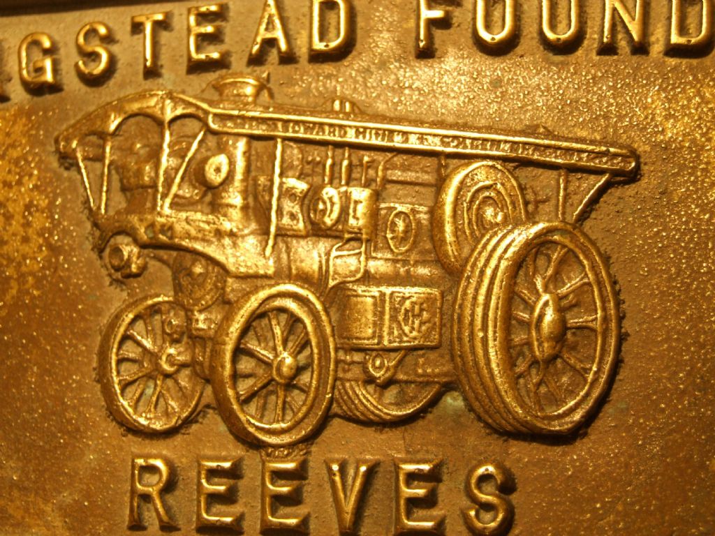

                                      Casting that in high definition is easy ! Gun metal or brass ? Serifed letters in a size of your choice from 1/2" to a 4" in plain. Flat background or raised border ? Noel.

                                          noel shelley
                                            @noelshelley55608
                                            pictures8 099.jpgpictures8 098.jpgA woven background as in old AA badges is copied – every thread ! A showmans loco 3"long in relief, even the lettering round the canopy can be read – if your eyes are good enough. Using mansfield sand you will loose almost nothing BUT it will look cast. Check out any shot of the Fred Dibnahs MADE IN BRITAIN . Look closely and you will see 2 tiny dot marks for drilling, cast in ! Foundry lettering has a good draft as part of it's design. There are 3 standard fonts, flat face serif, 1/2" up, Flat face 1/4" to 4" and sharp face 1/8" up. The bevel gear illustrates the detail that can be achieved ! The 2nd image show the edges rounded due to polishing. Noel
                                            PS this is over 20 years old and was done for OLD reeves ! N

                                                There is certainly some loss of crispness in the castings Noel shows, crumbling edges of the sand are often the cause just look around the back half of the rear wheel or where the sand broke away between the front wheel and the "E" of Reeves. It would really depend on what your client will accept

                                                  The reason I used the reeves casting was to illustrate the detail it is possible to get. The pattern was far from perfect and the reason I still have this is it was the reject and no rectification work was done on it . If this casting was viewed from 3' away rather than 3" then the imperfections would hardly be visible and set in a pavement not noticed at all. Obviously it depends on what the customer wants or will accept – A modern CNC made item or a traditional casting ? I like Jasons mention of roughing up to make a CNC job look like a casting ! Noel

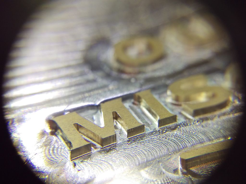

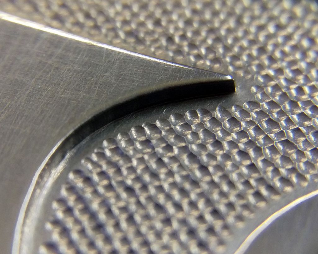

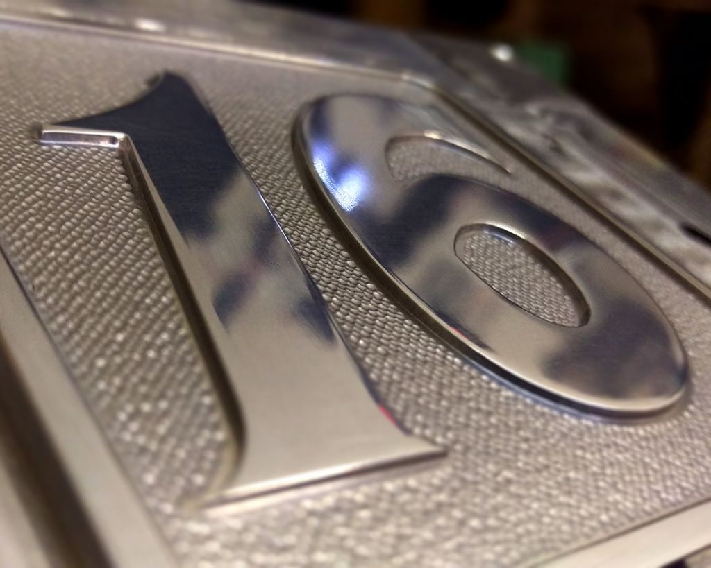

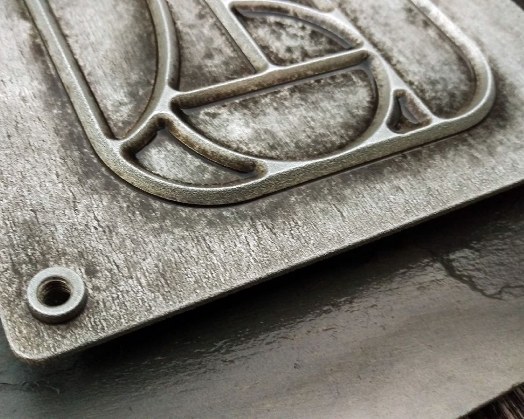

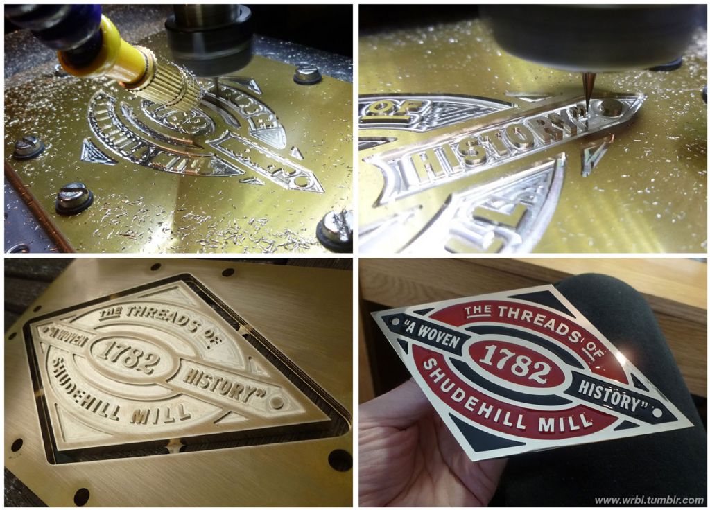

                                                  Wal Werbel
                                                    @walwerbel59154
                                                    Hello all,
                                                    Some good information here. Thanks for posting those images Noel – very helpful.
                                                    I did some tests a while back for a company who were after a bit of custom signage. That was CNC'd but I added a bit of patina to get a cast look (electrolysis and then acid) – it was in aluminium (pic below) – I get the impression that my customer's after crisp lettering for this job – perhaps I go with CNC-ing the brass and adding patina to the floor where the texture sits?
