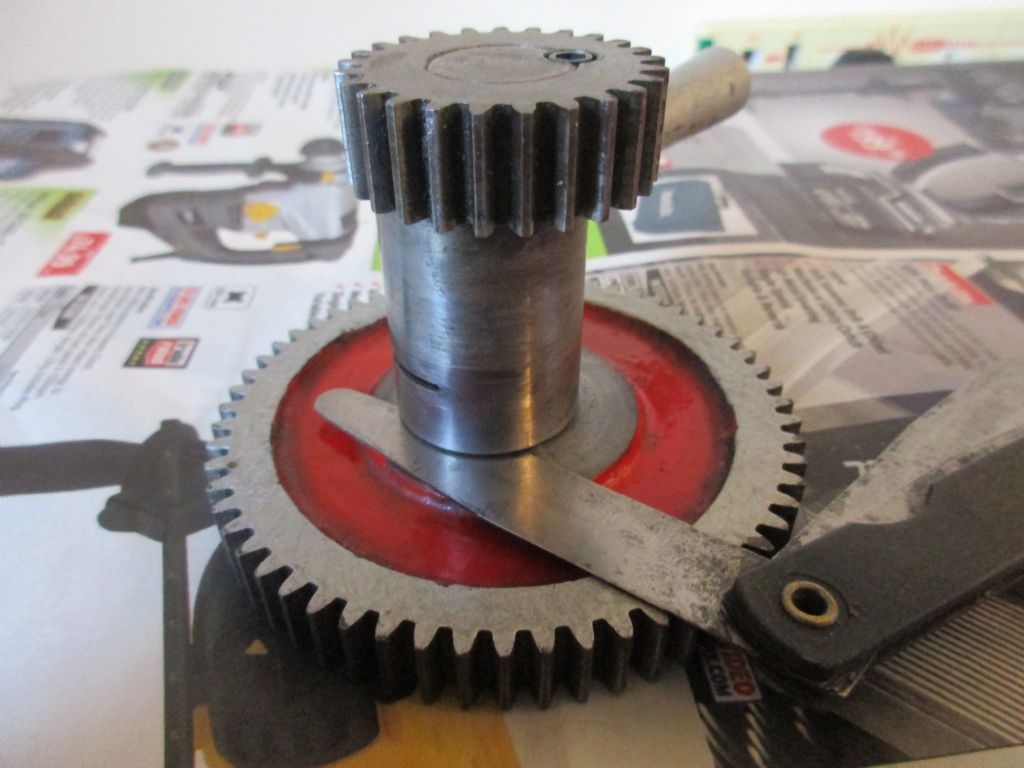

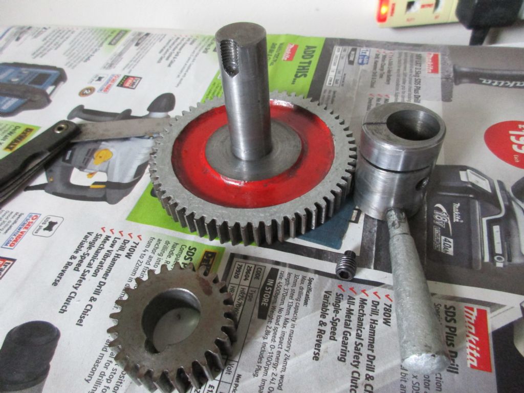

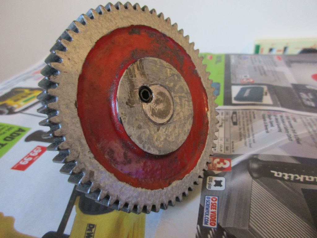

      Hi Mario, this is the backgear off my father's RandA, it shows there is 0.016" of end float when assembled. The length of the shaft is 2.263" long and the wheels are flush with the ends, the thread of the grub screws are 1 / 4" BSF. If you have found the shaft, it will save you a lot of work.
      Myford change wheels are the same but as Howard has pointed out, you will have to drill a hole for the drive pin and a piece of silver steel of the correct diameter will be fine for the pin. The 60T wheel on the backgear is a slightly larger diameter than the change wheels, as pointed out earlier in this thread. The 60T backgear wheel on my father's is a press fit on the shaft and if you have to mount yours before fitting it, you will need to remove the main spindle and cone pulley to get it in. You have the New Type A RandA lathe, they are fairly good lathes for their time, but you must make sure the spindle is always oiled in the bearings when in use. I haven't used my father's one for many years now though.

        Thanks again for your efforts I failed to realise the 60t back gear was a press fit it just seemed a little tight, at first I wondered if it had a small dink/burr so went round the edges of the gear with a fine file, in the end I relieved a small amount of material with a fine file from inside the gear and ran the spindle in the lathe with some light emery, it's still a tight fit but now it's possible with a little effort to remove/fit the gear on the shaft by hand.
        Interestingly I note your back gear spindle has different diameters i.e. smaller where the back gear fits on and larger where it must sit in the bearing of the machine, whereas mine is the same diameter along its length

          Hi Mario, my backgear shaft is the same diameter all along its length, in the photo it is shown with the swivelling bush in place and the feeler gauges showing the 0.012" end float that the backgear has.

            I didn't realise the back gear spindle had the bush in place in your first photo, so that makes sense now, my back gear assembly has very slight play not sure if it's meant to be like it, or whether the shaft and/or bush is worn? Or is there away of tensioning the bush like one would do with the main spindle?

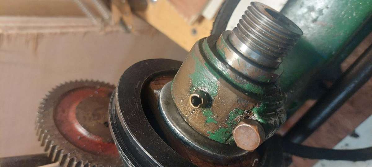

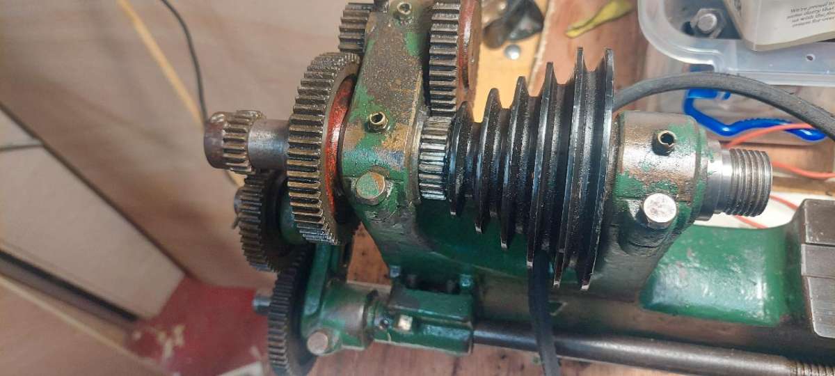

                    I’ve bought a small vintage metal lathe.
                    I have used small wood lathes for some time so have some experience with rotating machinery, some usable centres and chucks for the 1MT tapers in my new lathe and some test gear such as a DTI, but I’ve no previous experience with metal lathes beyond reading about them.
                    headstockThere obviously was something missing on the headstock and looking on the lathes.co.uk website I eventually discovered that I’ve got a RandA type B or lookalike and that a missing cog adjacent to the pulley is part of the backgear system. The closest example I could find on lathes.co.uk is the BSW RB 3x 20” with a double clasp nut. The terms Randa and backgear led me to this thread.
                    The pulley is obviously a modern replacement, V belt instead of flat and the pulley grub screw needs a metric 4mm allen key. Apart from that the lathe seems in good shape, bearings seem silky smooth, no damage to the leadscrew or cross slide and all the parts for a change gear train which seemed to be set up for a 24tpi cut with the 8tpi leadscrew.
                    The top slide and toolpost were clearly hacked in the past, the original toolpost mounting hole has the threads stripped and a length of threaded 3/8 UNC rod substituted in a new hole. The mix of fasteners did confuse me for a bit, mostly BSF, a metric grub screw but then a UNC thread as well.
                    The change gears have a pin connection between the collar and the cog. The gears themselves are a 5/8” bore, I found comment online that Myford 20DP 14.5 gears would probably fit so I’ve been able to buy a few Myford ML7 gears and make them fit fit with the addition of a 7/64” pin hole.
                    To repair the back gear I needed to either attach a 25 tooth cog to the rear of the pulley to match the existing 60T-25T-60T backgear train or else replace the three existing gears and get two matching pairs.
                    Lathes.co.uk had mentioned that early ML1-4 lathes used the same pin system and that the TPI indicator as part of the carriage shift on the RandA leadscrew was also the mechanism on the ML10.
                    Looking at spares for the ML10 on the Myford site I found a 25T spindle cog. It didn’t give any dimensions so I was unsure if it would fit but I thought it worth a punt.
                    Unfortunately it isn’t a direct fit, 7/8” ID instead of the 1” RandA spindle.
                    Since I’d bought it I decided to open it up to 1”. I drilled it out with progressively sized drills to 25mm (my biggest drill) and then got it to a sliding fit on the RandA spindle using abrasives on a mandrel. I was careful to clean it thoroughly each time before a test fit since abrasive particles on the spindle would be a real problem.
                    The resulting cog fitted the spindle and meshed ok with the large outer 60T gear and the collar on the ML10 cog provided clearance between the 60T gear and the end of the pulley. I did see some comment that the RandA backgears were not the same DP and pressure angle as normal Myford change gears, maybe the ML10 spindle cog is different from the change gears.
                    However the remaining rim on the 25T cog was very thin after taking the centre from 7/8” out to 1” and I couldn’t see how I would attach it to the end of the pulley.

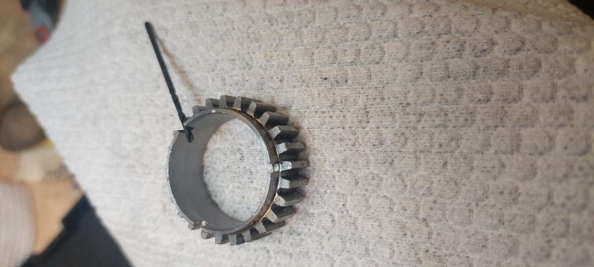

                    thinned ML10 spindle cog
                    My solution was to remove the collar at points round the rim directly at the teeth. A 1.5mm drill into the cog at these points to hold a pin which would go into matching holes on the pulley rim. Aligning with the teeth allowed me a larger space to drill without any danger of fouling the 60T gear.
                    Some metal epoxy then held the pins in place as I assembled cog and pulley together on a piece of 1” pipe as an alignment mandrel.

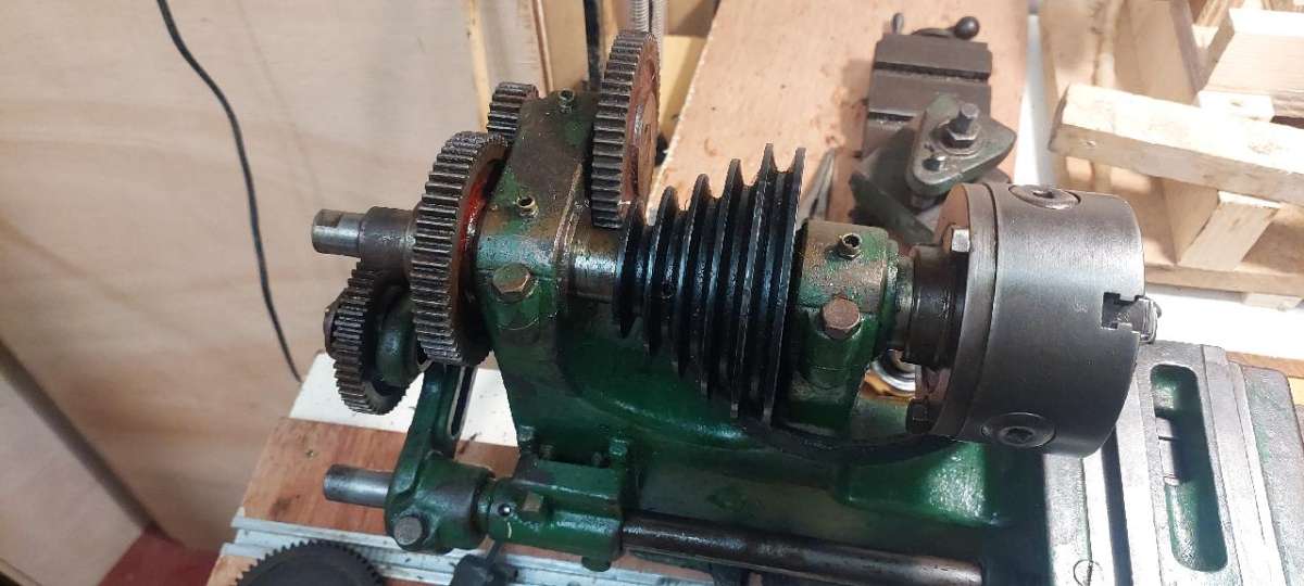

                    pinned to end of pulley

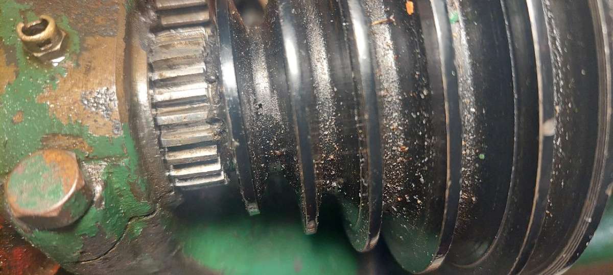

                    The design of the modern V belt pulley is such that there was no solid end towards the front of the headstock. Without the grub screw the pulley could move towards the headstock so I needed a spacer to keep it in position when the grub screw is removed.
                    spacer
                    reassembled gears
                    Clearly a more accurate way to do it would have been to use a boring bar on a lathe to enlarge the 25T gear, that’s far above my current skill level, my use of a drill press is a pretty clumsy hack but it got me a working backgear.
                    Regards Jim

                      Your photo is a nice addition for education about RandA idiosyncrasies. Note the 60 on the spindle is thicker than the change wheels and the one on the back gear layshaft. This implies that the previous owner used a Myford change wheel in the back gear. Dimensions given either in this thread or an earlier one show the backgears are about 1.5% bigger than the changewheels, though they probably used a standard 20DP cutter.
                      When looking for someone at 3D printing one I calculated that a 61 tooth enlarged by 1% would be the best fit, though I never did make one.
