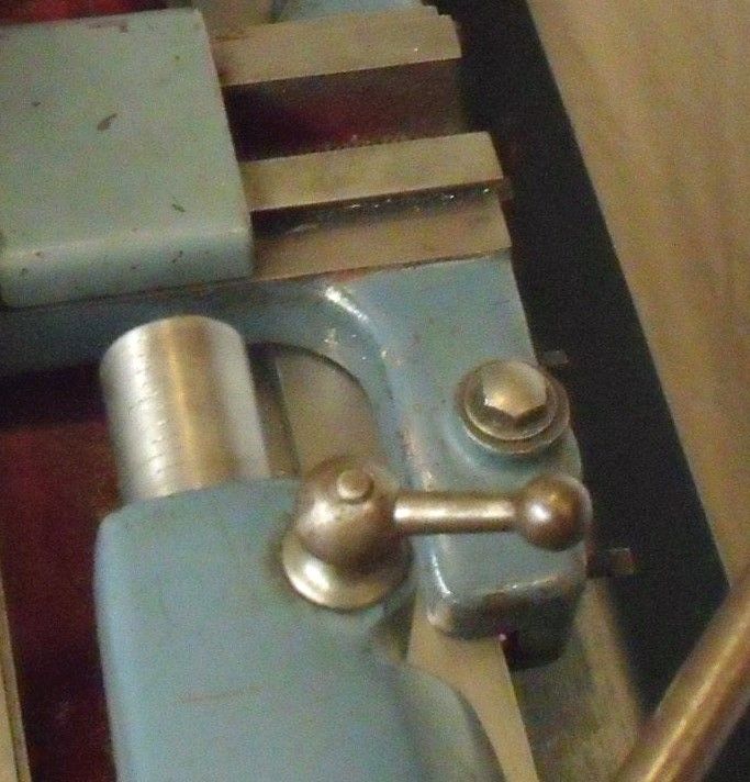

      Greetings everyone, …. Hi I'm new to the forum, …. " novice requires help please" …., recently brought a Raglan Loughborough lathe [evil bay] It has a screw thread,front of the bed, … BUT there doesn't appear to be anyway to "lock" the carriage in position whilst turning anything ….. i have to hold the adjusting wheel in a static position, ….. Obviously this is not practical or accurate, Am i missing something obvious ??? … Thanks in advance for help. Mike.

          The photos on the "lathes,co.uk" site show what appears to be a locking screw at the rear, right-hand corner of the carriage. Is your's missing?

              The "Loughborough" is a solidly built training lathe. It is a plan lathe and so not a screwcutting lathe.

                The carriage locking bolt would be the hex head bolt on the top of the rear right-hand "wing" on the carriage, seen inbelow pic just above the tailtstock barrel locking ball-lever.

                  As Mark says, the Loughborough is purely a very basic Training Lathe, and has no facilities for powered feeds or screwcutting.
                  Having said that, it is a good solid machine, and if unworn and not abused is capable of good work, in the right hands.
