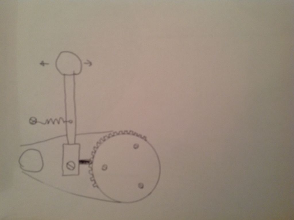

      Hi everyone – trouble again!
      I have a Warco Vario VMC mill with an R8 spindle.
      Several times I have had to really tighten the ER32 collet chuck to hold a mill.
      How do I hold the chuck body to unscrew the cap?
      There is no spindle lock on this mill and I would like to know if anyone else has this problem and how they solved it.
      Has anyone made a spindle lock for this mill?
      Many thanks for any help.

                                    #336367

                                        Now the text. The tooth disc is attached to the top surface of the spindle drive pulley. The detent is sized to fit the teeth and in practise much shorter than drawn. The pivot is attached to the pulley cover as is the spring attachment point. The actuating arm projects through a horizontal slot milled in the side of the pulley cover. The spring retracts the detent so it self releases. You would have to play around with the pivot etc. until you find a solution where the detent locks and retracts smoothly. I built a similar system for my SX3 that locks on the toothed drive pulley it works a treat and was designed by an Aussie on the forum. I would use steel for the indexing disc.
