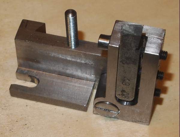

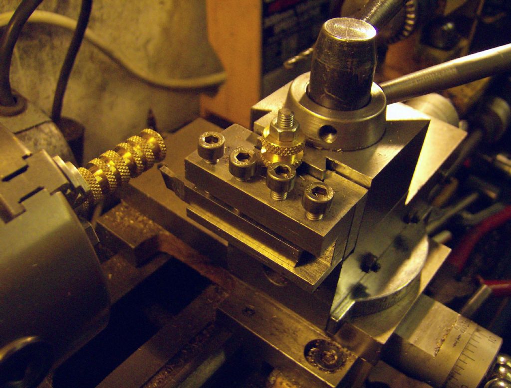

      Better picture with first toolholder. Strange colour cast though…
      Yes, it is making a stick of height adjustment nuts!
      Mighty chuffed with the knurling – 5" of perfect knurl with my home made scissor knurler – my first proper home-made tool.
      #98260
      Peter E
        @petere
        That tool holder is looking really good Neil, nicely executed!

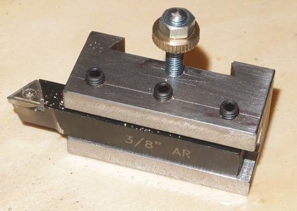

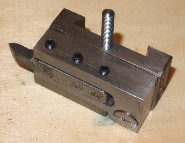

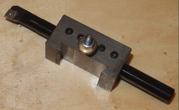

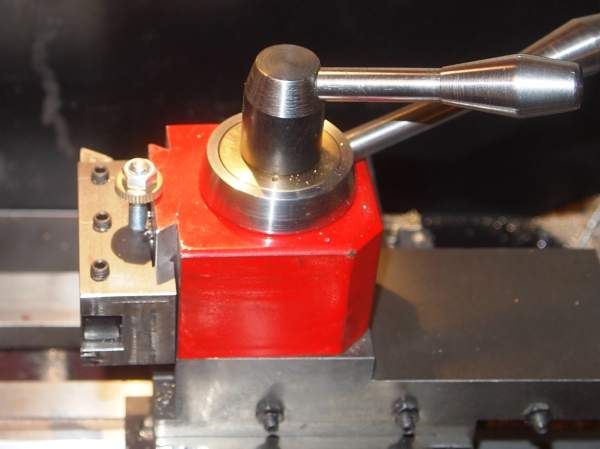

            Thanks to this thread I restarted the making of the holders and now I have these:
            Ordinary Tool holder
            Boring Bar Holder
            Threading tool holder Mike Cox style (but I have to invent a solution to the height setting as the current disc will foul the moving part of the holder.)
            … and with the tool bit raised
            … And they all fit perfectly and is firmly held in place on the post
