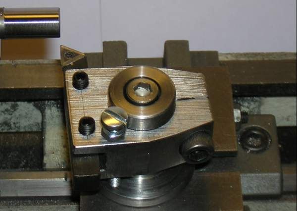

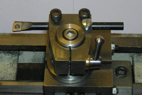

      OK, so repeating the post from the previous page but now with usable images/links.
      ===== Repeat ====
      Adding Model Engineers Workshop no 140 to the list of info and drawings for a QCTP of the sought after style. Jim W made one for a mini lathe-ish size as well as for a Unimat sized machine. Good descriptions and drawings. I used those as base for my work.
      I have understood it so that it is important to be quite accurate when doing the dove tailing to get the desired precision and repeatability while at the same time get the easy fit required for easy use.
      For my Unimat clone I made a slimmed down version of the Norman Patent type as can be seen in the following two pictures. They also work very well, and I am very pleased with their perfomance. The only draw-back I think is that the setting screw poking out below makes it a little cumbersome to efficiently store many toolholders.
      The holder for ordinary tool bits, and ….
      …. the boring tool holder.

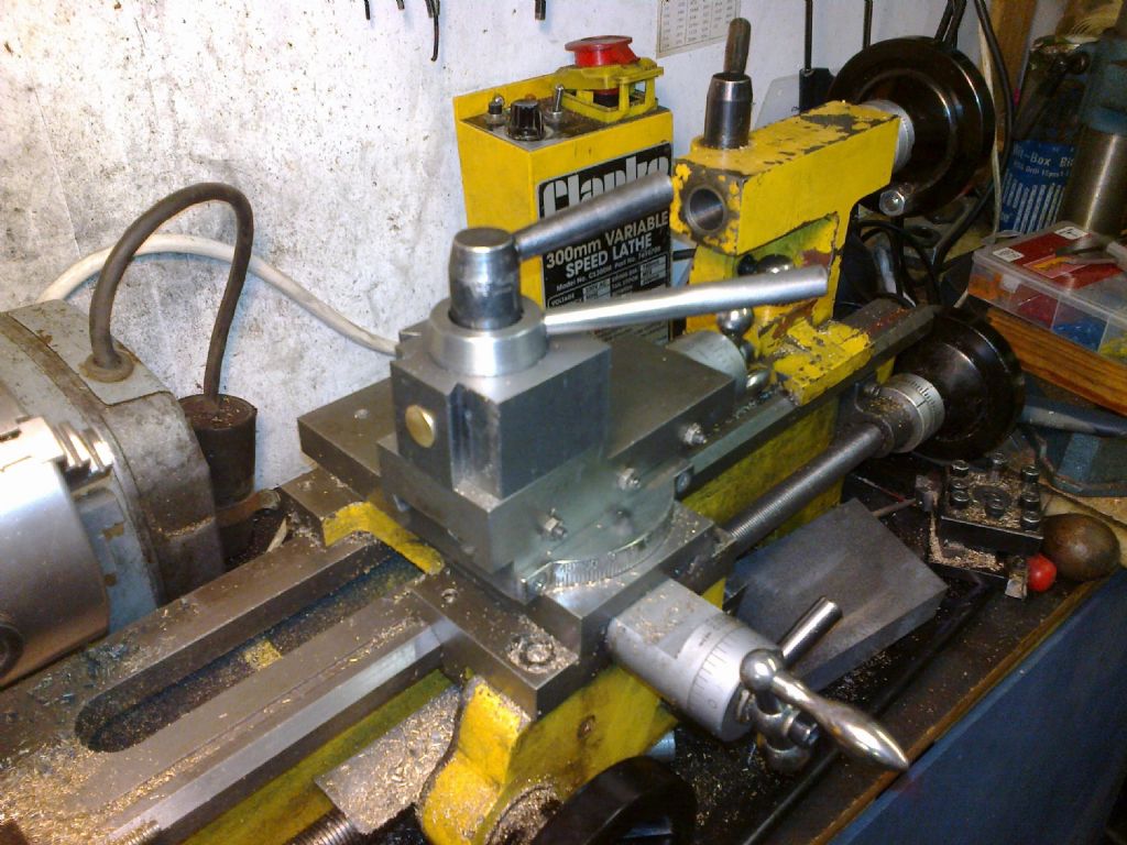

                                        I decided to go for the nakamura design in the end, but with some adaptations.
                                        Two sets of dovetails and pistons at 90 degrees – so you can switch between facing/turning/boring without losing a setting.
                                        The block is only 2" sqaure to match the square on the mini-lathe top slide. This means the dovestails over lap the top slide, but as you never need to set a tool lower than centre height, this doesn't matter as long as you don't use tools bigger than 5/16".
                                        My pistons are flat ended- to give a line of contact, rather than using rounded ends.
                                        i counterbored the piston holes and used small flanged on the inside of the pistons so they don't fall out – this was not needed as:
                                        I machined a groove inside the central hole level with the middle of the pistons. I drilled the end of each piston No.58 and put a thin spring wire through each one, this locates in the groove and withdraws the pistons without interfering with the cam. I had to filed two bevels on the bottom of the cam so it pushes the cams out of the way.
                                        I fitted a handle that is a longer copy of the standard mini-lathe handles (and the ones fitted to me leadscrew clutch and tailstock lock).
                                        I can't actually test it yet, as I haven't dovetailed any toolholders yet. With about 1.25mm of piston movement I will have to be very careful to get these just right.
                                        I hope it all works, as assembly was a one-way process once the pistons clicked into the cam! To dis-assemble I will need some way to pull the cams outwards -perhaps I should have given them a central 8BA hole?

                                          Stub
                                          Pictures are required smiley
                                          #98062
                                          Sub Mandrel
                                            @submandrel
                                            Hi Chris,
                                            My digital camera plays up if the batteries aren't freshly charged
                                            This is the best I can do with my phone:

                                              Hi Niel,
                                              I had larger bits vailable so I made my version slightly longer to get the dovetailed bit is outside the top slide surface, I hope it is visible om the picture.
                                              I also intend to mill the top slide surface round like David Fenner did in his article on this subject and hope that I get even more flexibility when it comes to height setting.
                                              Your idea with two dovetails is very good!
                                              Waiting to see your toolholders …
                                              BR
                                              /Peter

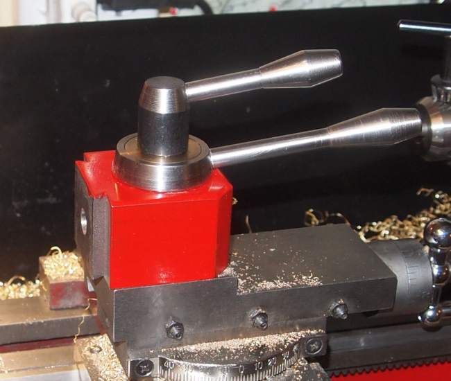

                                                  I bought plans to make a QCTP which is available as a kit (or only drawings) from METAL LATHE in USA, the MLA-23. This seems to be a very nice design, simple and stable. See the following link:
                                                  **LINK**
                                                  The design is also described in the "Home Shop Machinist" May/June 2006, and also a brilliant description in the "Practical Machinist" forum:
                                                  **LINK**
                                                  Since I live in Norway, I ordered only the drawings from METAL LATHE, due to the cost of shipping the heavy hardware from USA.
                                                  Regards Sverre

                                                    Made my first tool holder – I used an aluminium template to make sure the dovetail is a good fit, and of course it is, but that limits the handle's required movement so much I had to drill a new hole for it!
                                                    Very pleased that it locks dead solid with only very gentle pressure. I tried it in anger with a 1/8" width parting tool and it seems fine in use.
                                                    The holder is are from 1" square bar, and seems to have plenty of metal where its needed.
                                                    I am now thinking of all the possibilities and dreading having to machine another nine dovetails
                                                    On the plus side, my X2 mill is working much better now it has the added rigidity plate at the back.
