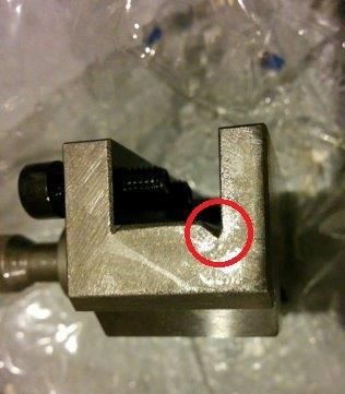

      Does anyone know what this machined ‘groove’ in some of the quick change holders is for / why it is there? Have seen some with and some without.

          Probably an undercut to remove any radius corner made by the cutter and to allow the lathe tool to seat against the bottom and side faces.

            It makes a neat fracture line – as one of my colleagues found out when machining cast iron with a substantial cut on a Hercus 9 inch lathe!

              Thanks. Those were my initial thoughts! To create a 90 degree seat against the two faces but then was wondering why it would be included on the vee holders. Perhaps they just use the same process as part of a chain even though it’s not needed on the vee holder.
              Posted by Alan Johnson 7 on 17/11/2016 04:22:31:
              I was worried about that two, it must technically create a weak point than one without.

                  It is simply bad engineering practice that creates a classic "notch" that will certainly induce a fracture sooner or later.
                  Avoid tool holders with this feature.

                    If an undercut is required, it should be a smooth, rounded shape to reduce stress points.

                      I’ve seen a number of far east copies like this but unfortunately Lambton that would also mean avoiding Bison which I though were in the upper quality bracket.

                        I am not familiar with Bison tool holders and would be very surprised if had such a severe sharp undercut as the one illustrated. If they do then I hope Bison do not make any safety critical components!
                        Avoiding sharp corners is elementary engineering practice. There have been many catastrophic failures of structures over the years caused when this principle has been ignored.

                          You can be surprised because the one illustrated is a Bison T00 that I took a picture of.
                          I agree with you. I have a critical eye as well (unfortunately?) working for an engineering company. Can’t help looking at every detail such as this.

                              It's to make sure any sharp edge on the tool shank or swarf build up doesn't push it out of square with the holder. (otherwise why wouldn't it be on the adjacent inside corner too, clearly indicative of only applying the undercut on the tool seat?)You can see a similar feature on the seats for decent carbide tip holders. I doubt it would break it's quite thick steel. You couldn't apply enough pressure with your hand.

                                Most of my tool holders, some of which are Bison, have this 'groove'. If something went badly wrong I would rather lose a tool holder than damage the tool post or gearbox.

                                  Probably just a result of the production process and not actually put there for a reason.
                                  Take a look at the machining marks on the lower surface of the tool slot. Can't see it in the pics, but it looks as if the square groove has been rough machined by an end mill or perhaps a side and face mill cutter in a horizontal mill. Both these will leave a bit of an uneven surface for the toolbit to sit on. So it appears they have taken a finishing cut over the bottom face with something like a cheap and readily available dovetail cutter, using the face of the cutter to make a nice flat surface. The nick in the corner is simply the result of running that cutter a tad deep in order to make sure the corner has no step left in it that would foul the tool bit when placed in situ. Remember these are churned out by the hundreds and thousands so each one is not set up individually for milling as we would do at home. Having that nick there ensures none has a ridge in the corner without each one being set up individually to the exact correct position to make a perfectly square corner.
                                  Production engineering, it's how things get made by the thousands. Stress point? Yah probably. But they are so cheap to produce they just give you a new one if it lets go in the warranty period.

                                    Cracker of a stress riser ! I use Bison ones on the DSG and none are like that. I would be very surprised if the one in the pic is a Bison.
                                    Hopper, they could stuff the replacement right up where the sun don't shine if it led to a scrapped component warranty or no.

                                            As I said in an above post the one in the picture is a Bison T00. I have the receipt, the box it came in and a picture of the part number on the front – perhaps I was really fooled! Another member above said they have Bison tool holders that are like this. Yours may be a different size, from a different era… Designs can change over time.

                                              While this makes sense for standard holders, why would it be on their vee holders? Apart from maybe a production process that Hopper mentioned. Or if perhaps if guys use vee holders occasional to hold square tools as well (which I have seen occasionally)…

                                                Apologies to mrbuilder, I never noticed that further down you confirmed it was a Bison.
                                                The T00's are different to my ones, and quite a bit smaller. Not withstanding that, they should not have a sharp undercut like you show. As Bison are a very good manufacturer that makes it even more surprising.
                                                If any of my toolholders were like that they would be sent straight back , and if they [ Bison ] were all like that, then it would be time to change to another manufacturer.
                                                It is bad practice to have a sharp undercut like you show, should be a lot smaller and be radiused.

                                                  I have watched this thread with interest; albeit with no experience of the item in question.
                                                  Three possibilities spring to mind:
                                                  1. It is a "Product Improvement" … In which case, Bison might be happy to give an explanation.
                                                  2. It is a Manufacturing Error … In which case, Bison should replace the item[s], and look to their Quality Control Procedures.
                                                  3. It is a Counterfeit … In which case, Bison would presumably be very grateful for the evidence.
                                                  I would send photographs of the item, the receipt, and the box, to Bison **LINK**

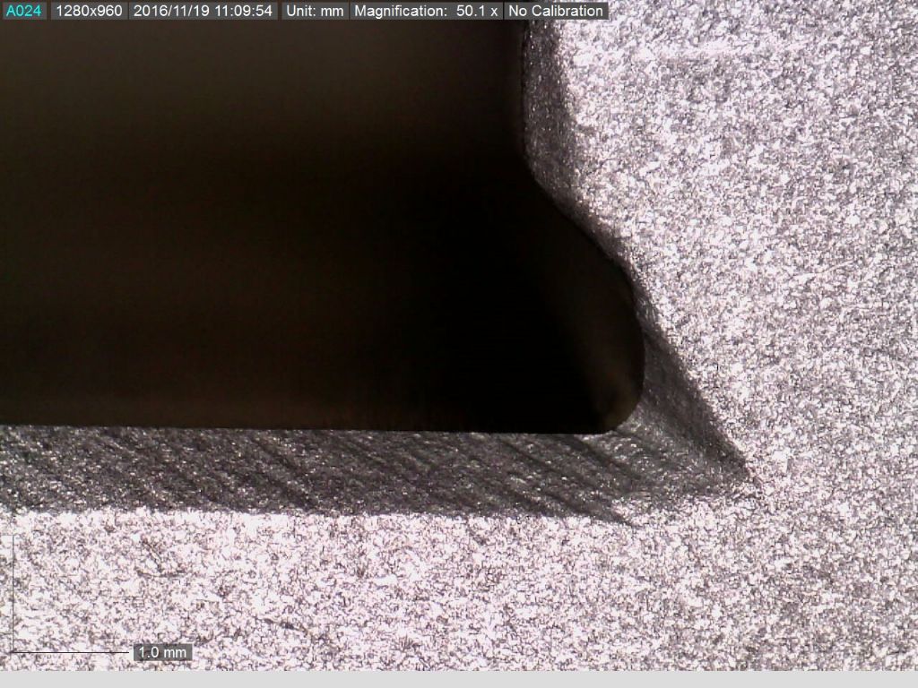

                                                      My tool holders are genuine Bison, the slot is radiused on all of them :
                                                      They don't have the cut marks on the side face shown in the original post. Regards, Michael.
                                                      Edited By Michael Briggs on 19/11/2016 11:39:32
