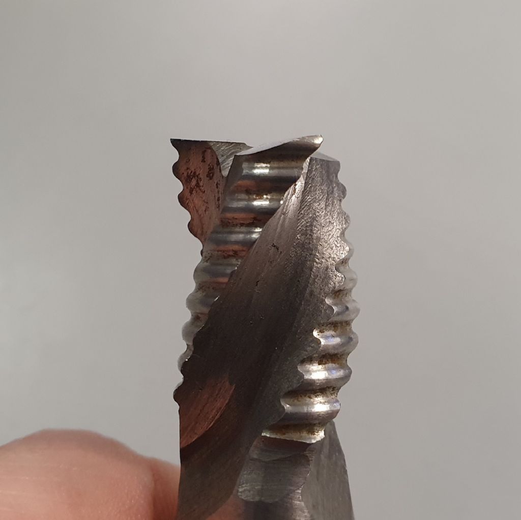

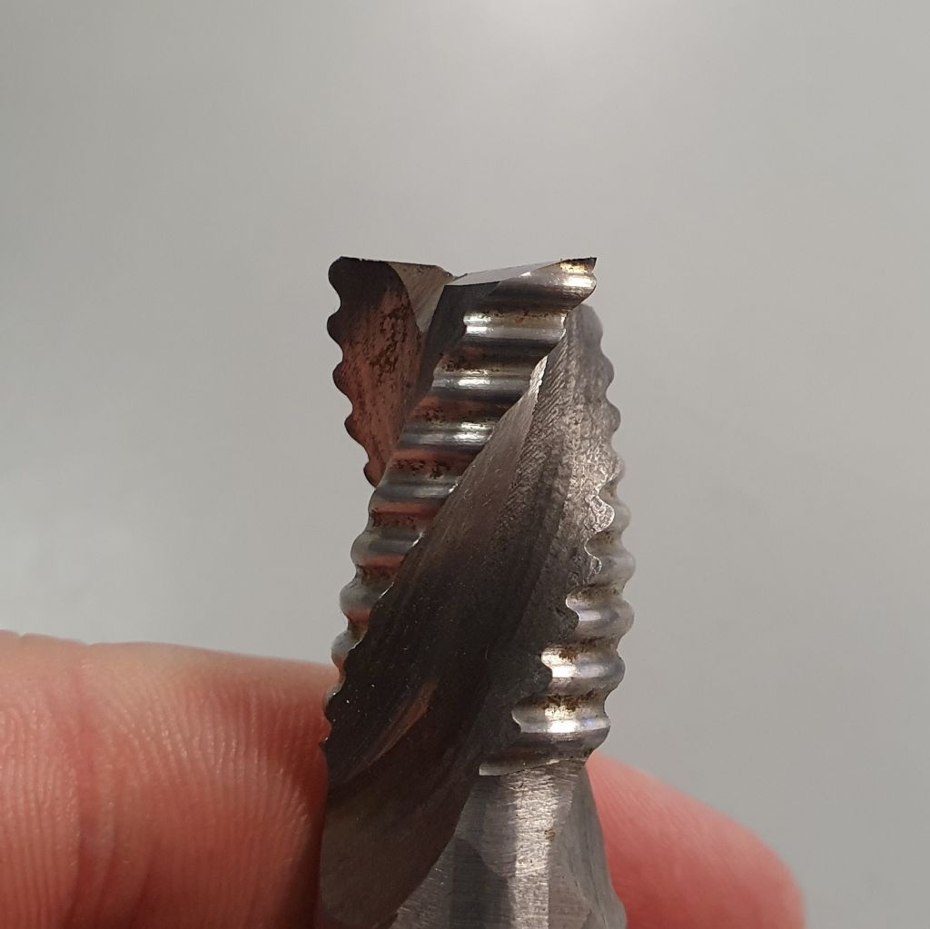

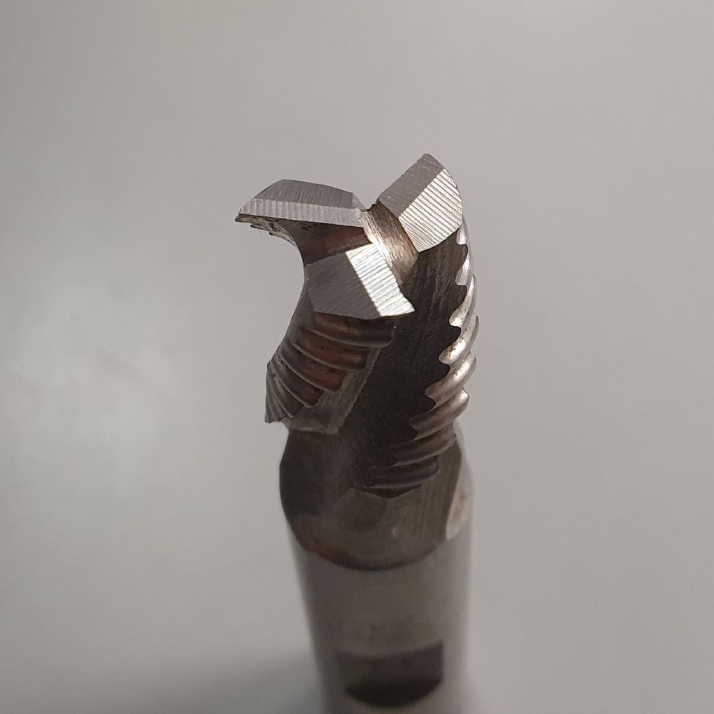

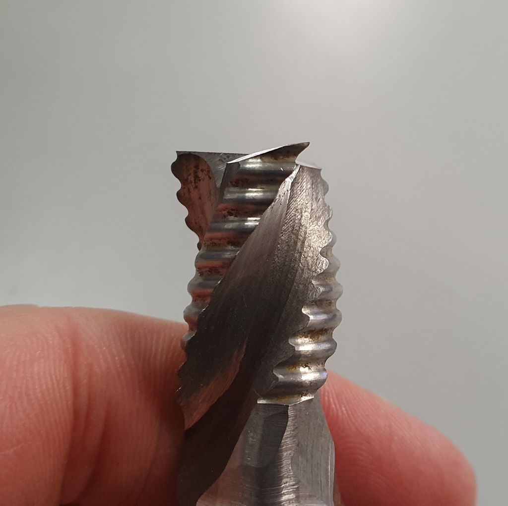

      I have a question regarding the ends of roughing end mills. As can be seen in these pictures, of this particular 3 flute Presto cutter, that due to form of the cutter when the ends are ground they don't all come to a point like a standard cutter.
      So does this mean that when in use, for example cutting an inside corner for say a tee-nut, does the sharpest corner take more abuse than the others and act a bit like a single point cutter?
      Thoughts welcomed,
      Craig

          Best to use the roughing cutter to remove excess material and leave an allowance to machine off with a finishing cutter.

            The operation of these roughing cutters are that the 3 flutes cut grooves at different positions along the length of the cutter. So a bite will be taken and then another just below it and then one below that. This repeates for the length of the cutter which makes for a very free cuttting action. The roughing cutters I have used have all been bevel ground on the tips which makes for a longer life and does eliminate the chip loading on the sharp corner (basically by avoiding sharp corners). This one looks like it has been reground. They are not really for finish cuts.

              The tip has a progressive depth of cut on the tip corners, as previous it is used to a depth using the flutes, corner edges may be chamfered also. For more information look at Guhring or similar roughing cutters.

                  I am aware they are for roughing out and not finishing which really is what got me thinking about the ends because unless you are just using the flutes to remove material from the periphery of something thinner than the depth of the flutes then the ends and therefore corners are going to be doing some work. And by definition these cutters can be worked hard so I was just curious about the vulnerability of the ends, imparticular that one sharp corner.
                  Yes this cutter has had a regrind but im sure I have seen new ones with a standard grind on the end in the same fashion as this one, happy to be corrected if this is infact not true

                    Because the outside profile is a rounded single start thread form, there will never be a perfect end corner on all the flutes. If anybody was to make a 3 start thread form with 3 flutes, all of them could have an identical square end. I have a solid carbide 10mm endmill with the roughing profile and the "thread" pitch is about 2mm with 4 flutes, I haven't tried it out yet.

                        Most, but not all, of mine are radiused at the end to prevent the flute with the end of the thread taking too much load.

                                  I would say yes one tooth is cutting leaving a larger radius in the corner than the other two but that also means that the tooth that comes to a full radius and a sharp corner has less work to do.

                                      I may just stone a radius on the sharp flute.
                                      This however sparks another question, I have a number of standard end mills where the sharp point has burnt up, blunted or chipped and I always assumed these would require the attention of a T+C grinder but, as discovered with these roughing cutters, if differences in the tips doesn't effect the functionality of the cutter (which is obvious as they wouldn't sell any) then can I hand grind a chamfer or fillet on to the corners of these old end mills to get them cutting satisfactory again?

                                          As ripper mills are primarily intended to cut sideways rather than end on as a slot mill, you can simply grind the end square to shorten it. This would get rid of the tip which is normally the first part to go blunt.

                                            Back to the Craig 2's question about the end grind: One of the flutes will extend to center while the other stop short of center. It is capable of plunging.
