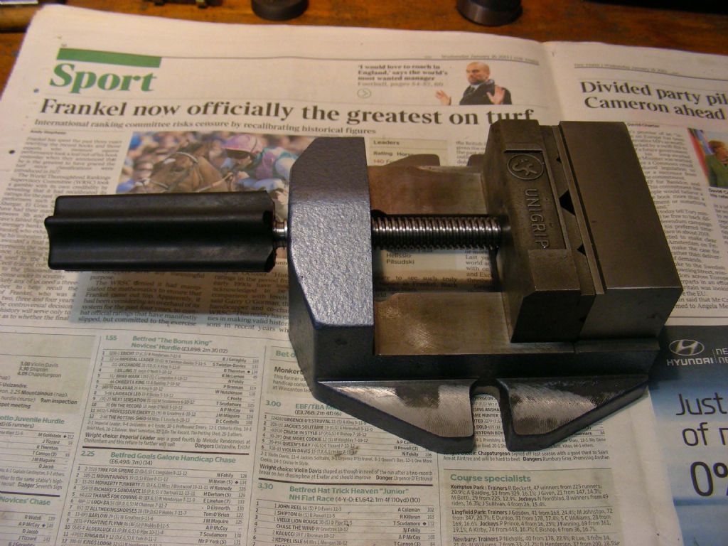

      There have been a couple of threads about the NiPPY vice in recent years, one including a reference to the Jones & Shipman version which seems to have been called the Unigrip, possibly a misnomer as the elaborate jaws of both versions permitted gripping the work in a variety of ways.
      At a MEX some years ago I bought a simplified version of the Unigrip with plain jaws and RH M12 leadscrew working in a tapped hole in the casting. I have used this rather infrequently as the relatively fine screw makes adjustment painfully slow compared with the NiPPY arrangement of a LH 8TPI acme screw working in a threaded hole in the knurled handle. Having looked at a friend’s NiPPY I am planning to modify my vice to provide similar more convenient working.

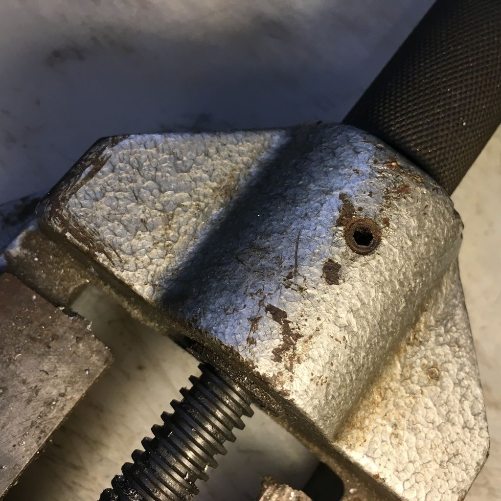

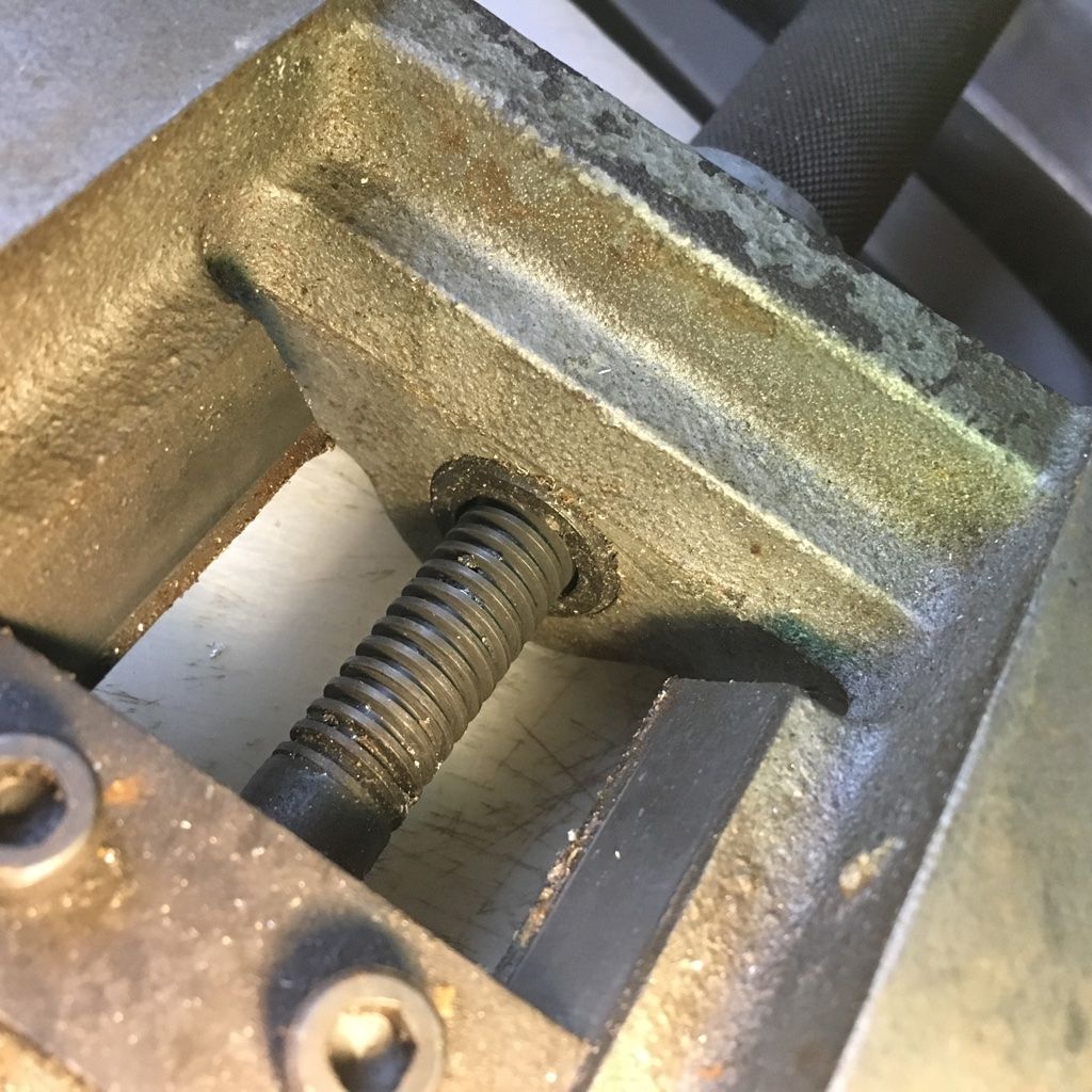

              It's all rather nicely concealed:
              Note : What looks like a washer in this view is actually the end of the 'handle'
              Here's the reataining screw:
              Edited By Michael Gilligan on 18/12/2018 14:15:53

                Many thanks indeed for your excellent photos which I will digest alongside some of the NiPPY; at first sight, the construction seems somewhat different.
                As you may have gathered, I felt that my later J&S represented a "dumbing down" of the design of the one you have. There is, however, one point where the later one may score in practice: "mark 1" has the leadscrew rigidly fixed to the moving jaw and this, along with the ant-lift plate underneath the slide, restricts the jaw's ability to accommodate a slightly out of parallel work piece; "mark 2" has a notch in the jaw which flexibly holds the (rotating) screw and allows a small amount of pivoting movement limited, of course, by the anti-lift plate.

                  In Michael's second photo there is a grub screw in the top of the casting, on my version that screw is the hole blanker for the bearing race, to remove the handle from the casting it is necessary to remove the blanking screw and get all the bearings out through the hole, a strong magnet helps!

                      The blanking screw clamps nothing, it merely facilitates removal and replacement of the bearing balls, the inner race is integral with the handle, the outer is integral with the housing, no plate as the bearing does all the work.

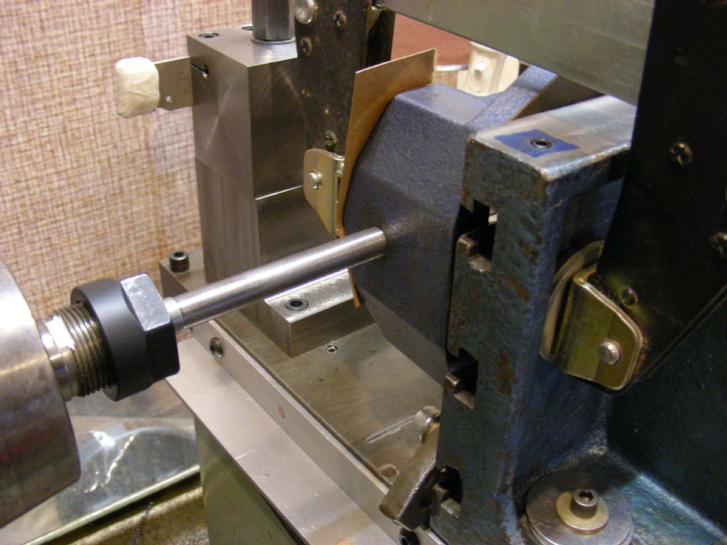

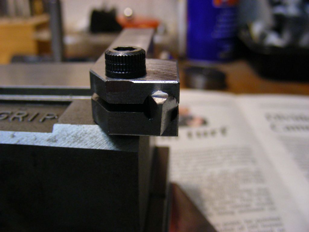

                                      I eventually decided simply to replace the M12 screw with a 1/2" Acme screw; this gives adequate clamping pressure and is more convenient in use. My photos show the vice with new screw, the body of the vice set up for tapping and the tool used to cut the screw thread:
                                      In the middle photo the job is being aligned with a mandrel in the ER chuck; this was then replaced with the tap and the thread cut under power with the saddle feed set for 10TPI.
