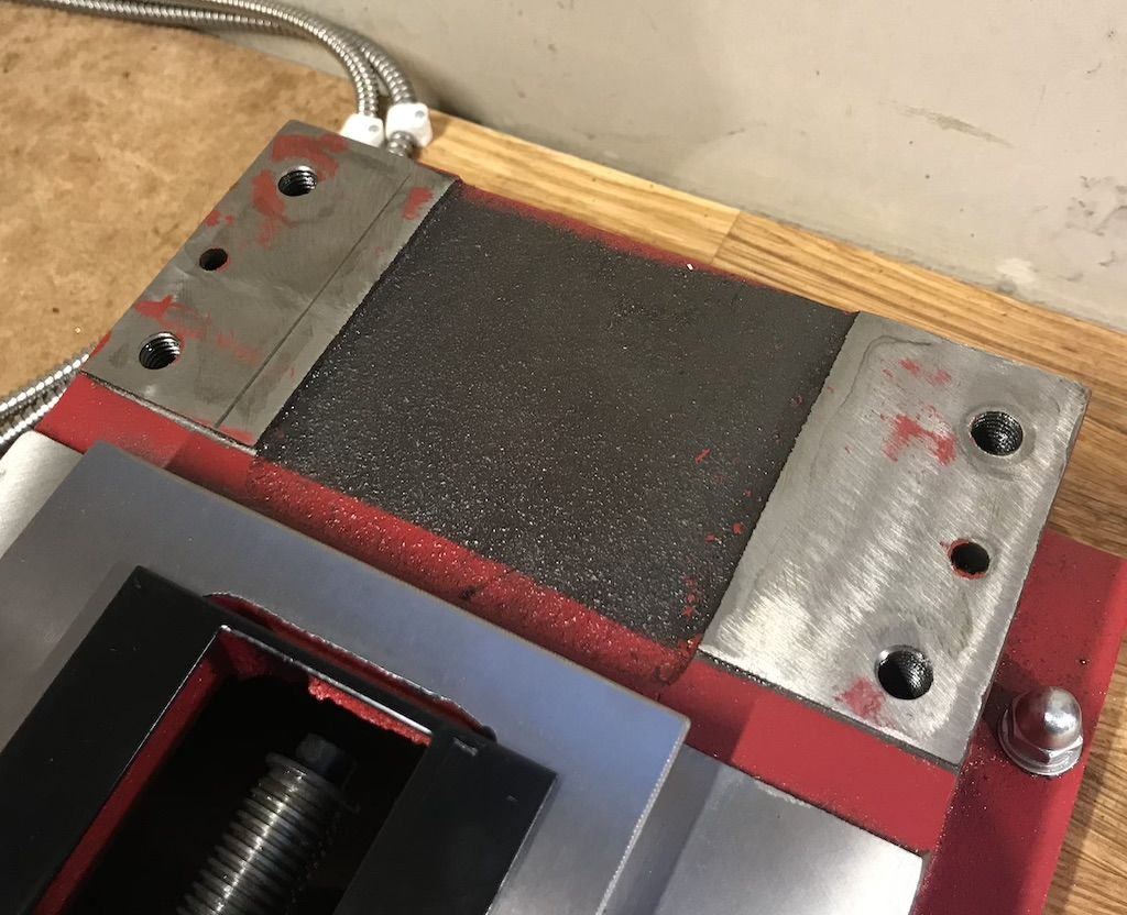

      In a different thread I described a problem I had with one of the gibs on my Sieg SX2.7 mini mill. I ended up making a new one and solved that particular issue.
      Next I started working on squaring the column, but shimming didn’t seem to work how I expected so I disassembled the mill completely only to realise that I opened pandora’s box filled with all sorts of issues:
      The two pads, to which column was mounted, were uneven. In some places up to -0.35mm. They were also convex which led to mounting bolts not holding the column firm and stressing the casting. It all looked as if it was ground to “fit” with what could only be an angle grinder.
      SX2.7 column mounting pads
      (red markings were done with a straight edge across, not touching the middle part)
      I reground the pads flat on a surface grinder (I used the ways as reference, assuming they were good, and shimmed the base underneath). Then I shaped the bottom of the column flat and square to the Z ways I assembled it back together and squared the column with the table. I got really good result on the nod, pretty much 0.00mm over 75mm, but I couldn’t get sideways tilt to be better than 0.015mm over the same distance without disturbing the nod. It would also change slightly depending on where on the table I put the reference precision square.
      I accepted that, after all it’s a hobby machine, and proceeded to verify the head/spindle tram/squareness to the table. It was square front/back, 0.01mm over the table width which is fine, but the left side of the table was 0.20mm high over the same distance.
      I was disappointed and kinda surprised. I did verify the spindle was square to the head itself. I removed the table and the saddle and measured them on a surface place. The saddle was "fine" I guess. Both top and bottom sliding surfaces were slightly concave so the table was supported only by four small high corners points but at least they were pretty much same height and got quickly fixed on a surface grinder.

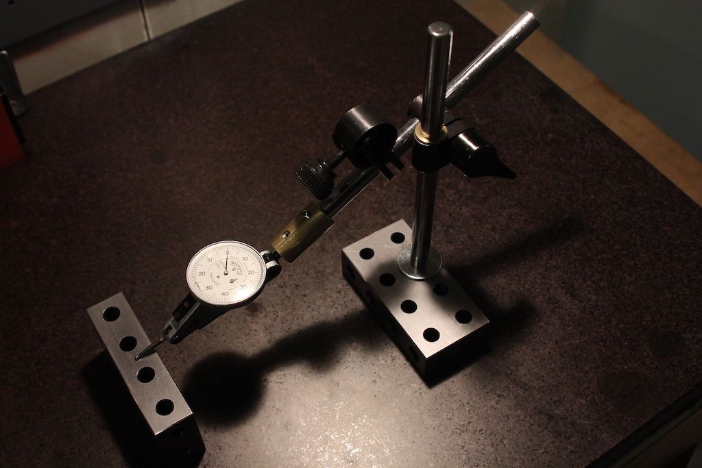

      The table wouldn’t fully fit on my surface plate, I only have a 40x40cm one, but it is definitely not flat. Using marking blue revelas very few points it rests on and a hammer sound test confirms that there are hollow areas on its sides. Measuring its ways shows 0.07mm variation over its ~60cm length which is acceptable.
      The last and the worst part are the cross travel slide ways on the base. They are neither parallel nor flat. The left one is between 0.05 and 0.12mm higher than the right one. I made a short clip showing the measurements. I did verify the jig on my surface plate both before and after checking the base.
      Measuring fixture 1
      This, together with the lack of precision of the table itself results in left/right tram being 0.20mm off over 14cm.
      I can now either scrape the ways flat and parallel, which with my limited experience is definitely a challenging task, or take it to a friend with a larger milling machine and try fixing it that way.
      Am I simply expecting too much from a ~ £1200 machine or purely out of luck with my unit? I’ve seen other owners of that very same mill showing their measured precision and it seemed to be much better.

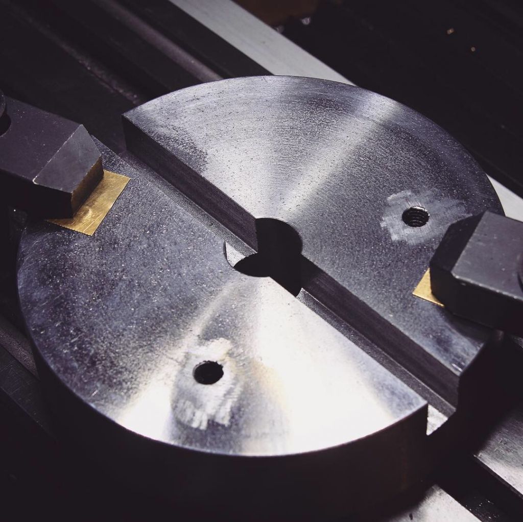

                                                Yes it was your videos Jason, but there was more than just that. I agree I could continue using it on smaller items and never notice any difference in my results.
                                                Unfortunately, I decided to build a 130mm 2 jaw/off-center chuck for my lathe and wanted to get it as good as possible to reduce the total error when it’s gonna be used.
                                                2-jaw chuck project - back
                                                2-jaw chuck project - front
                                                The slot ended up being more than 0.1mm offset even though I centered it carefully. Does the 0.15mm make a difference that would prevent an engine from running, probably not. I still want to have it central
