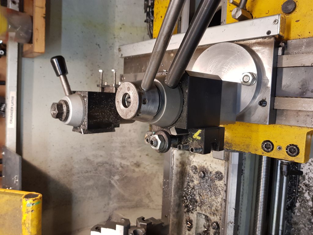

                          Refering to Sam's message above, I have also tried a Dickson style toolpost, of the 73 x 73 x 51 approximate size, on my Warco WM250VF. I agree that the arrangement is insufficiently rigid, due to flex in the top slide and clamp arrangement, and certainly aggravated by any extended overhang of the tool.
                          I have been through a similar exercise to that shown on **LINK** , but still using the Dickson style toolpost. I first built a 'Rock of Gibraltar' inspired post using a machined lump of 100mm diameter cast iron mounted on a cross slide base plate sold by Warco to replace the top slide. This is about as solid as possible on this machine! I am very happy with the performance of this, and have been using it when the functionality of a top slide is not needed.
                          I very recently built a variation of the 4-bolt clamp unit on **LINK** but again using another cross slide base plate from Warco, to replace the supplied 2-bolt clamp to hold the top slide. This appears to work satisfactorily but I have not done much with the lathe since: I think I might however stick with the 'Gibraltar' for most work.

                                                      Genuine Dickson and the better clones have a vertical through-hole in one corner, this allows the engineer who knows what it's for to make and fit a locking pin with associated shallow indexing holes in the base under it, any well designed QCTP will have a facility for quickly returning to a known zero position.
                                                      I can move my front and rear Dickson QCTPs to any angle I like and then lock them back at 90 degrees with the locking pins.
                                                      It did take me a while before I realised what the hole was for
