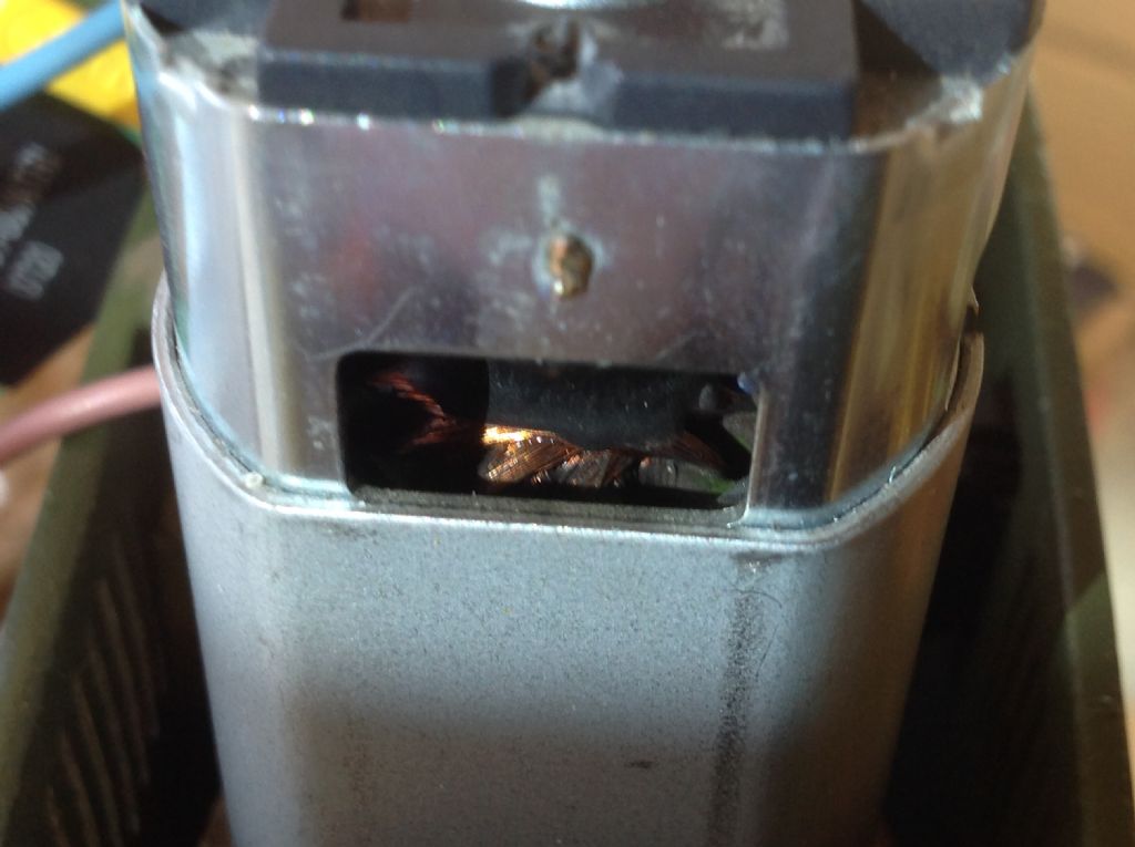

        Can you see the motor windings and commutator or is it a sealed unit?
        Blackened / burnt varnish on the windings is what we hope not to see
        It could be the brushes have worn out, can you pull them out and check their condition – length is key as is the commutator face-end

            Bill Phinn
              @billphinn90025
              Thanks for the further replies.
              Andy, the windings are partly viewable. I've taken the best photos I'm capable of. I've also shown the commutator. The brushes are higher up than is really photographable, but they do look to have plenty of meat on them, although it's a little difficult to tell given the fact that most of their meat is hidden in the (spring-loaded?) holders. I've got to say I don't really suspect the brushes given the relatively short run time this machine has experienced since new.

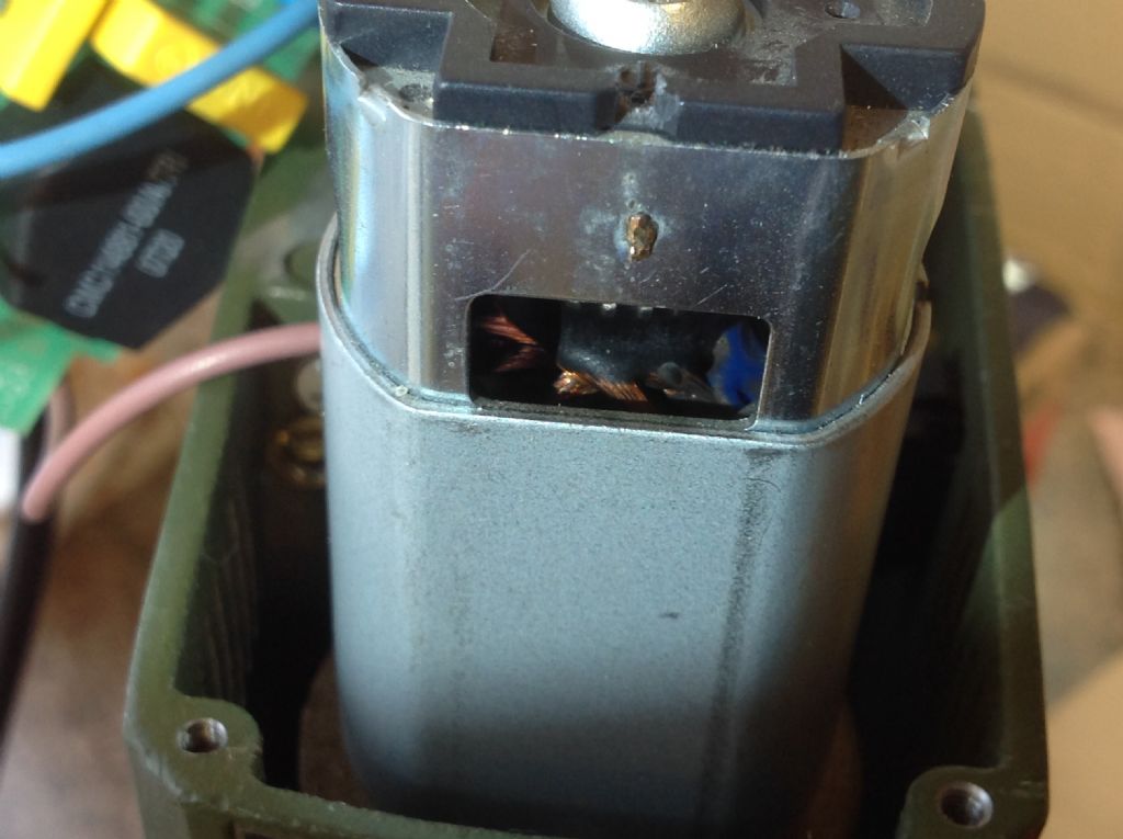

              #393942
              Bill Phinn
                @billphinn90025
                img_0833.jpgAnother photo of the windings:
                #393953
                Martin W
                  @martinw
                  As far as the pictures show the motor doesn't seem to have been over stressed, commutator and windings look to be OK as far as it possible to see and the same applies to the circuit board. I am wondering if it isn't, as earlier suggested, a failure in the mains supply cable near or at the point it enters the head. If this is the case then the machine fuse will have remained intact and the plug top fuse would have taken the brunt and could have blown with an audible pop. This would also fit in with the motor occasionally stuttering prior to the failure as the break in the cable intermittently failed. If the plug fuse has blown then without having the ability to check the cable with a meter it may be worth replacing the supply cable and trying it again to see if there is any response. Another way would be to use a mains indicating screwdriver/tester and after replacing the plug fuse see if there is any indication of the mains being present at the circuit board, no need to say really but just be careful when working on exposed mains.

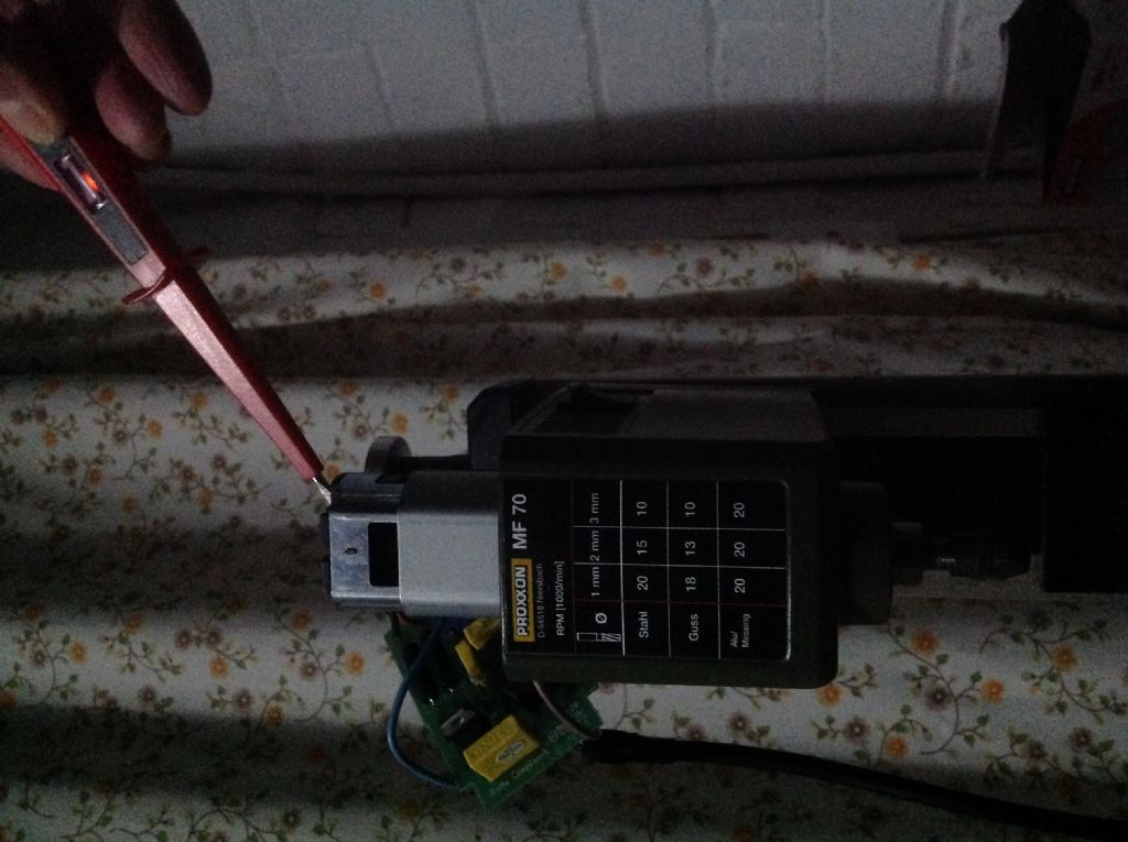

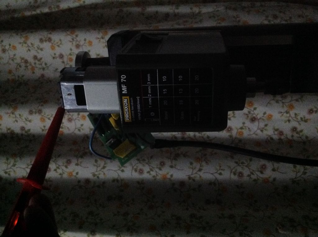

                  Bill Phinn
                    @billphinn90025
                    Thanks, Martin.
                    I've attached two images showing the result of a neon screwdriver being held to each of the two motor terminals in turn. The fact that it lights up suggests to me a working circuit from the mains via the switch and control board. Does this necessarily mean either the control board or the circuit is healthy? I know it says nothing about the health of the motor.
                    Tim, I forgot to say, I tried the drill battery with an in-line fuse. It didn't power the motor.

                    #393984
                    Emgee
                      @emgee
                      Bill, IMO checking with a neon screwdriver is telling you nothing about the state of the controller , they illuminate at the sight of the lowest of voltages and should not be relied upon for such testing.
                      If you haven't got a basic multimeter it would be best and safest to remove the controller and motor and take to your local motor repairers, failing that perhaps a supplier can be found who offers a repair service.

                            #393999
                              Posted by Bill Phinn on 31/01/2019 18:44:48:
                              No guarantees, but …That looks encouragingly like a DC voltage being indicated.
                              So now I'm wondering: Is the motor physically seized rather than electrically faulty.

                                              #394278
                                              Bill Phinn
                                                @billphinn90025
                                                Many thanks to everyone for your replies.
                                                Michael, the motor appears not to be seized if the free turning (by hand!) of the spindle and commutator et al. is anything to go by.
                                                JRow16, on the plus side your double failure of an MF70 makes me feel less unlucky than I otherwise might have done, but it has virtually sealed my unwillingness ever to put money into a piece of Proxxon machinery again. Was this the place you ordered the motor from: https://www.fluidonline.de/proxxon-28481-19-motor-mit-stuetzring-fuer-ib-e-ibs-e-ersatzteil/a-5776/.?
                                                If so, I'm not sure whether it makes any difference, but the part number is one digit different from mine (which ends -11, not -19). While we're at it, I'd be interested to know how you uncoupled the old motor; I did try removing the two retaining screws at the base of the motor but it seems it can't be lifted away unless the spindle locknut is first removed, and I'm not sure how that's done.
                                                John Paton, I wil try your second suggested test this weekend, thank you. I'll have to desolder the motor terminal wires anyway if I'm to do Tim's suggested resistance testing.
                                                Tim, it turns out my brother has a decent quality multimeter and he used it only yesterday to check the resistance on his newly installed underfloor heating; I could always buy my own rather than wait till I see him next. I will try your suggested tests as soon as I am fixed to do so.
                                                Posted by Martin W on 01/02/2019 00:22:30:
                                                Bill
                                                If you can do it safely then test the point at which the blue wire is connected/soldered to the pcb with the power on. If the neon lights up then you would appear to have a break in the neutral line to the mill. If there's no reaction then the neutral should be OK and we can discount the supply cable for the time provide the plug has been wired correctly.
                                                Martin, I have just done this test, touching the screwdriver tip to the solder at the back of AC wire. The potentiometer was turned all the way up and yes, the neon illuminated. You say this would appear to mean a break in the neutral line. Can you tell me in simple terms how we know it means that, and how I can trace the location and or cause of the break?

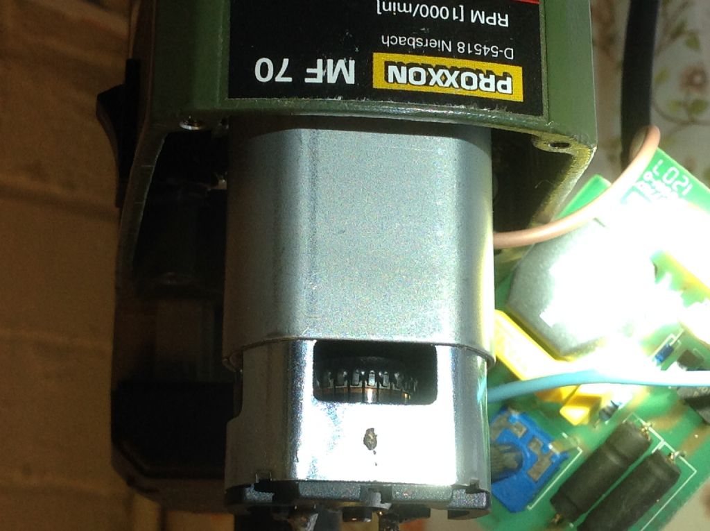

                                                  #394642
                                                  Roger B
                                                    @rogerb61624
                                                    There was apparently a design change in the MF 70 motor so the detail of the part number may be important.
                                                    This company offers a possibility:
                                                    **LINK**
                                                    The parts list is here if you don't already have it:
                                                    **LINK**
                                                    I have removed the motor from my (probably newer) MF 70. There is a screw either side of the motor and then you have to pull the motor out of the coupling. The older version appears to be more like a gear.
