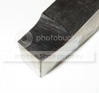

      A new fundamental workshop skill that I wish to acquire is tool grinding.
      I have an off hand grinding machine (Axminster bench grinder) and have experimented with free hand sharpening, but would now like to progress to precise angular grinding work to get the very best from HSS tool steel blanks.
      Having read around on Harold Hall's website, I was going to buy his book "Tool and Cutter Sharpening" to be able to make his *simple* grinding rest. Could anyone comment on whether this is a good course of action for an ambitious beginner to precision tool grinding?
      I did read and admire the Hemingway Worden Mk3 grinder, but the cost and building challenge is too much for me!
      Thanks for any help in advance.

                  It isn't that difficult to make a rest for 'precision' tool sharpening. This is not for drills and endmills though.
                  Draw a circle the dia of your wheel. Draw a toolbit with the top against the wheel at the half way up level. The end will be ground at the tangent angle right? Here 90 degrees.
                  Draw a radius at 10 dergees above the horizontal, its corresponding tangent is at 10 degrees to the horizontal so the end of a tool at this point will get ground to 10 degrees. Now draw in your tool blank, with appropriate thickness at this point and you can measure the height above the half way point that gets you the grinding angle you want.
                  So all you need is a stout block of wood as a main post then a couple of thin sheets that give you the angles you want – probably 10, 15, 20 only. Allow for a flat steel sheet of say 1/16 on top to prevent the tool digging n and allow you to slide it around. Maybe do your primary grind with an extra bit of shim then remove it for the in service touch up at a slightly lesser angle.

                      Freehand grinding will get you any shape tool you are likely ever need. The typical bench grinder has two faults: the work rest is inadequate and the wheels supplied are ill suited to grinding high speed steel. Those limitations acn be corrected quite easily. A work rest similar to the Veritas will make it much easier to use. Friable aluminum oxide wheels do a much better job on high sped steel than those supplied with the grinder. In the US the friable aluminum oxide wheels for bench grinders is listed tn the catalogs catering to woodworkers.

                        I agree with some of the posters above that for simple lathe tool sharpening – any system that lets you get some level of repeatability to the angles ground will do the job. I simply replaced the very small support on my grinder with a larger table using the existing mounting holes. A simple sliding plate with swivelling finger does the rest.
                        However, what I am not seeing mentioned above, is the fact that I use this generally just to shape the tool (not to sharpen it). You certainly can use tools straight off the grinder and they will work OK (I used to do this and still do so sometimes) – but for really sharp tools you need to hone them. At one time I used to (mistakenly) think this meant just making the whole ground face "smoother" but in fact it's about achieving a separate facet on the tool. You can do this by grinding and honing at slightly different angles – or use the curve of the wheel to give the required under-clearance to the honed face. Not only will you have sharper tools but they are much easier and quicker to keep that way.
                        So my advice would be to use a simple rest to get a consistent ground face and a honing jig to give you sharp tools that are quick and easy to keep sharp. Some can do this freehand but I'm not that gifted I'm afraid.
                        Usual caveats – my work is usually small in nature and I'm a great believer in small tool sizes (I typically use 3/16" HSS) as (again) it's quicker & easier to grind to initial shape – and my old machinery (not the most rigid) really appreciates sharp tooling. As for other cutting tools, one day I might actually finish the Stent T&C but in the meantime I use single point tooling whenever possible and save my expensive milling cutters for when I really need them.
                        Just a personal point of view which will certainly not suit everyone but works for me. It took me a good while to get to this understanding though – so I thought I'd share it.

                                      To start, learn how to grind a knife tool and a parting off tool. That is learn by trying. They will cover 95% of all your turning. By the time you have ground these many times you will be able to work out how to grind more fancy tools such as rounded tools, form tools and thread cutting tools. As stated all the angles are approximate, the tool will cut well if they are about right.

                                                I would agree that with practise free hand grinding of HSS lathe tools is easy and quick. If you havent got the knack then other more sophistcated set ups mght need resorting to.
                                                I have some rather particular injector cone making lathe tools to very accurate sizes. They are all honed as per Hopper's methods.
                                                I was taught how to get a good edge on woodworking tools when in my teens namely chisels and plane blades. That was a good grounding for metalwork lathe tools later on.
                                                I also use clockmakers type gravers a lot in the lathe and this teaches optimum cutting angles on different materials.
