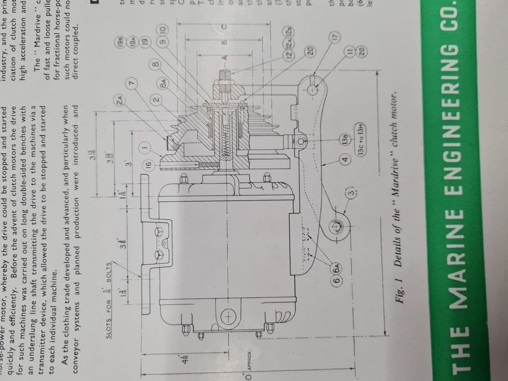

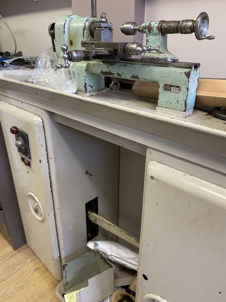

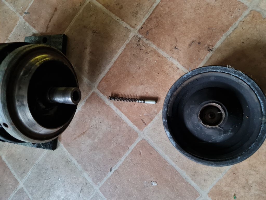

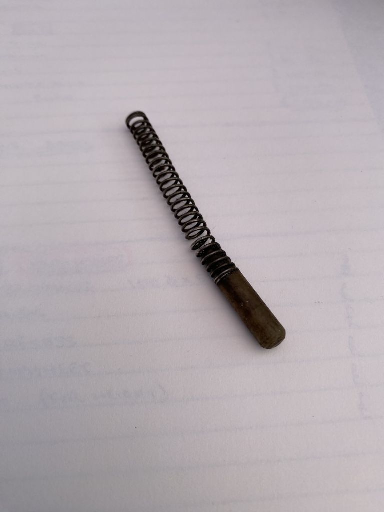

      Hi, I have a Pultra Lathe that has been in storage for some time. I am now trying to assemble it to use in a new workshop. I have put the machine together but have found a part left over that I can't see would fit anywhere. (image attached) pultra 2.jpg I discovered from the wealth of original literature that came with the lathe that it is a clutch thrust and spring. Secondly Whilst the lathe was in store my carefully labelled wiring decription ( image att) pultra.jpgto the front control switch has faded and I don't know what goes where. Would anyone be able to in simple 'leyman's terms' advise me on this problem. Lastly while searching for the odd left over part above in the literature I worryingly discovered that the brake pad on the Mardrive pulley system supposidly has an Asbestos brake pad. (image att 13B))pultra 3.jpgHas anyone come up against this problem and could advise how to replace or resolve this predicament. Many thanks.
      #34176
      martin baker
        @martinbaker81996
        not knowing where parts fit and wiring confusion

          If the brake does not need re-lining I'd suggest your best bet is to leave it alone. I would clean it and the enclosure with a slightly damp paper towel (perhaps moistened with meths rather than water) and seal that in a bag for disposal.
          if it needs a new lining, try a brake and clutch relining company.

            #634550
            Colin D
              @colind

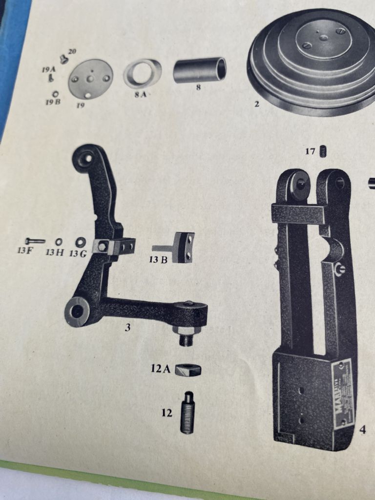

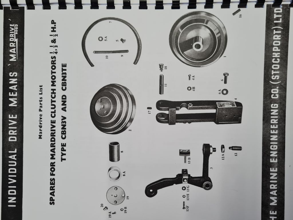

              20230222_075605.jpg20230222_075553.jpgThe part you've shown goes between the two halves of the clutch, it pushes it out of engagement, hopefully my photo 20230222_080418.jpg this.

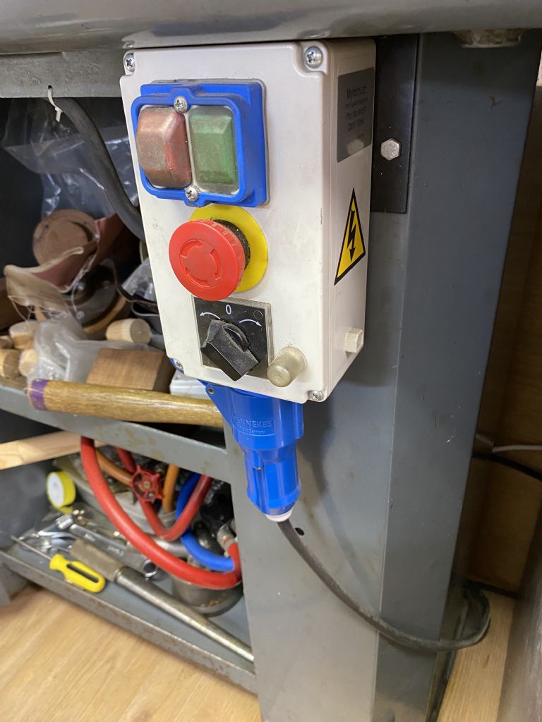

                The wiring ! you appear to have a MEM contactor and a santon rotary switch. Will you need to reverse the motor ? I will not try to remember the wiring for this I will look some diagrams and come back later today with luck. As for the brake pad don't worry, just wipe down with a moist cloth and dispose of – if it needs relining a piece of brake shoe material will be fine. Noel.

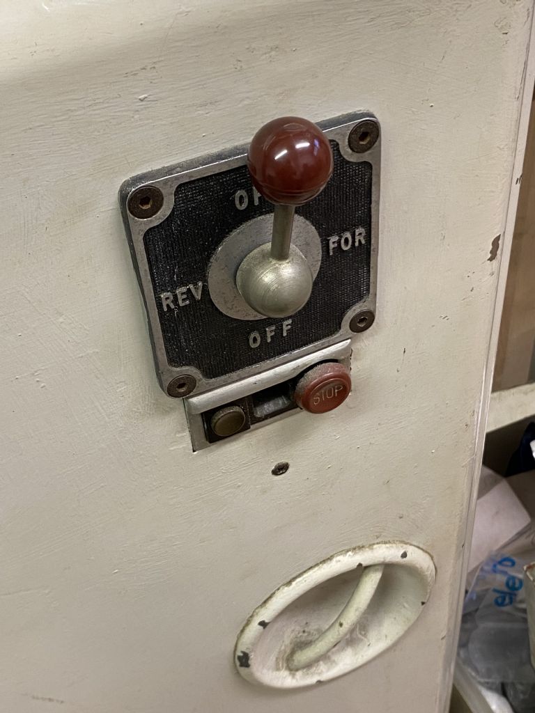

                                          @martinbaker81996
                                          Hi Noel, Yes sorry about that. I would like to be able to reverse the motor and also have some wiring diagrams. I would be very grateful for those. Thanks Martin.

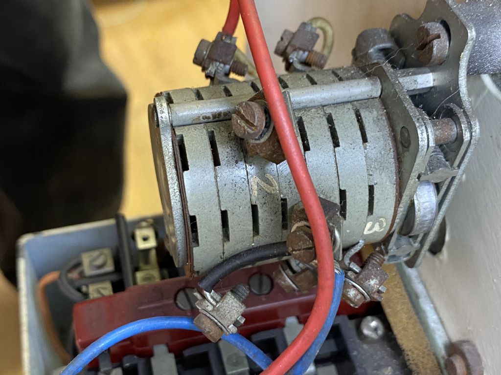

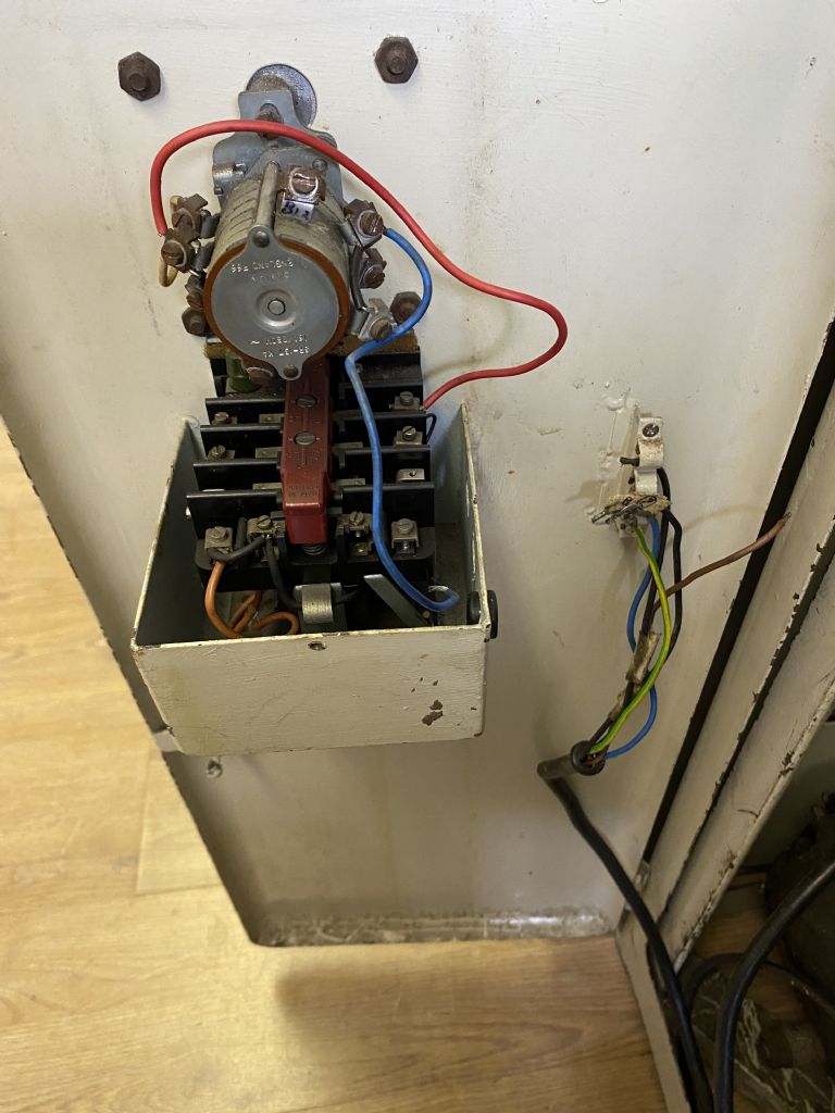

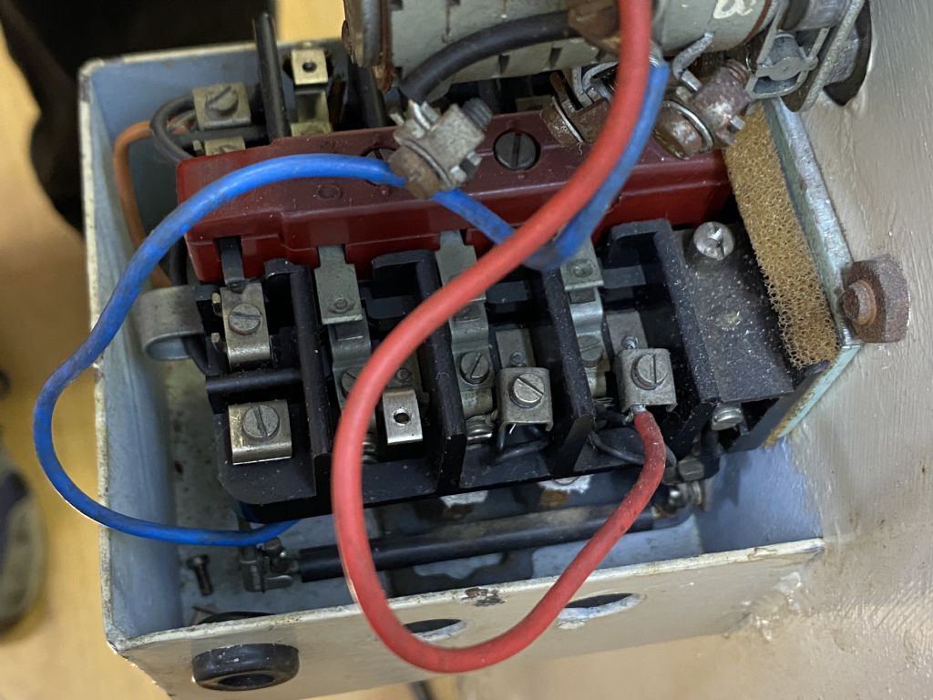

                                          #635133
                                          martin baker
                                            @martinbaker81996

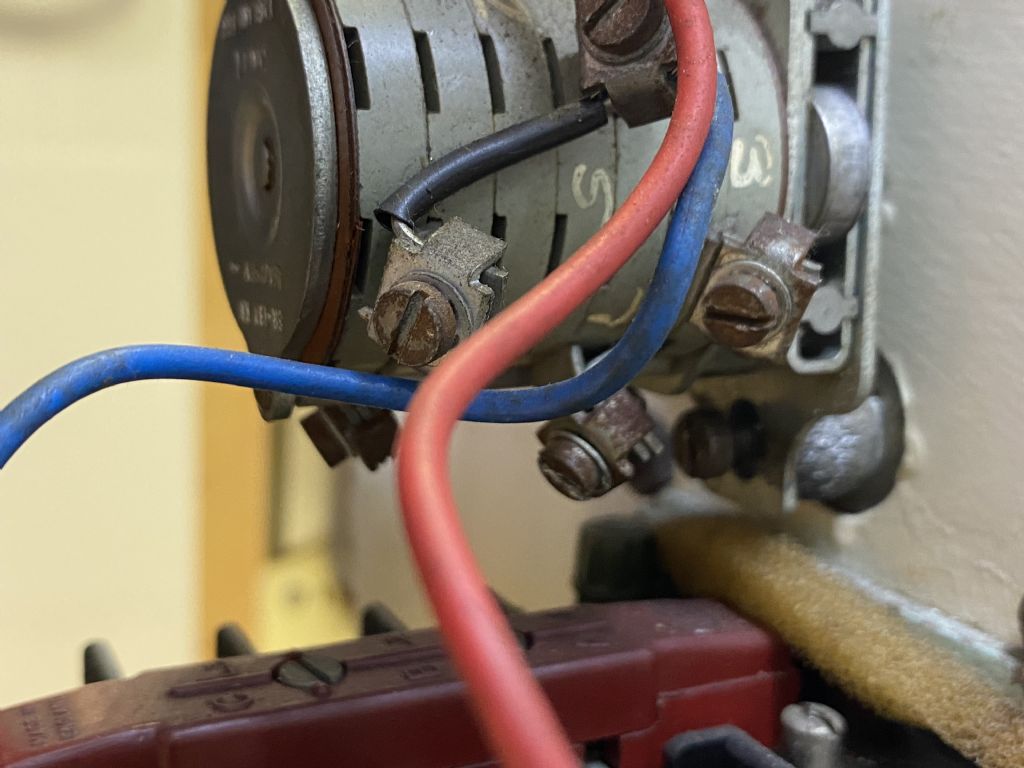

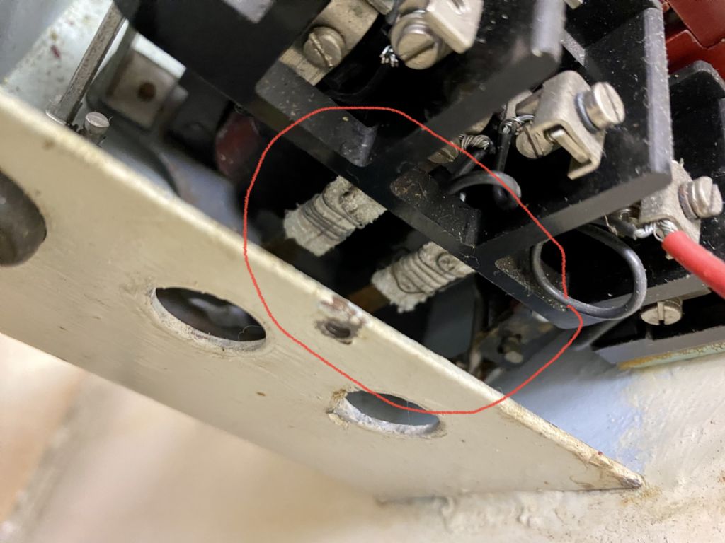

                                            internal.jpeginternal.jpegGetting a bit paranoid now as I was looking at the guts of the forward /reverse switch on the pultra cabinet and noticed the wired parts I have circled in red. Are these also Asbestos? as they look pretty ragged. If they are should I look for a replacement modorn switch equivalent? appreciate your advice Martinfront of switch.jpg
                                            #635227
                                            noel shelley
                                              @noelshelley55608
                                              Hi Martin, I wrote a long reply, only to drop the mouse – and loose it all. So ! What make of motor do you have ? Ideally we need to know what letters do you have on the terminal board. Does the reversing switch have a makers name on it ? Santon ? Does it have terminals marked F-, F+, A1, A2 ?
                                              The contactor has overload on it, yes the insulation is asbestos, but left alone it will be ok ! A new switch is unlikley to fit the cut out on the panel and needs to be the right current rating for the motor to work. It appears to have 2 overload heaters, or are there 3?
                                              I'm not sure wether this is a task that a layman should do ! Make certain that you have all metal connected to a good earth and ideally on an RCD. I will dig out the diagrams. Good luck Noel.

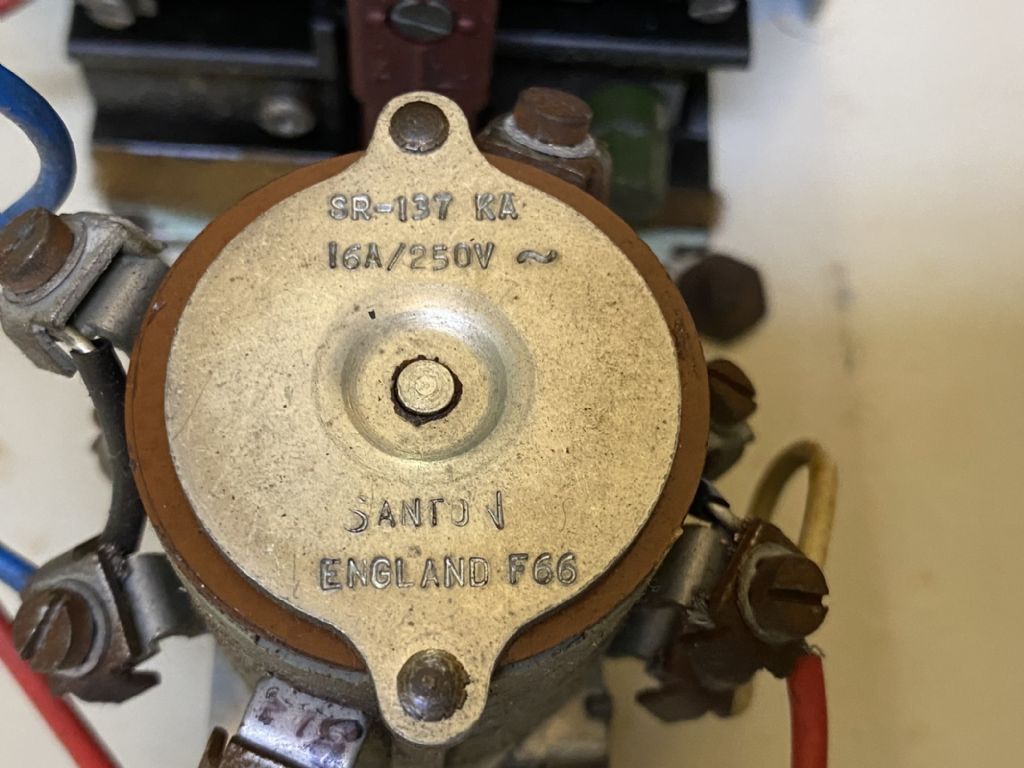

                                              #635282
                                              martin baker
                                                @martinbaker81996
                                                img_8556.jpgimg_8555.jpgimg_8554.jpgimg_8552.jpgHi Noel Images of the switch which is indeed a Santon. Also a reversing on off switch I had to put on my Myford when the main control switch gave up. Could something like this be a replac ement? Thanks Martinimg_8551.jpeg
                                                #635294
                                                noel shelley
                                                  @noelshelley55608
                                                  Right Martin ! The modern vogue for No Volt release systems is fine but it is the poor mans direct on line starter. It offers no protection to the motor, just the panic button and automatic disconnection in the event of a power failure.The tripus unit on the myford does have overload protection. Has it been set to the correct full load ? Was it supplied as a ready to run unit or did you have to wire it up? To wire up your existing set up you need the four wires from the motor, 2 start windings yellow and blue are common colours and 2 run windings sometimes red and black.These colours are the tails to the windings in the motor. Depending on the motor you have as to what the terminal plate may say, eg Z1/Z2 start, A1/A2 run. The Santon switch and the MEM DOL starter are almost 60 years old. The Santon connections could be(depending on model and age) neutral to F-, live to F+, A1 and A2 are the start winding connections and terminals adjacent to A1 and A2 are the run winding connection. If the motor runs the wrong way according to the plate then swap the wires to A1 and A2. It would be good to connect a supply to F- and F+ at this point along with a good earth and see if the motor runs and can be reversed.
                                                  Looking at the MEM DOL starter I think someone has removed the third overload heater. can you read a voltage on the coil in the middle of the unit ? should be 220v ish. I will put the diagram and data for the MEM auto memota DOL to morrow when I've typed it up. Good Luck Noel.
                                                  #636086
                                                  martin baker
                                                    @martinbaker81996
                                                    Thank you Noel, I shall attempt your instructions but might ask a ''sparks' neighbour for help. Just out of interest are there equivalent replavcements for these old switches? Martin
