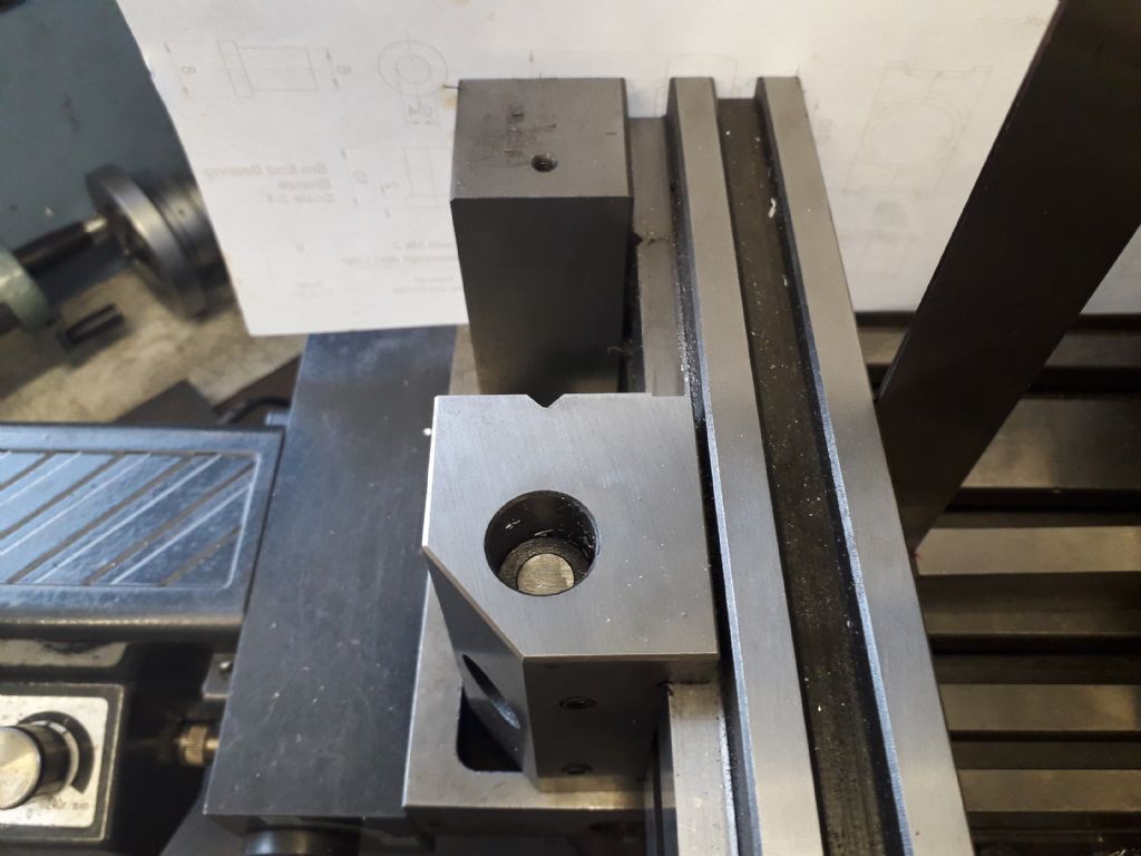

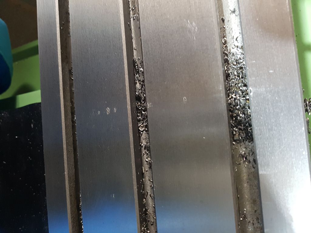

      I have had an issue with a 90mm Type 2 milling vice damaging the table. This is a very accurate vice with good capacity. Mine however has caught me out twice now through the tightening bolt touching the table and causing crescent shaped dents.
      After the first time I chamfered the bolt end slightly, which did not take any thread away but just removed the ragged end. I checked this provided enough clearance or at least I thought it would. I flagged the issue to Arc who replied that they had no issues reported and would not take action until they had three reports.
      Having used the vice for a while longer it has now bitten the table a second time. I can only presume some wear or bedding in has used up the clearance. Any shortening of the bolt may require remaking the nut with more thread on the upper side and shortening the spring. I could have avoided both events if I had positioned the nut in the next groove, however keeping track of where you are in the available travel at each nut position is difficult as the nut is hidden and the change in key angle is small.
      Has anyone else had this issue ?
      (On both occasions I am quite sure the nut was properly located in a groove)

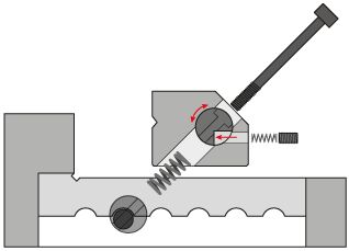

            yes had the same damage – it’s something to do with the initial position of the jaws wrt to the tightening nut – my solution was always to push the jaw up to the item then tighten

              Sounds like you are tightening it too much in the wrong notch, better to slacken off screw and move the bar in one notch then the screw won't go in a far when tightened

                … if so, it would appear that all you need is a thicker [and/or better fitting] washer under the screw-head.
                Edited By Michael Gilligan on 19/11/2019 08:14:10
                #437907
                  Funny enough Michael I've just been down to look at the one I have from ARC. If I tighten the screw right up with nothing between the jaws it protrudes less than 1mm but that would not be gripping anything as the force is more vertical than horizontal. The smaller 30something wide one that I have has about 5mm between end of screw and base
                  Cure would be 1mm off the end of the screw o as you say a small OD washer turned up and slipped under the screw head or better still get the feel of when the bar is correctly engaged
                  Edited By JasonB on 19/11/2019 08:19:56

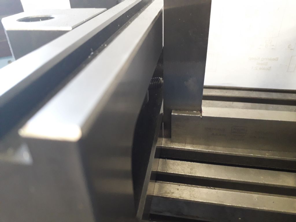

                      Presumably this phenomenon is only possible on the two largest sizes of vise?
                      My 70mm version does not appear to be able to cause any protrusion of the tightening bolt below the frame. The bolt appears to be forcing the spring against the edge of the movable jaw (ie the angle cannot be such that the bolt can point ‘down-hill’ excessively.
                      It also appears (but not confirmed) that the spring might well become coil-bound before any problem could arise.
                      Certainly a shorter bolt would avoid the issue (there should be enough thread within the tightening bar – unless the spring needs extra length to avoid becoming coil-bound?).
                      The only gripe with mine – apart from the more awkward/extra clamping arrangement needed, for attaching to the mill bed – is that the tightening bar needs relieving to allow the vertical V to accept longer items.smiley Oh, and it seems to be slightly magnetised.
                      I’m also surprised at Arc’s alleged response of requiring 3 reports before investigating the issue.
                      Perhaps not the simplest of vises to operate, but I like mine, all the same.

                        yes had the same damage – it's something to do with the initial position of the jaws wrt to the tightening nut – my solution was always to push the jaw up to the item then tighten
                        That is the intended method of use, rather than the solution.
                        Our Brett tried to explain this to Phil….
                        Before our engineer (now retired) explained how to use the vice in the correct way to Brett (his apprentice at the time), he had similar problems.
                        Phils's is the first and only complaint we have had regarding this vice.
                        It is difficult to explain this without sounding arrogant or patronising. ARC sells enough of these vices to consider this to be a 'how to use' issue. At the same time, we are aware that some customers will fail to agree, or simply not get on with this particular type of clamping arrangement. Some of them prefer the Type 3.
                        To clarify the point about 3 reports… yes… ARC only considers it to be a problem – especially for this product range, if it receives 3 valid complaints in a row, 'within a short period of time', at which point we will evaluate the item to see if it is indeed a 'product fault' or something else.
                        Ketan at ARC.

                          I don't own a Type 2 Precision vice, but seeing the construction, then on then face of it, I could imagine that the screw / nut bar / moving jaw is too far from the workpiece, This would need the capscrew to be rotated too many times to clamp the work, so that it protrudes too far through the "nut". Any thread protruding through the nut is not doing anything!
                          As long as the capscrew has one diameter, or only slightly more, engagement when fully tightened, there should be minimal risk of damage to the threads or to the machine bed.
                          May i suggest slackening the capscrew and moving the bar /moving jaw forward one notch and then tightening, to see if this keeps the end of the capscrew clear of the bed?
                          Since you seem to be in a small minority in having this problem, then it is worth examining the the methods used to operate the device. Unless by some very odd chance your capscrew is too long. This is unlikely, since they are probably made and bought in by the thousands for this vice.

                            Is the problem caused by not being sure that the screw is fully unscrewed before the jaw is slid up to the work and then tightened? I would guess that losing the nut would be irritating as the vice would need to be removed to refit the nut and then need trueing again. Would it be useful to rivet the end of the screw to stop accidental release or rivet a small washer to the screw end to give a positive stop when fully unscrewed?
                            Mike
                            #438066
                              The end of the screw does need to go right inside the nut so anything on the end won't work and will also make it longer.
                              The user needs to get into the habit of slackening the screw first and making sure that it is fare enough out without undoing it too far. A 6" or 8" tee shaped key helps here as it is easier to see the angle and make sure the head of the screw has pivoted down to the bottom of the hole in the moving jaw. You then as Francis says slide the jaw upto the work and tighten.

                                I see Jason, it does seem to be just an issue of being careful where you start from, the long key sounds a useful tip.

                                                  I have only had my mill a couple of months. I noticed a mark on the table when I moved my vice a few weeks ago.
                                                  I just had another look after reading this thread, and I can see a number of marks.
                                                  I suppose I should be pleased that now I am aware of the issue.

                                                      Ian, 18 months ago the same dings happened to my shiny new mill table, most annoying, I shortened the bolt by about 6mm
