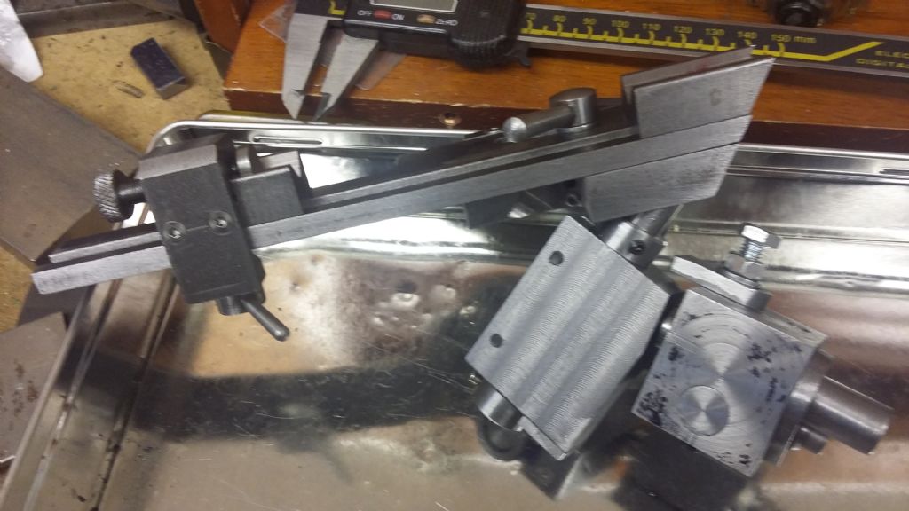

            Made one this last winter

                The plans don't really give a good clue as how advanced the front end should be in respect to the pivot point where it intersects the platform. went for the conclusion that a zero diameter drill would be ground at a zero radius with a zero degree relief angle..
                Just took a few photos of the business end, can be found in my flickr album: https://www.flickr.com/photos/139032632@N06/albums/72157664126081755/with/27730070505/

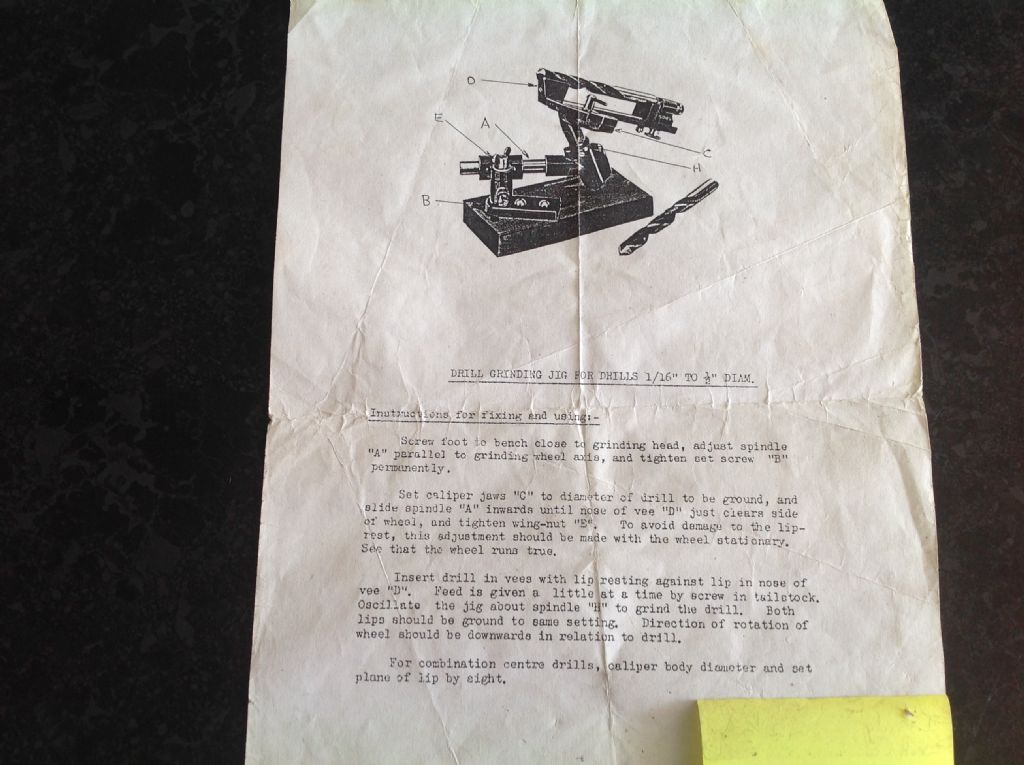

                        Hi Roger/Bill, my apologies for not responding sooner. I tidied away the drawings for the Potts jig some time ago and it's take a while to find them. Also this is my third attempt at posting this reply.
                        Roger I struggle with Yahoo groups. I thought that as I was a member of the Drummond lathe group I would be able to get to the link you posted. Unfortunately not, I have to be a member of the Quorn Owners group as well. If all else fails I'll pursue that. Thanks for posting the link anyway.
                        Roger here is the detail of the detent as per per the drawing from Wokings:
                        As for the instructions:
                        Hope these are of some help.
                        Regards, John.

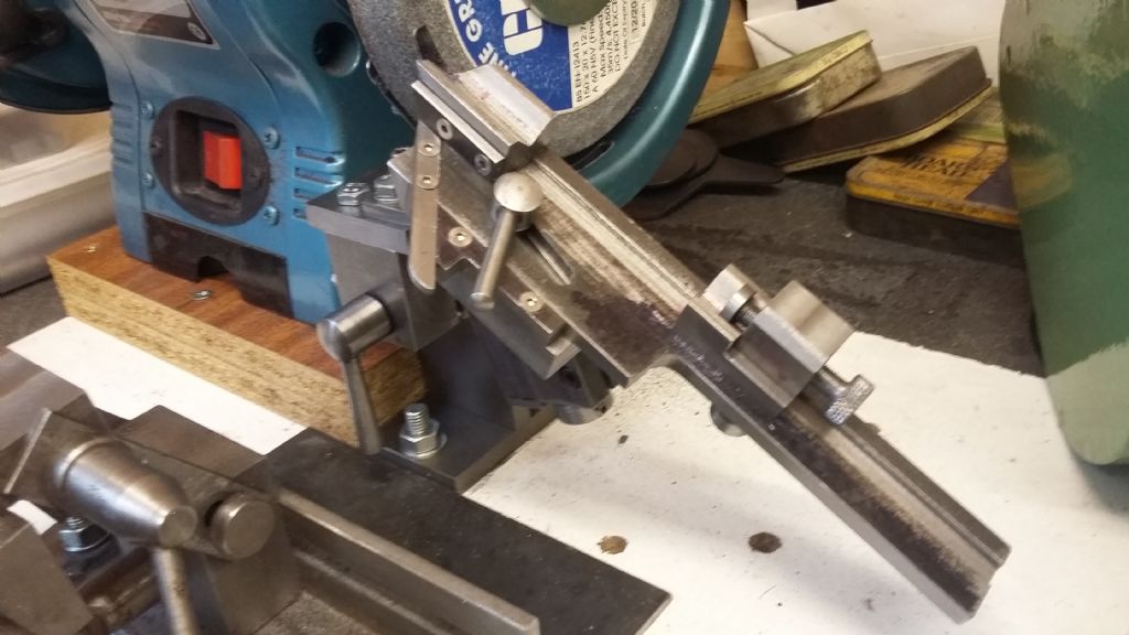

                                  I finally made a copy of the drill grinding jig from Model Engineer from the 50`S ? Not sure if this was the Potts or not? It has a fair bit of engineering in such a small item surprise
                                  Odd thing is, I can actually hand sharpen fairly well. But the fun is in the building I guess laugh
                                  Anyway I just need to make it look fancy (or not) and it does seem to work ok.
                                  Oh, the guard is now back in place cool Just needed a little trim angel
