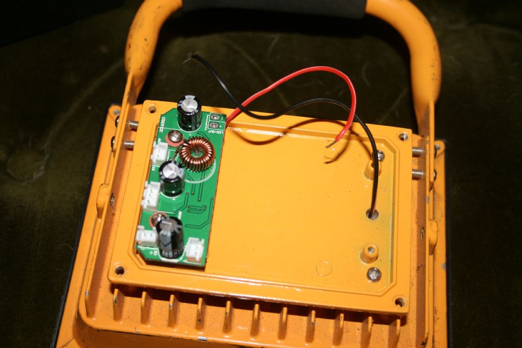

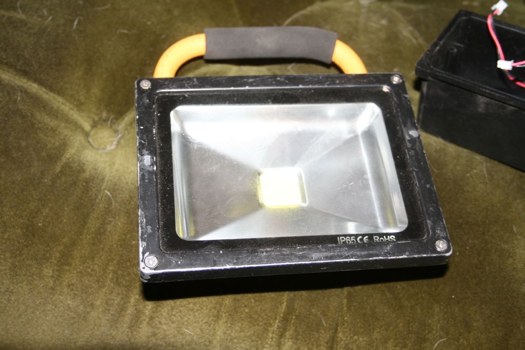

      Evening gents . A couple of years ago i bought 2 of those yellow portable rechargeable led work lights . A cheap one from Screwfix , and a fifty quid one from the newly opened Led lighting shop.. Guess which one still works ? Yep ,the cheap one !! The other one doesn't charge properly , or runs out of juice quickly anyway.. So rather than chucking it away , and assuming the "bulb" is ok , I thought maybe i could run it on a cable, to another battery ..but what voltage ? About 3v innit for leds ?? After a little dismantling , there's a circuit board in it too. surprise
      There's a red wire and a black going to the "bulb" , but connecting them to two AA cells doesn't make it work !! ? Does it need "special electric" from that board bit ? I'll take some photos in a minute .

            If possible I would put it back together with the original electronics and measure the operating voltage. Alternatively connect a variable voltage power supply and increase the voltage to an acceptable level of brightness, taking care not to cook it. Michael

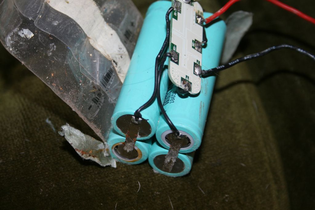

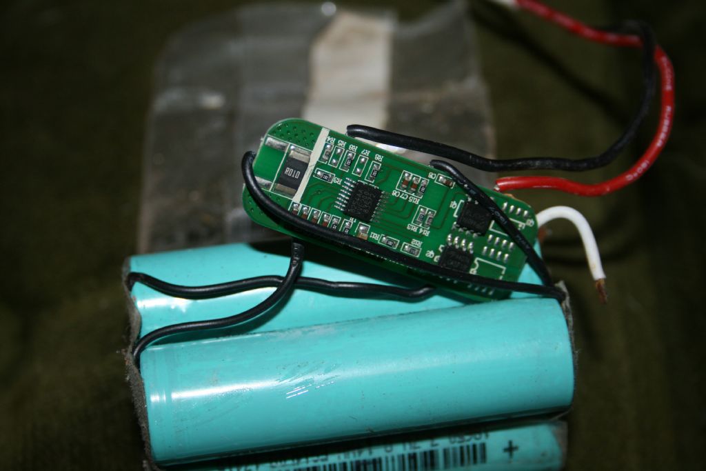

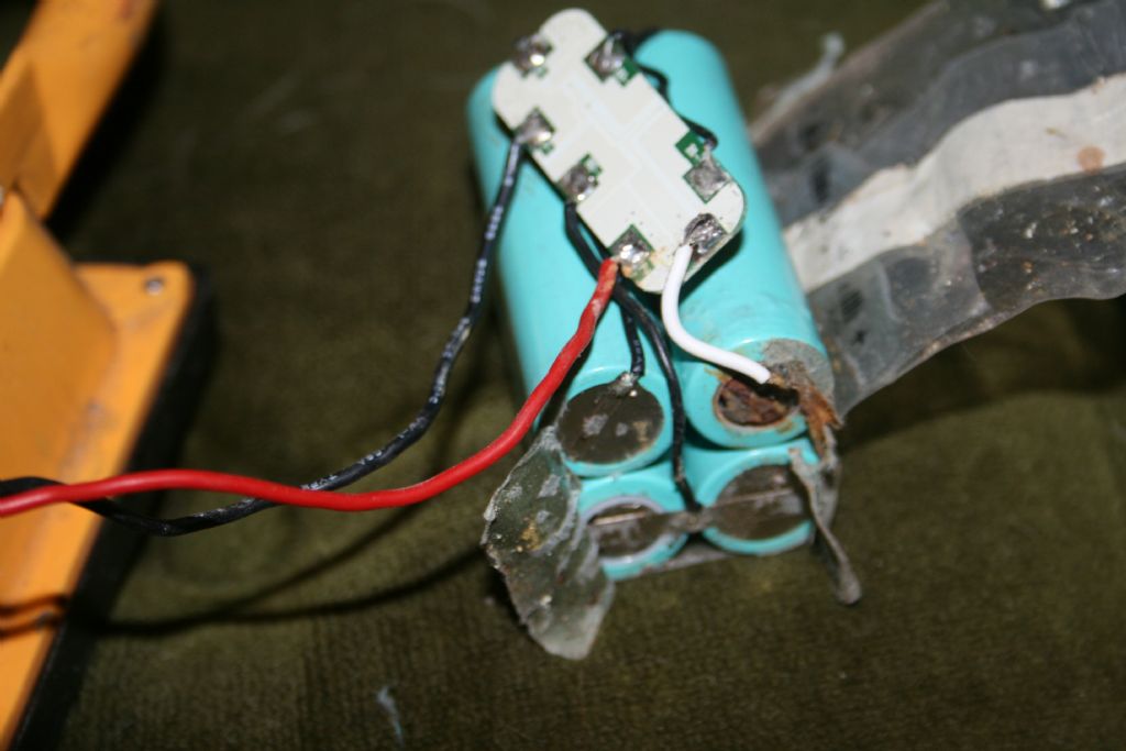

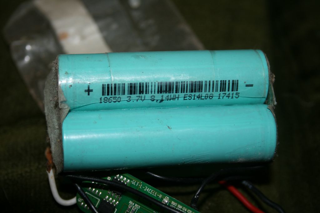

                    I took it apart a while ago..having had a rummage i've found the battery ..cells are 3.7v ,i don,t know if they are in parallel or series …and it unwrapping it reveals yet another i.c.!

                        Looks like series connection to me so you have 4*3.7 = 14.8v. The circuit board(s) probably deliver a constant (switch mode) current, connecting 14.8v direct to an LED without a series dropper resistor would release the magic smoke. You could try connecting the wires which now go to the batteries to a car battery, if it then works you have duff batteries, if not you have a duff circuit board. Both are repairable, but is it worth it? Make sure it is connected the right way round

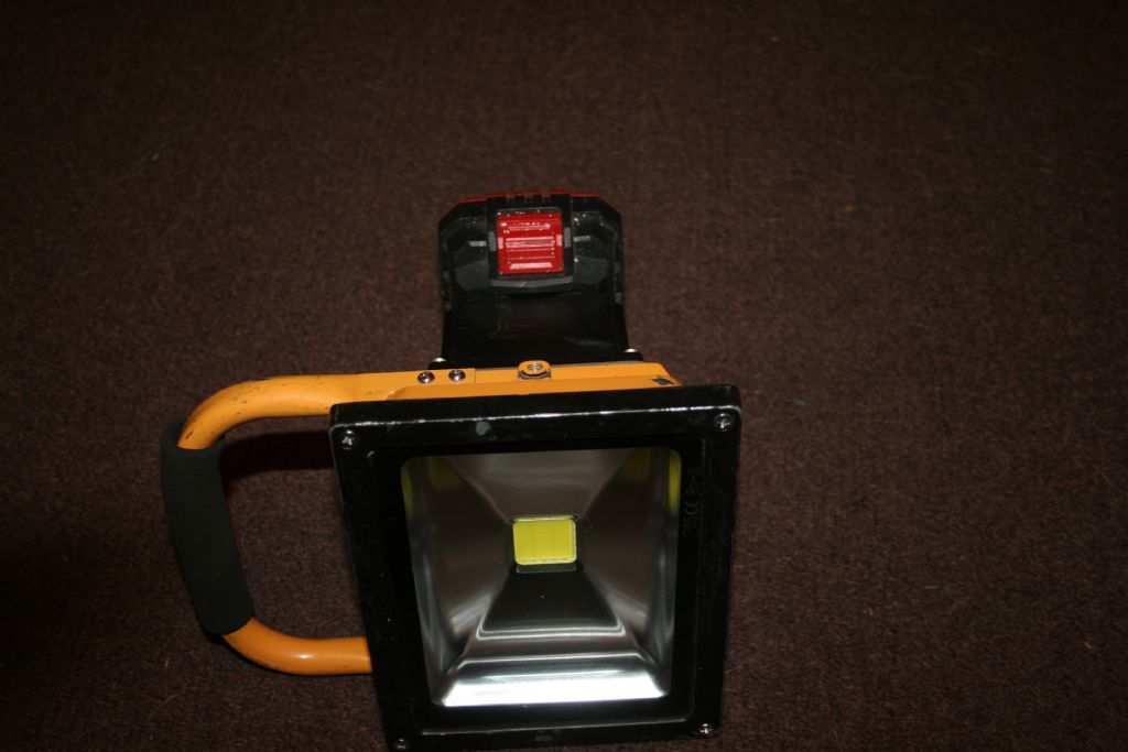

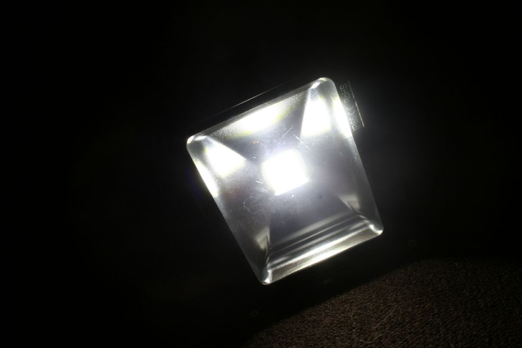

                          They are bright , no doubt about it , but it's a horrible cold light .. The warm white gu10 led in my kitchen is a much nicer light . I want ideally , to have it on a lead , with croc clips to attach to a 12v lead acid , Just not sure what voltage the bulb would be ..I didn't want to pop it trying !

                            Those are 18650 cells. eBay job, but buy the best ones you can. Should be an easy repair

                              LEDs are current driven (+ need a limiter unless you like a well lit but very fast puff of smoke) unlike old tungsten wire bulbs which are voltage driven – those LEDs marked as 12V etc for in-car use have an internal current limiter – likewise LION cells are relatively cheap but can(ie usually will) explode + catch fire if charged in wrong way (that’s the function of the circuits seen on the board – it measures voltage of cell + adjusts charging as appropriate) – shorting the cell is an extreme fire risk unless the cell has an inbuilt circuit to limit output current

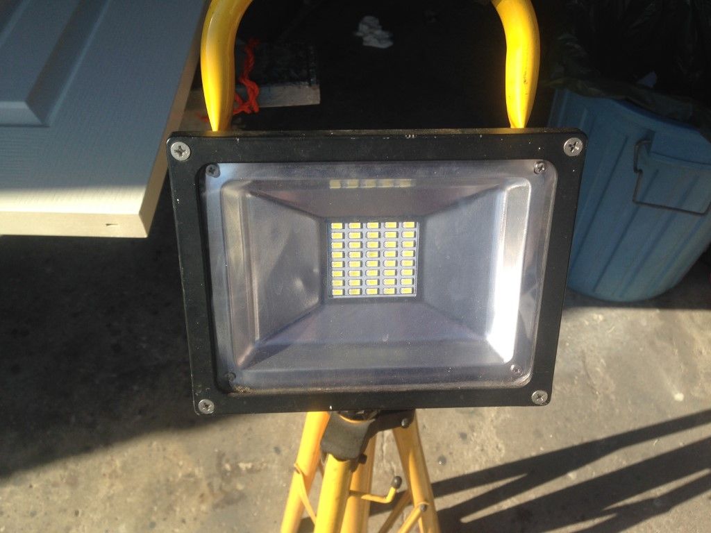

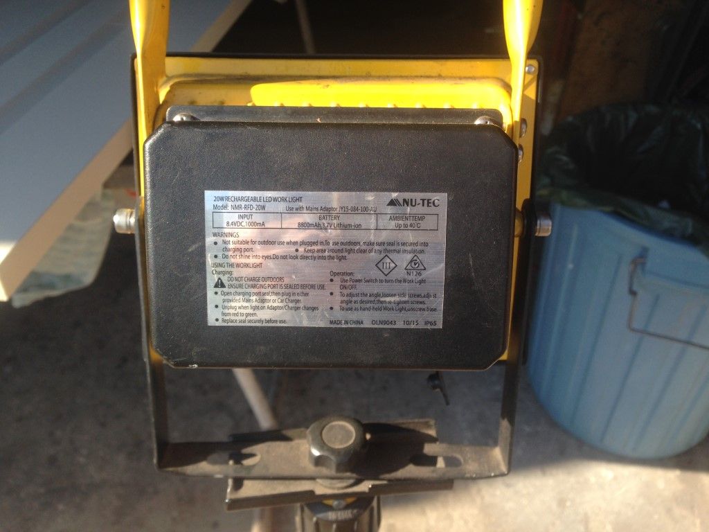

                                The light looks similar to the one which I have. Label on the back says that it has a 8800 maH, Lithium-ion battery and the charging input is 8.4VDC, 1000mA

                                    M.B , D.W . and F .I. thanks for the info on the constant current requirement .. yes

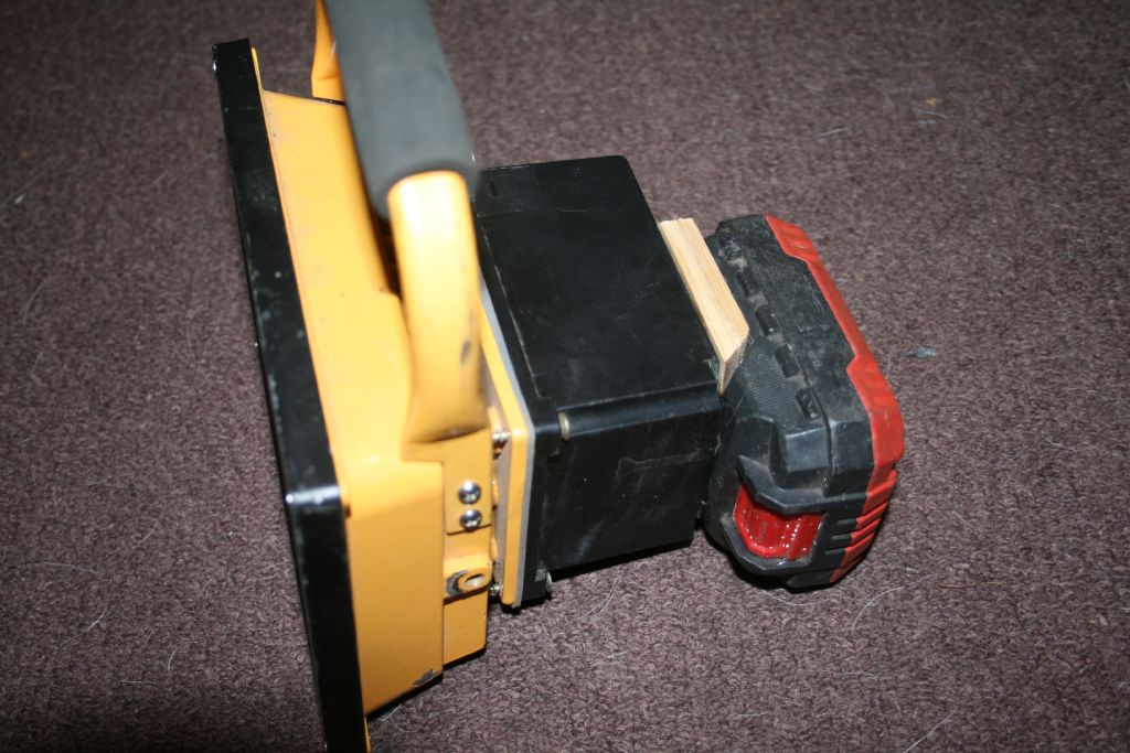

                                    I have , (by re – using the circuit board bit ) and reconnecting the wires , hooked it up to a 16v drill battery ….And it works !! laugh .. And the drill battery recharges in only an hour !
                                    I've chucked the old battery pack on the bonfire…as its nearly Guy Fawkes night anywaydevil

                                        +1 and while the 'nominal working voltage" is 3.7V (minimum discharge voltage ) the fully charged voltage is 4.2V

                                            Thanks chaps , i know you'd have milled out a perfect flange to slide and lock the battery pack on .
                                            I'm a cowboy, so i made it from wood, polymorph ,banana skins and bogies…but it works cheeky tesco nos 010.jpg
