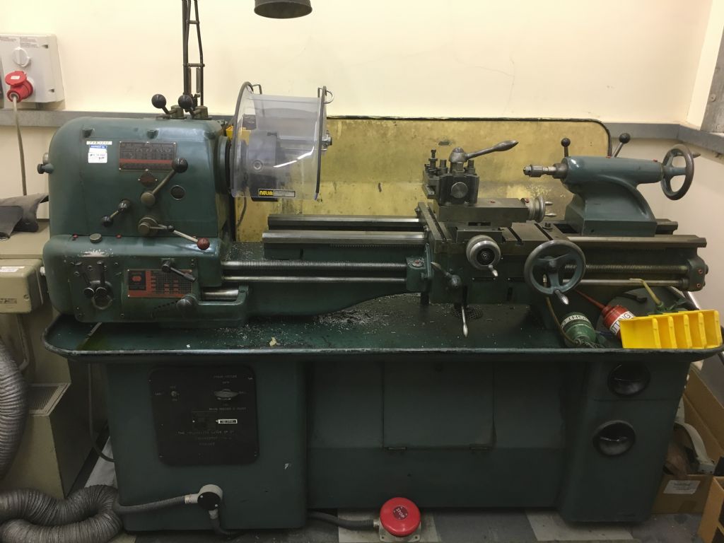

      A local electronics workshop was looking to clear out a couple of machine tools before Christmas, fortunately the manager sold them to me at a reasonable price – knowing they'd be going to a good home – before a trader swept in. Hence I had little time to do any detailed research on the model/features etc.
      I know round head Colchesters in good knick, are well worth hanging on to. No paperwork came with it.
      Therefore please can someone confirm whether this is the Master Mk1?
      Secondly, is this style of collet the correct fit for this model since the seller and I aren't sure!!
      (image taken from this fleabay auction: https://www.ebay.co.uk/itm/Colchester-Master-collet-chuck-and-assorted-collets/292498379255?_trkparms=aid%3D111001%26algo%3DREC.SEED%26ao%3D1%26asc%3D50427%26meid%3D1840c4187eb04781ae2b6aea631025ed%26pid%3D100678%26rk%3D1%26rkt%3D4%26sd%3D292498379255%26itm%3D292498379255&_trksid=p2481888.c100678.m3607&_trkparms=pageci%3Afe34cbcd-3424-11e8-8df9-74dbd1809eb6%7Cparentrq%3A7744ad111620a8845999abd3fffb29ab%7Ciid%3A1)
      Thanks in advance.

            Posted by Brian Sweeting on 30/03/2018 15:32:51:
            Looks like a mk.1.
            See here
            http://www.lathes.co.uk/colchester/page2.html
            **LINK*
            Thanks Brian. I did skim those webpages. But I found it hard to discriminate between the Master Mk1 and Student Mk1 – is it simply a longer bed?
            #348147
            Ian Parkin
              @ianparkin39383
              A student should be 6” CH a master should be 6.5” CH
              Having said that apparently colchester made most students 6.5” without changing the badge which states 6”
              Masters were always 40 “ Between centres rather than 24 for the student
              Its also a mk1 as it has the sliding handle for cross and longtidunal feed
              Mk 1.5 ‘s have a lifting knob and a separate knob to cross and long
              Mk 2 would be square head
              #348148
              Ian Parkin
                @ianparkin39383
                That collet set and chuck is good for that lathe
                Its a bernerd multisize set on a LO taper fitting
                #348203
                Brian Sweeting 2
                  @briansweeting2
                  Posted by choochoo_baloo on 30/03/2018 15:39:13:
                  I couldn't see the gearbox lever on the mk.2.
                  #348220
                  sean logie
                    @seanlogie69385
                    Looks just like the one at my work ,and it's a Colchester Triumph 71/2 .Great machine .
                    Sean

                      #348413
                      thaiguzzi
                        @thaiguzzi
                        I also thought Students had the apron hand wheel on the left and the Masters on the right?
                        My Student was 24" between Centres and my Master 36". 6 and 6.5" centre heights.
                        The Triumph was always the Biggie.
                        #348415
                        Ian Parkin
                          @ianparkin39383
                          Hand wheels depend on whether a gap bed or not same on both models
                          #348729
                          choochoo_baloo
                            @choochoo_baloo
                            Thanks all for the input. I agree it has to be the Mk1 Master.
                            #348733
                            thaiguzzi
                              @thaiguzzi
                              Posted by Ian Parkin on 01/04/2018 16:22:22:
                              That would explain my straight bed Student having a L/H apron hand wheel and my gap bed Master having a R/H apron hand wheel….
                              Always preferred the L/H handwheel, seemed in the "proper" place…
