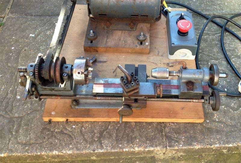

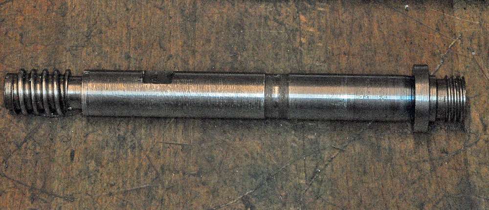

                            A few years ago I bought an old Flexispeed lathe that had been used without a countershaft i.e. it had a direct drive from the 1400rpm motor to the lathe pulleys.
                            as bought 1
                            This is what the unhardened spindle looked like:
                            old spindle
                            Severe wear and scoring at the chuck end.  The headstock itself though was un-worn so I made a new spindle.  The Flexispeed manual stresses a maximum speed of 1000 rpm, and that’s for a spindle of only 1/2″ diameter.
                            Rod
