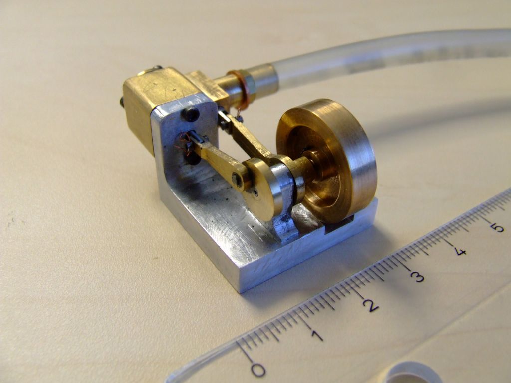

                    I have built a metric version of Phil Duclos' Huff and Puff breath powered engine with 6mm bore and 6.3mm stroke. The cylinder and piston are brass and the piston rod and piston valve are ground stainless steel. The build log is on the Model Engine Maker Forum but you need to be a member to see the pictures.

                          Piston fit? This will depend on the pressure you intend to run the engine at and the friction/load on the system. I reamed the bore 6mm and turnêd the piston to a close fit so without lubrication (other than residual cutting fluid) it would fall under it's own weight with an open cylinder and fall in about 10 seconds with a closed cylinder. With light out applied the piston just stayed where it was.
                          If this link works this is the piston sinking in a closed cylinder:
                          **LINK**
                          and this is the engine running:
                          **LINK**
