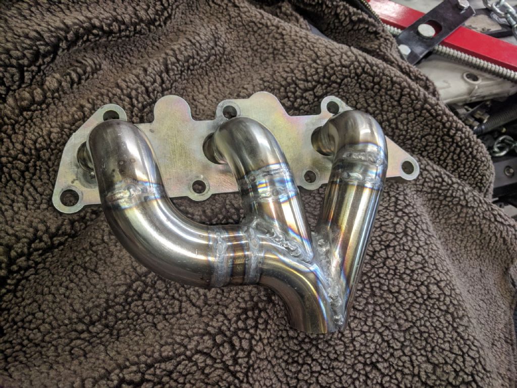

                                            Nick Wheeler
                                              @nickwheeler
                                              Posted by noel shelley on 14/02/2021 13:19:08:
                                              Chris has illustrated the point very well ! 12mm od tube 1.5mm wall for it's diameter is quite thick wall. At that OD and wall it would bend nicely hot or cold. But try 25mm OD by 1.5mm wall – then the fun starts, and IF you want it to look pretty then forget exhaust pipe bends as well. There is NO easy way to bend thin wall tube and have it look nice UNLESS your going to spend BIG money ! Noel
                                              Anyone who has made custom exhausts will know that mandrel bent stainless bends are easier to find and much cheaper than mild steel.
                                              That's most of a header for a Vauxhall V6 in an MGB
                                              #527157
                                              noel shelley
                                                @noelshelley55608
                                                Yes Your right ! I use 4" for marine exhausts ! If I could get a cummins 903 into a B I would need 4".
                                                BUT the OPs question was how to bend thin wall tube himself. Noel.
