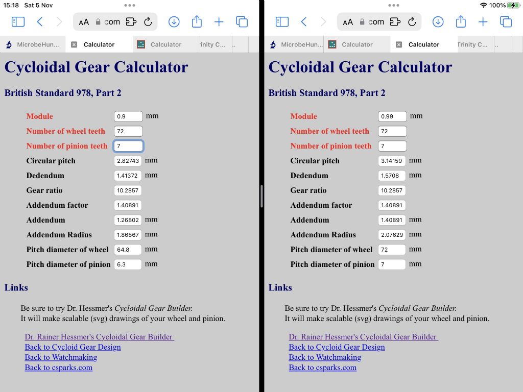

                            You might find it useful to have a look here: **LINK**
                            https://www.csparks.com/watchmaking/CycloidalGears/CycloidCalculator.html
                            Obviously, you will need to run the calculator twice … once for each module
                            … on each occasion, ignore the irrelevant answers.
                            The final ‘physical’ optimisation of the mesh is [with cycloidal gearing] done by depthing.

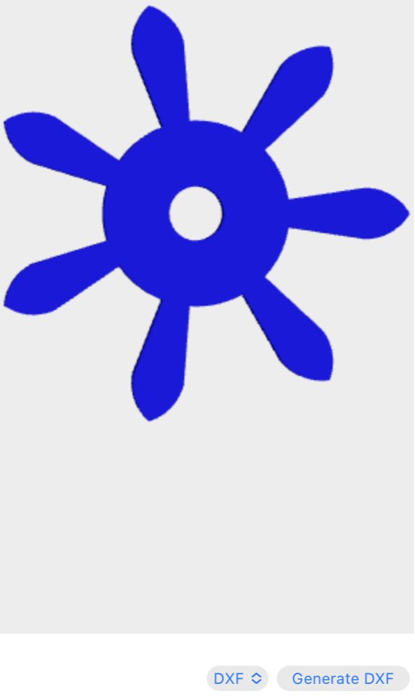

                              I tried Dr Hessmer’s page …
                              it’s not really optimised for viewing on the iPad, but I did manage to grab this:
                              Hopefully, that looks reasonably familiar.

                                    For reasons best known to itself, the calculator that I linked falls-over with Module=1
                                    I have therefore used Module=0.99 for the bigger cutter.
                                    A quick check through those numbers should inform your choice of cutter, Andrew
