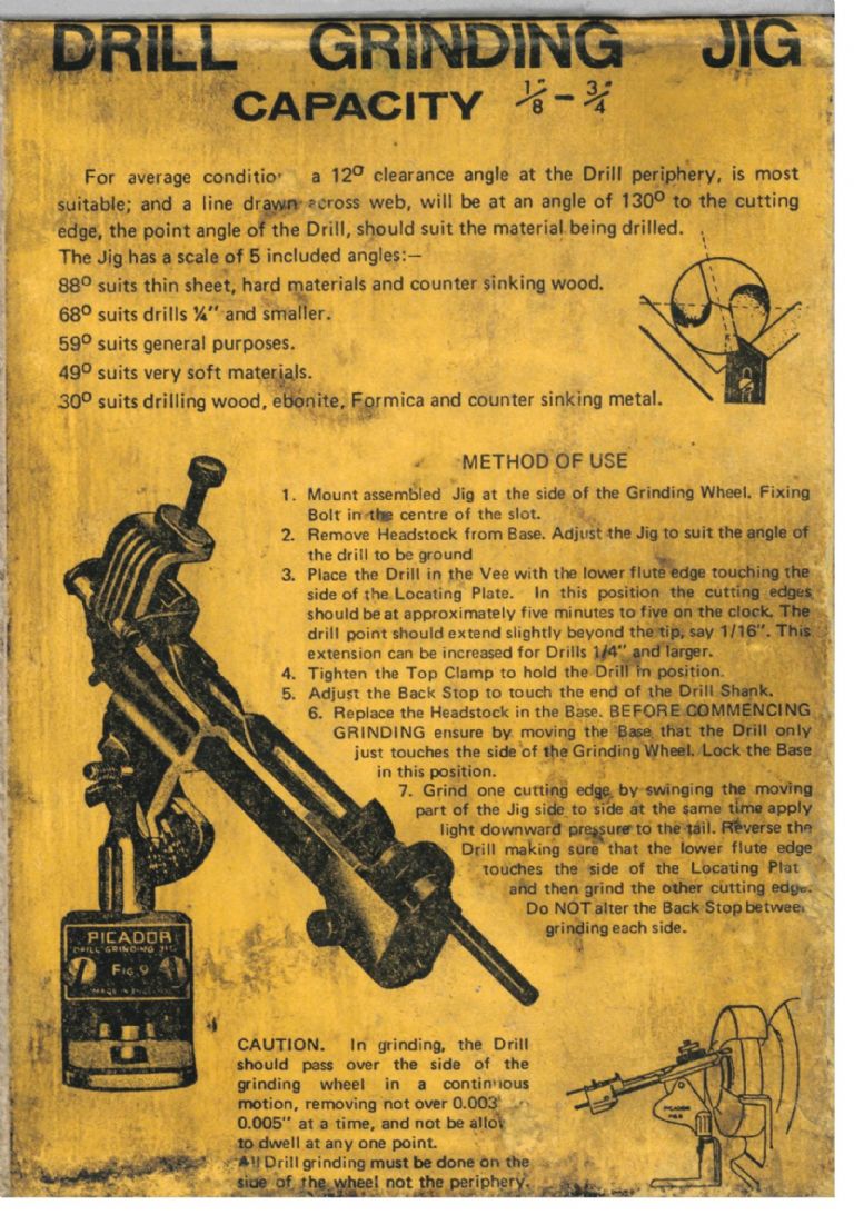

            Just in case anyone wants to see the instructions from an original Picador box this is from the front of mine…
            I really need to make a new foot or modify the existing as there is quite a bit of slop that has developed over the years due to the Picador nameplate wearing and bowing slightly, I tend to compensate for it, another round-tuit jobs!
