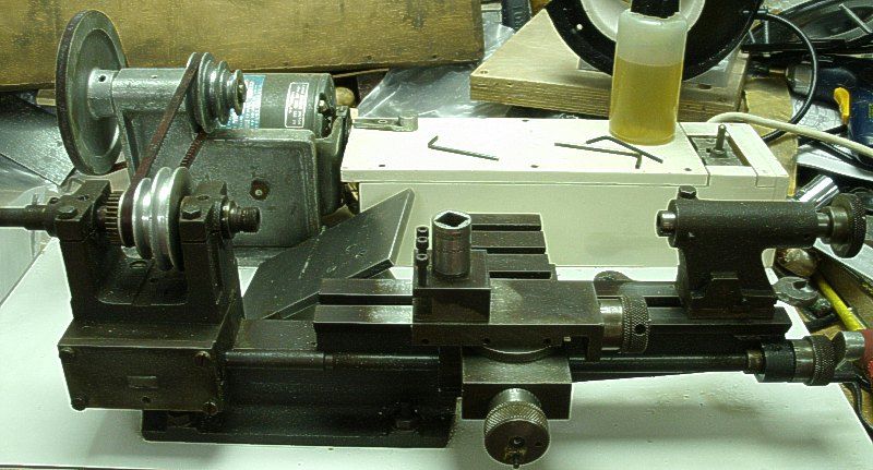

        I recently acquired this small lathe – looking at http://www.lathes.co.uk I think it is an early model of the SL90 – no back gears however but has box to add dog clutch – judging from lack of any paint suspect it is a self assembly model – it came with a reasonable set of tools – the base for a small saw table can be seen. (the socket head on the tool post is not original!)

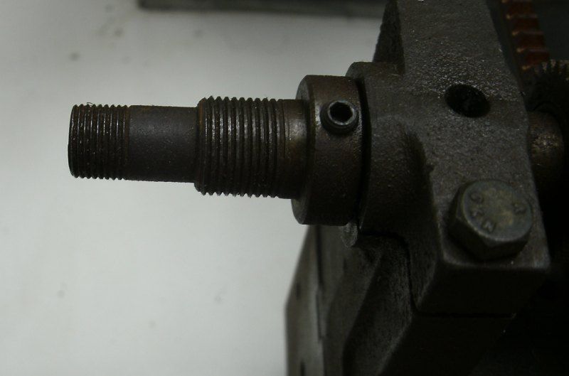

        the other end of the drive has what appears to be a 1/2" 26tpi + 3/8" ? 26tpi – any confirmation would be welcome (two threads for which I don't have taps or dies)

          Nice find, Frances
          Some [albeit not that many] similarities with my 'Jason' lathe, which was also designed by Brian Perris.
          … The dog-clutch would be a useful addition.
          The mandrel rear screwthread on the Jason is 1/2" 20tpi [unified], which was a surprise. So I can't help with yours.

            The motor is a 1/4 hp (approx) made 1971 with reversing switch but on a hinged plate so that motor weight aided by a spring tightens the belt (would have expected a 5mm circular but uses a flat toothed belt (as also does one illustrated on lathe site
            haven’t tried any cuts yet but motor (even uncoupled) seems to have some 1second period vibration

                The spindle threads are 1/2" X 26 TPI and 3/8" X 32 TPI. These threads still exist on the Cowells ME90 lathe spindle.

                The lathe was available as a number of variants, the plain lathe, which is the model that you own is the basic one. Owners could add backgear and fine feed with the dog clutch to end up with the version seen in the brochure. Screw threads are a complete mix of BA, UNF / UNC, and imperial. Cowells metricated everything virtually as soon as they took over.
                You do get the impression that Brian Perris was living from hand to mouth, but the machine that he designed is still in production as the Cowells ME90 machine, forty years later, which says something for his ideas.

                  Thanks Michael – I’ve made the dog clutch but needs a little more to finish it off once I return to UK – decided to make a new Perspex coverplate as one intention is to use lathe as a simple demo lathe and thus people can see immediately how it works – will check out the #10 UNF – don’t think I have taps/dies for this – I did cut a new 2BA and that seemed to work but recall it was a little loose which I put down to wear (as you say a right mixture of threads – maybe best logic was that he used what he had available! – 6mm + 1/4″ also seem to be a random choice) – I’ve started to replace the handles with brass (to match its new paint job in GWR green) which allowed some small thrust bearings on leadscrew – I suspect the tailstock handle has been thumped in storage as the cheap looking ali handle was broken and there is some slight catching as though tailstock screwthread is slightly bent.
                  I looked at Cowell’s prices! – suspect I’ll do without the gears unless I can get enough 2nd hand + not think of screw cutting though tempted to had small stepper motors to cross slide + leadscrew so can cut small tapers etc and as neat demo of CNC
