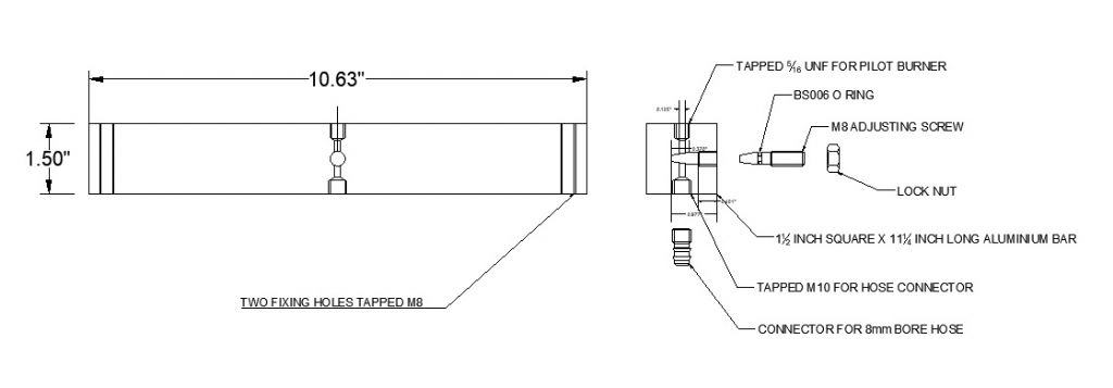

        I could do with some design help, please.

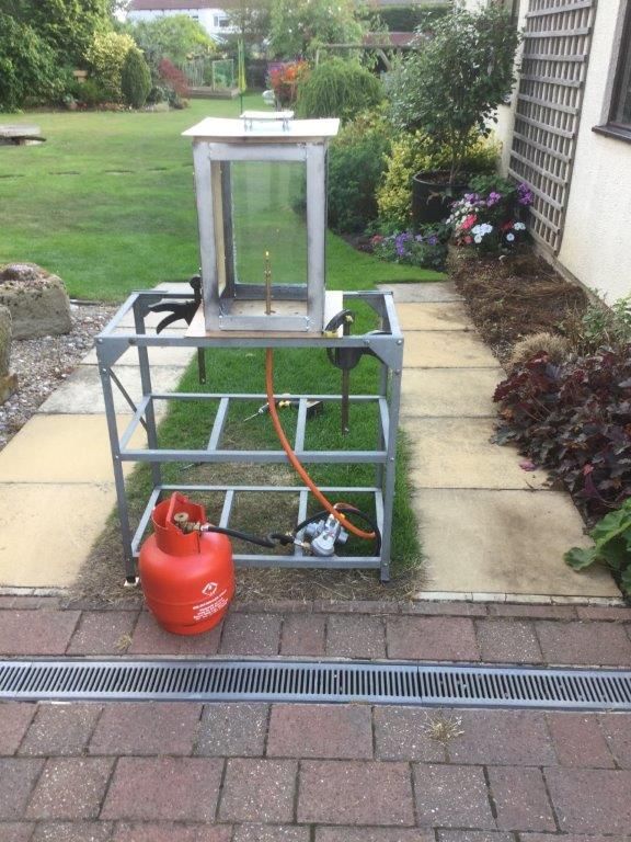

        I'm tasked with producing a propane fired peace flame for the village. The enclosure will hold two 3.9kg propane tanks with an automatic changeover valve that switches to a full cylinder when the first is empty. The valve incorporates a 37mb regulator. We have been given a ruby pilot jet from a portable gas heater.
        When fed from the 37mb regulator, the flame from the pilot is too large and will consume too much gas. So I produced a manifold with a tapered screw to throttle the gas flow and reduce the flame. Here's the drawing of the manifold:
        The problem is that the adjuster has to be screwed in tight to get the flame down to what it needs to be. I was disappointed that screwing the screw in tight does not completely shut off the gas flow and it is very sensitive. Screwed fully in, here's the flame produced:
        The flame size is about right but I want a finer adjustment. Can anyone suggest a better design for the throttle that will completely shut off the gas and allow fine adjustment at the very low pressures and flows pertaining?

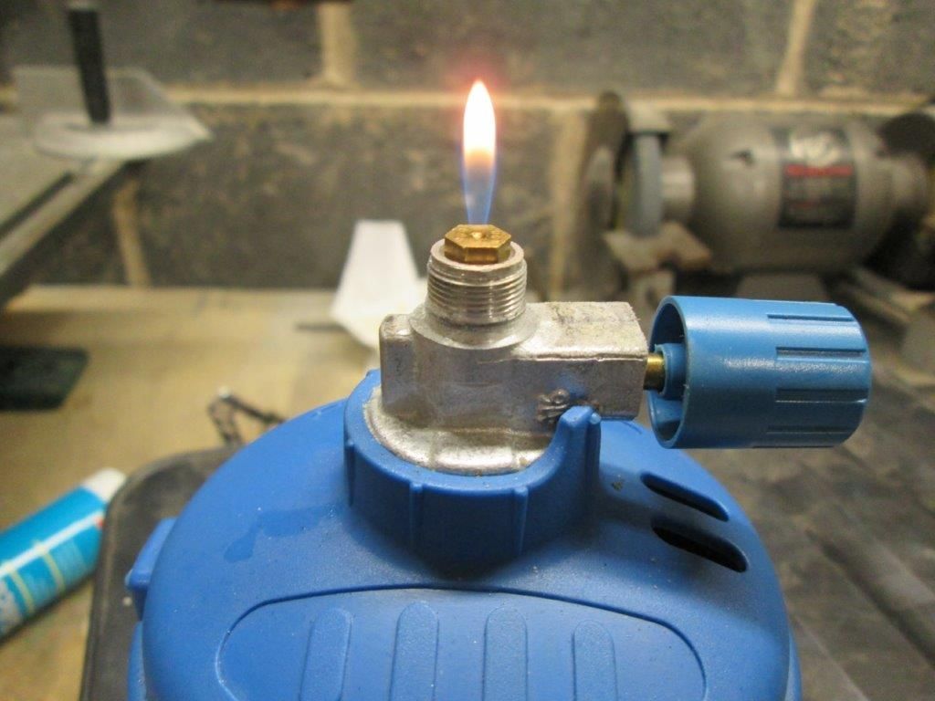

                Thanks for the replies. Following Jason's suggestion, I took the burner off a butane stove and lit the jet. The control knob is just what I want. But how to get it apart to see how it works without wrecking my stove?
                I assume the valve is seeing the full vapour pressure of the butane (about 30 psi or 2000mb).

                    You're using an M8 adjusting screw! I wouldn't use that to regulate the Niagra falls. (model)
                    You want to look at the throttles for a model aeroplane engine which use a fine needle and a fine thread.
                    Get yourself two fine sewing needles one the smallest you can and the next a bit bigger, but not darning needle size. Make the small one into a small drill by grinding off the end and then grinding it into an elongated chisel shape.
                    Drill your brass valve seat almost through with the smallest drill you can find and not break. Then finish off the last 20 thou (half mm) with the needle.
                    Thread the body something like M2.5 or 6BA and drill a screw so that you can fit your larger needle in it.
                    The gas is of course going though the hole not across it as you have in your prototype and the needle is downstream so thread sealing is less of an issue.
