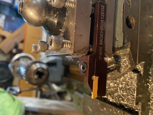

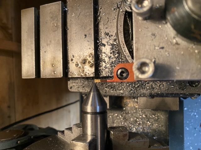

      im having a bit of a nightmare using this new parting tool that I bought from arceurotrade.
      I haven’t been able to part properly with it yet and have already broke the original blade, good job I ordered a spare with it. I’ve tried all 3 speeds of my Myford ml7 lathe, still without any good results, just keep getting chatter or the chuck stopping and wedging into the tool, thats how I broke the blade that came with it.
      as you can see in the photos, the blade is spot on the centre cutting height, it’s an 8mm by 10 tool holder and lines up perfectly, so I can’t understand why it’s not cutting through properly.
      hope someone can tell me what I’m doing wrong, would I be better using a Hss parting tool instead.
      thanks

          Worn headstock bearings is one thought. Noel.
          #608309
            I would not trust a MT shank held in a 3-jaw to be on ctr height. Put it in the spindle taper or try against the tailstock ctr

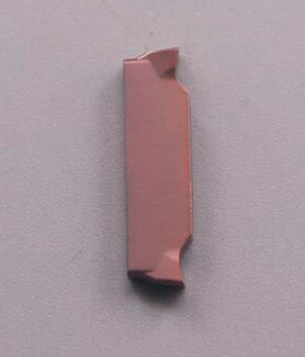

                Admittedly, in a rear toolpost, but for parting off I rig up a fairly steady gravity fed drip feed of lubricant for my ancient HSS blade.
                I tried a carbide parting tip in the front toolpost, and had just the problems that you have, so reverted to the inverted HSS blade in the rear toolpost.. (And the swarf falls out so that bit does not clog)
                I made a rear toolpost for my ML7 and then had fewer problems parting off.

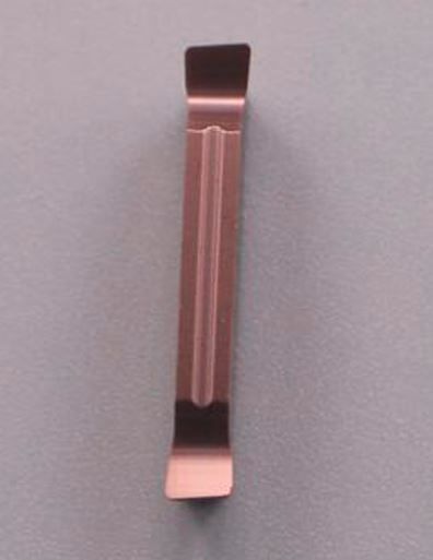

                A carbide tip SHOULD produce two streams of swarf, from the grooved top, so should not clog.
                It works so well for me that I now use PCF (0.0025"/rev ) when parting off, because both are narrower mthan nthe cut.
                Daft question, but the tool is square to the axis, so that doesn't rub on the side of the cut?
                You do need to keep up a steady feed, so that the tool cuts rather than rub.
                May be, being carbide, it needs high speed and feed to generate heat at the cutting edge, to soften the metal.
                Don't know what you are cutting, but the swarf looks a bit small for steel, or is it cast iron?

                  A centre held in a 3 jaw WON'T be on centre, unless myou nhave an exceptional chuck.
                  It is likely to run out by anything up tom 0.005" on a reasonably good chuck, more non a worn one..
                  You should set to a centre, located in the 2MT bore, and recently trimmed up.
                  Use a 2 MT centre, not a parallel one in a 3 jaw!
                  You would spend time profitably, making a Centre Height Gauge, It would aid setting tools to centre height considerably.
                  This might be part of your problem! (Looks to be on centre but may not be . If too high will cause problems)

                    Personally I wouldn't use a tool like that for parting off. They're more of a grooving tool. Carbide parting off inserts will chatter badly if the feedrate is too low. I use power cross feed and a absolute minimum of 4 thou/rev. If you're not confident to let rip then HSS is more forgiving.

                        Posted by Howard Lewis on 03/08/2022 18:34:22:
                        I wonder whether you could put that in a formal letter to Greenwood Tools (RIP) and the Sandvik Corporation Ltd, Inc. LLC, etc. Maybe cc. Messers Iscar, Kennemetal, Korloy, etc.
                        My Q-cut parting tool, a fine example of a parting tool with a grooved top, has only ever produced a single stream of swarf for in excess of ten years now.
                        Having now seen your quite astonishing revelation, I feel cheated. Do you think I should demand my money back?
                        Kindly draw me a picture of how this phenomenon should occur please.

                              Re set the tool so that it is 5-10 thou above centre. 5 thou should do, but if the tool and compound are dipping with load, the higher amount might be needed. .
                              This is more important with carbide parting inserts than with HSS. The very last thing you want is for the work to climb over a carbide parting tool. Instant failure.

                                Check that the tool os running true to the run of the slide. It needs to be like no more than 1 thou or 0.03mm per 20mm of travel. Also assuming that the top slide and the compound slide don't have sloppy gibs. That looks to be the multi direction turning insert, rather than the Parting specific insert. The difference is the the top rake is positive and a sharper front end with a geometry that curls the chips better. As Jason said, a feedrate of about a thou per rev and upto 45mm in diameter under 500 rpm works, but at around 250 rpm, coolant does not go everywhere. It needs plenty of coolant for best results. Parting tools should be on centre to slightly above. The reason for the success of rear parting holders on older machines, is that as the tool tries to lift, the slop in the gib tightens the gap, making it more rigid.

                                    As Mark Rand says, carbide parting off should be above centre height. I have read the instructions from Kyocera and Kennametal and both state that the tip should be 0.1mm, 0.004" high when parting solid stock.
                                    I never part with anything but carbide inserts and have never seen two streams of swarf coming off. The profile of the tip makes the ribbon curve longitudinally like a length of rainwater gutter which is then narrower than the width of the cut.
                                    Any loosness in gibs or flexibility make parting much more difficult. I have a solid block with inverted blades which bolts directly to the cross slide and together with front and rear saddle locks, is used for the most challenging parting.
                                    A four jaw independent chuck and the minimum work overhang also help.

                                      I do parting at 800 RPM, 0.02 mm/rev, use lubrication and the powerfeed. I have 1.2 mm HSS and 2 mm carbide (SP200) parting tools.
                                      I don't part off the last 0.5 mm when parting steel.
                                      I can only do parting on both my lathes when the tool is mounted upside down and the rotation is reversed.
                                      I check the height of the tool by facing an aluminium bar.
                                      The stickout of your parting tool is very long!

                                          Could possibly be your three jaw chuck is worn bell-mouthed and allowing the job to move, causing jams. Try on a piece of material held in the four jaw chuck and see if it works better.
                                          From looking at your pic, it may be that your parting tool is not set perfectly square to the lathe axis. Check it with a dial indicator. With a bit of practice you can line the tool up by eye with the edge of the cross slide.

                                                      Chris, is this your first attempt at parting off or have you been doing it before? If you did do it successfully before what tooling did you use?
                                                      I don't have problems parting off and never have, I use a bog standard HSS parting tool mounted in a Dickson holder on both my Super 7 and all other lathes I have. Not saying its wrong but I have never used power feed for parting off, I like to have the "feel" of the tool during this operation.
                                                      Worth noting Chris is using an ML7 and no power cross feed is available ! I do have a tool of the type you are using , tried it and it was OK but did not cut as well as the HSS, considerably more pressure required to make a cut.
                                                      Pretty much everything else has been said, make sure the machine is adjusted correctly, main bearings in particular, tool to be "tad" above centre, plenty of lube and a steady feed — with hand feed do not dwell at the end of the cut — feed in and back off, feed in and back off. If you leave the tool touching the work it will induce chatter and don't be too gentle with the feed – its all about "feel" !
                                                      To get the centre height correct a tool height gauge is well worth making but in the absence of one just face a piece of stock leaving a tiny pip at the centre to set your parting tool to.
