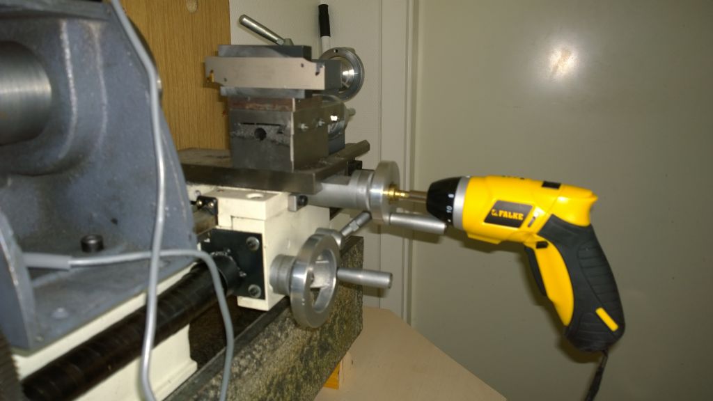

                        ega
                          @ega
                          Nearly always on the Willson where this feature is available but never on my pre-PXF Myford.
                          When hand feeding it is sometimes helpful to use an extended handle for extra leverage and a smoother movement.
                          Instinctively, I feel that a lever-operated slide would work better than a screw for hand feeding.

                          Howard Lewis
                            @howardlewis46836
                            Almost always on the BL12 – 24.at 0.0025"/rev mubricated by brushing onand ordinary engine oil or soluble oil controlled feed through a needle valve.
                            On the mini, it has to be hand feed, but have just made and installed a rear toopost, so hope for betterb things.
