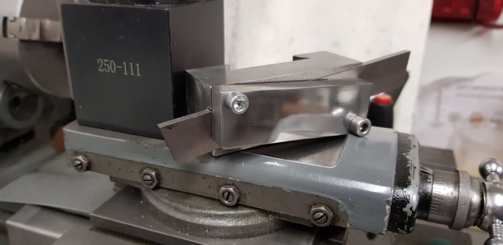

                          Steviegtr
                            @steviegtr
                            Here is one i made some time ago. It works, but i always struggle parting off. Agree with SOD's comments. I think my main problem is i do not go agressive enough since i caused a total jam up previously.
                            Steve.

                                Posted by Steviegtr on 14/12/2020 12:50:39:
                                Steve.
                                A good start, but next time, do make one such that the parting blade is horizontal. One should always part off with the minimum tool extension, which (with your design) means likely needing to reset the cutter on centre height if parting off a larger diameter workpiece.
                                I have discarded the parting tool holder which came as part of a kit – I would buy the QCTP tool post and necessary holders separately, if I were ever to buy another. The only advantage of an angled cutter, as far I can see, is that it can be sharpened at a right angle to its length – not something that particularly bothers me.
                                Yours looks as though it is extended enough for a 50mm diameter bar. Parting from any QCTP is going to cause consternation for many, like that, as the cutter is both displaced longitudinally from the cross slide and has lots of overhang and leverage on the tool post holder, tool post, top slide, cross slide and carriage… And that would be true for even a new machine.
                                I had occasional aggravation with my previous lathe while parting off, but none with the current one which came with a rear tool post already fitted.🙂
