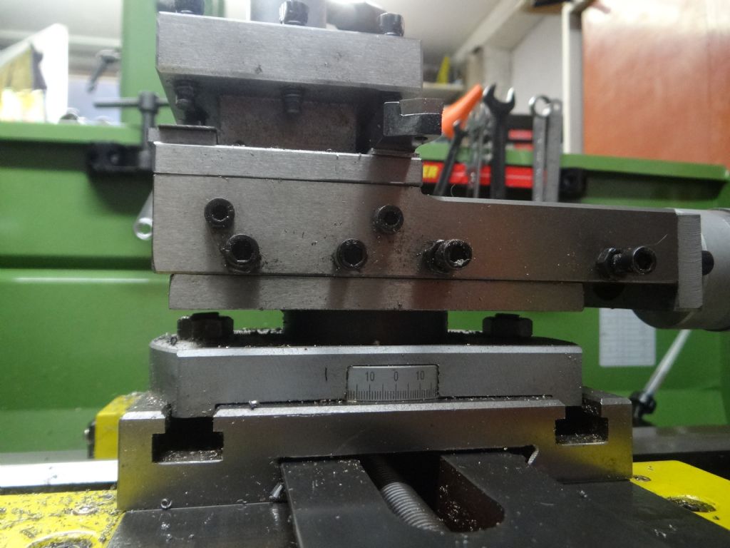

      20170410_171402.jpgHi all.
      The turret lathe i bought came with a short tool post which turns out to be a parting off tool post.
      Never seen this type before which presents the tool behind and below the work thus providing quite a rigid set up.
      Lathe has to run in reverse and it irks really well.

                George Thomas wrote a good piece on parting off and it’s all to do with the geometry of the tool position relative to the diameter of the workpiece. Conventional tool placement allows the tool to dig in deeply but placing it in a different alinement means if it catches it cannot dig in but is pushed away from the work,not deeper into it.
                I can’t explain it as well as he did.
                This tool holder and position is by far the most rigid I have seen as the tool is not able to flex and is being pushed into the bed of the lathe. I can’t comment on the possibility of digging in but I will do some experimenting. Mick

                  The lathe has to go in reverse because the tool would be presented on the "wrong" side of the lathe. The conventional way has the work piece rotating in an anti clockwise movement down, and into the cutting face of the tool.
                  Working from behind the lathe, a rear tool post cannot hold a conventionally ground tool because the workpiece would be rotating, still in an anticlockwise movement lets presume, up and into the underside of the tool, not cutting in the way you want it and most certainly rubbing rather than cutting.
                  It is because of this that the tool has to be placed upside down so that the right cutting face is presented, with the clearance angles all there, to the work piece.
                  A lot of cheap lathes in the past did not have a reverse function, so the lathe would only spin in an anticlockwise way, so came the rear toolpost, along with it's upside down tools,
                  this also meant that if the user was canny, they could have two toolposts in play without needing to stop to switch tools for parting off.
                  The theoretical reason why it is also good for parting off is because the tool is less likely to slip under the work piece, be drawn in and snap either the tool or the work piece, normally the tool. So a rear tool post would encourage the tool to go "up" and away from the work piece rather than the opposite. This tends to happen if the tool is too low on the centre line.

                      Hi Michael W yes it is. It’s a capstan Lathe so can be set up with a front and rear tool post.
                      It’s the first time I’ve seen such a low tool post but it makes sense and works great as there is no overhang as there would be with a standard height post.

                              Rear toolposts are all smoke and mirrors if the lathe has to run in reverse.
                              The lathe just becomes mirror image of a normal toolpost with the lathe running forwards. All the forces are exactly the same and the geometry is identical.
                              Just imagine standing behind the lathe using a rear toolpost and running eth lathe backwards. All that's different is that the headstock is on your right instead of your left.
                              Now a rear toolpost with an inverted tool DOES have a completely different geometry.
                              The toolpost above works well becuase it is well designed – rigid with minimal overhang – not because it is fitted at the back.
