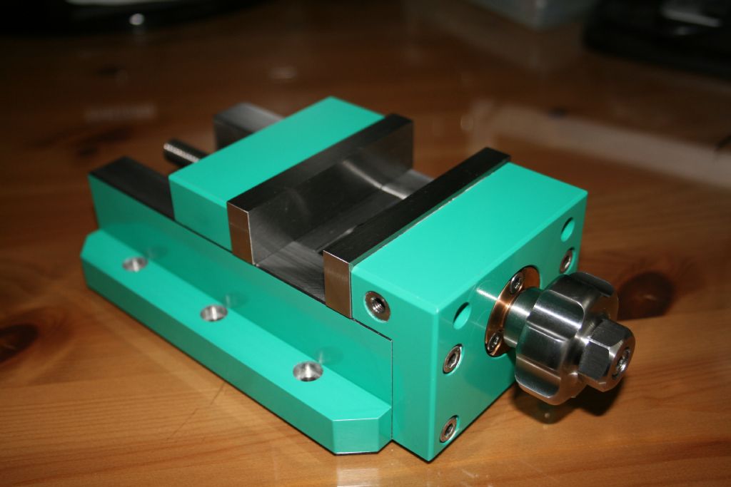

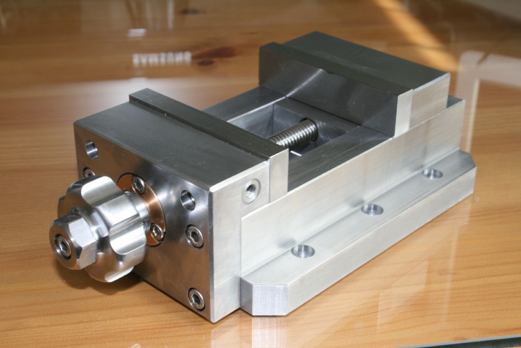

      After spending a fair bit of time kitting out my workshop, retrofitting CNC machines and a house move. I have reached a point were I can start creating!
      but….before I could dive in to rc aero engines I was struggling to find a vice that would fit my Denford Novamill and the projects I had in mind so I decided to design my own. So this became the first project and (I can say now its finished) was a good one for understanding the machines and tooling I can gathered together.
      The parts were made on either a Denford Starturn lathe, Novamill or warco mill.

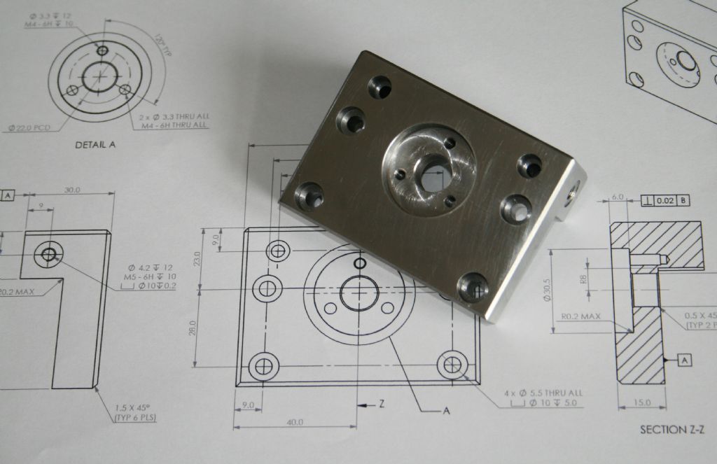

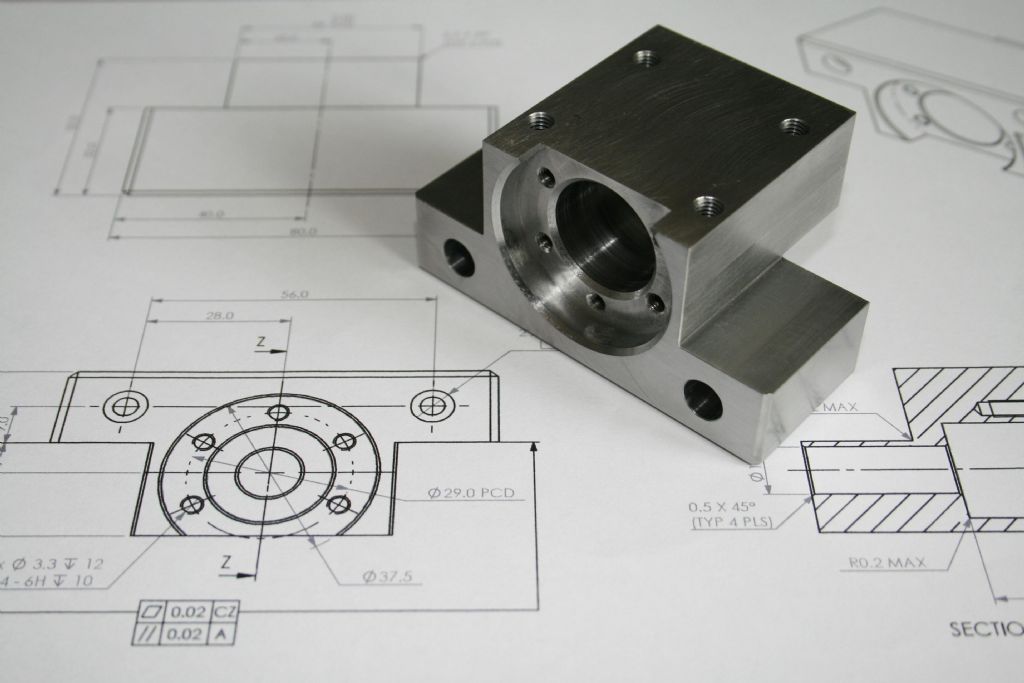

          Some drawings…..

                Michael, that's too good to bung on a machine and get swarf and cutting fluid on it!
                Rick
                #149075
                John Stevenson 1
                  @johnstevenson1
                  Michael,
                  Nice work.
                  Anyone notice that this vise / vice is ideal for a CNC machine in that the fixed jaw is the one nearest to you ?
                  So if the left hand side of the fixed jaw is referenced to 0,0 then all moves will be in the X+, Y+ quadrant which is the way most people draw.
                  The drawback to using a vise where the back jaw if fixed is that 0,0 will move in relation to the width of the blank parts put in the jaws.
                  Again nice work and do send it in for Neil to use.

                            The vice is 80mm wide jaws and opens a maximum of ~80mm so this only just fits on the Novamill. I have fitted a larger bed to my mill and a column raising block so I'm a bit better off for space.
                            I have component and assembly drawings so an article in MEW would not be impossible.
                            I like your design Gray, very low profile. My vice uses an 'off the shelf' leadscrew and nut and it was packaging up the nut that really set my height (~60mm)
                            Future plans are to do end stops and different jaws.

                              From the shots I have seen Michael your drawings are first rate and very understandable.

                                    Micheal, that paint finish is excellent – maybe you could include the paint process as part of the article, I'm sure others would benefit smiley

                                      Neil has given me the green light to submit and article for MEW so I will have a go at putting one together and hopefully see my design in print. It will be my first article so will see how it goes.
                                      With regards to the paint I`m embarrassed to say its nothing special just 100ml plastikote spray cans over a grey primer. I like this paint as it has good self levelling properties and remains flexible. How it stands up to oils I will have to wait and see. A column raising block I made for the mill uses the same paint and is still mostly attached.
