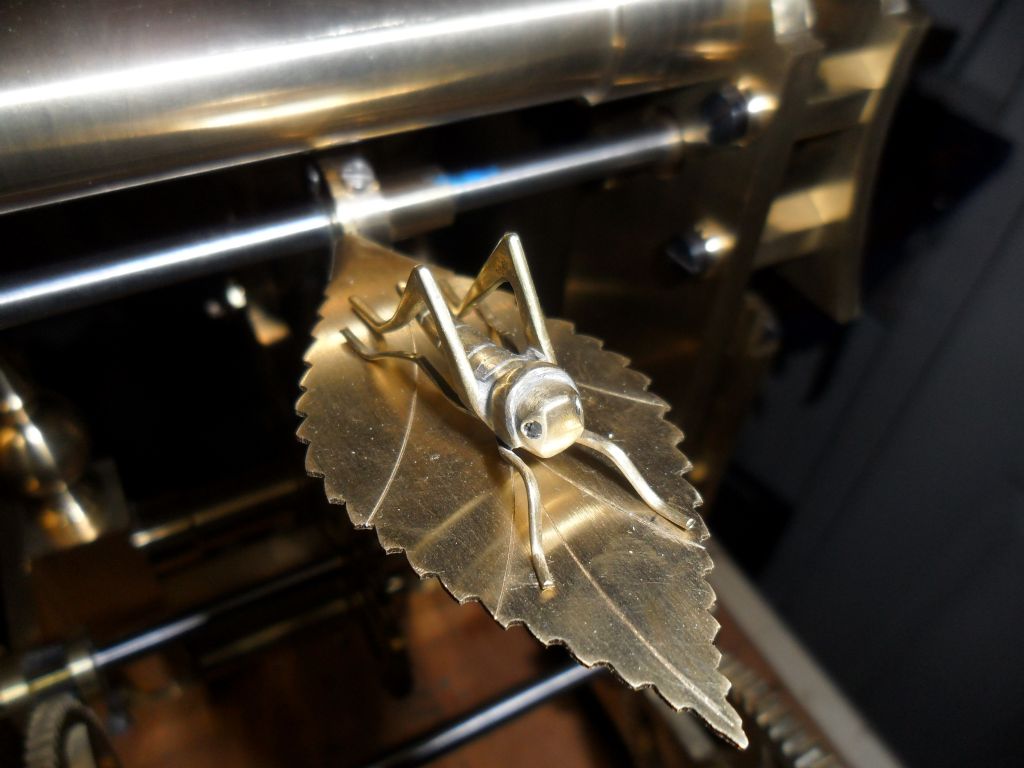

              #396148
              Stephen Spice
                @stephenspice48575
                Michael,
                Your youtube demonstrates exactly how this works.
                My photo's will show two bobbins operating the mercury switch and with a weight resting on the clock weight and a second tension weight. As the main weight raises or falls the switch is tilted.
                Stephen S.
                #396174
                  Posted by Stephen Spice on 13/02/2019 19:39:08:
                  My photo's will show …
                  Stephen S.
                  Nice clock! I particularly enjoyed this touch:
                  Must be a grasshopper escapement…
                  smiley
