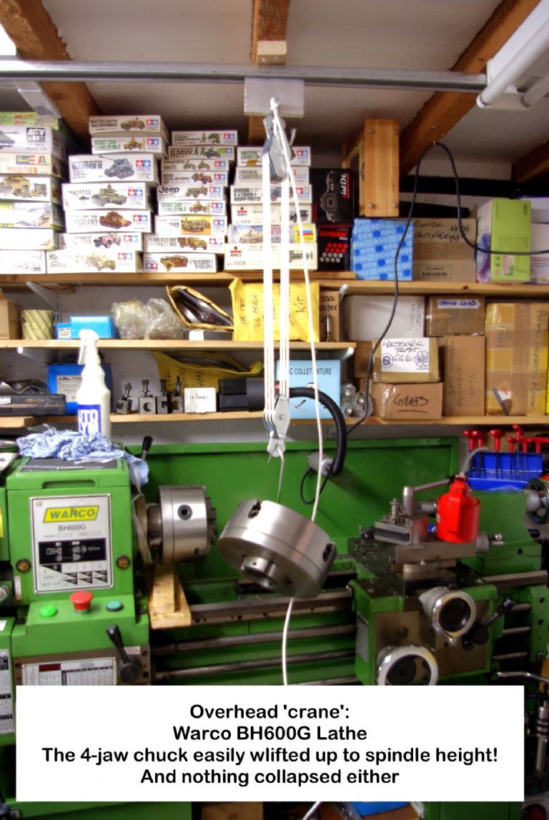

      With the Unistrut in position the assembled trolley was slid into place and it whizzed along the rail without any problem, but the real test was yet to come.
      First thing up was the standard faceplate that felt feather light, proving my system worked, so the real test was next.
      The 30lb (15kg) 4-jaw chuck that 20 years ago would have meant anything to lift, but age and BigC treatment meant I wasn't happly lifting that to spindle height.
      Now I needed to find a way to hook the lower pulley to the chuck, but a large S hook came to the rescue, it being hooked round one jaw with the others tightened up againt it. Nice and firm.
      The test.
      A gentle pull on the nylon rope/string had that chunk of metal rising into the air as if it was half the weight, and no creaking of wood or sound of screws parting company with wood, prooved my desing.
      WhooHoo it worked like a dream, and the 3m length of Unistrut covered all three machines.
      All I need to do now is make something to store the chuck and large faceplate I have.
      I am chuffed to say the least at the outcome.

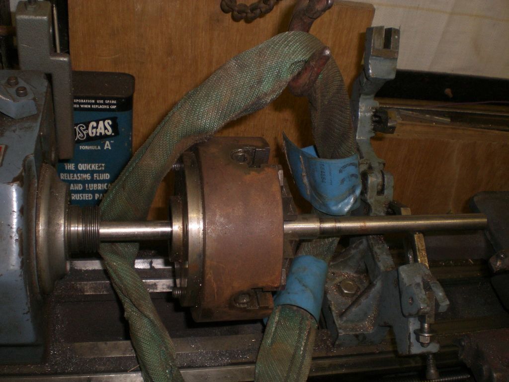

              I'v started a similar set up, the rail on mine is made from 2 bits of angle iron welded back to back (old bed frame), now I'v gone electric, I built a hoist using a garage door opener motor, powered by my work shop low voltage supply. I'll see if I can find a photo of it at some stage, and put it in my album.

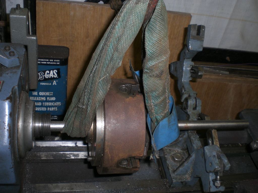

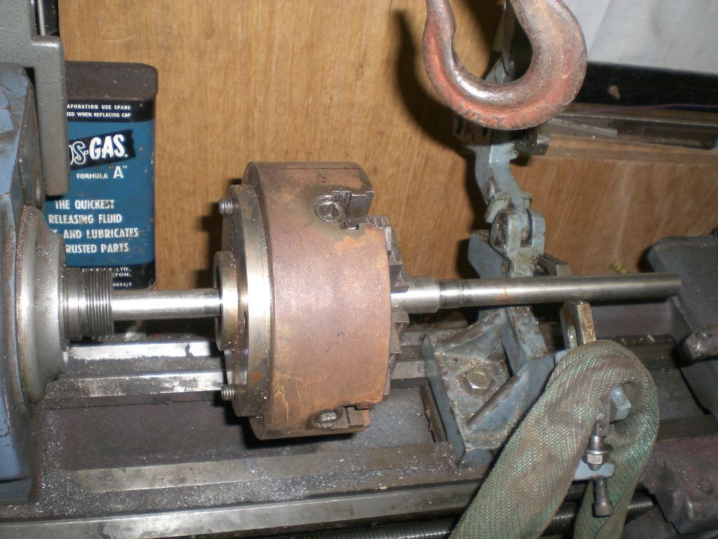

                  Hi Geoff, good idea, using lifting gear is much better than man handling, but I think you can sling your chuck much safer and present it to your spindle ready to screw on with a round endless sling and using your fixed steady as shown below.
                  Using a suitable size bar or tube which will fit reasonably loosely into the bore of your spindle and long enough to reach your fixed steady from the front of the spindle with a gap inbetween to get the chuck with the lifting sling attached and allowing enough of your bar overhanging the steady to allow the chuck to be slid up to the spindle with some overhang to spare.
                  Then gently lower it down so the bar rests onto the bottom two fingers of the steady and the other end of the bar lined up with the spindle bore, it can be easyly slid towards the screw thread on the spindle.
                  The wieght can then be let off completly and the sling can then be removed out of the way.
                  It can then be slid right up and engaged onto the spindle thread.
                  Your bar and steady can then be removed once the chuck has been screwed on a significant amount.
                  Of course your chunks can be removed the same way in the reverse order that is.
                  You can get these slings off ebay at a reasonably price. **LINK**

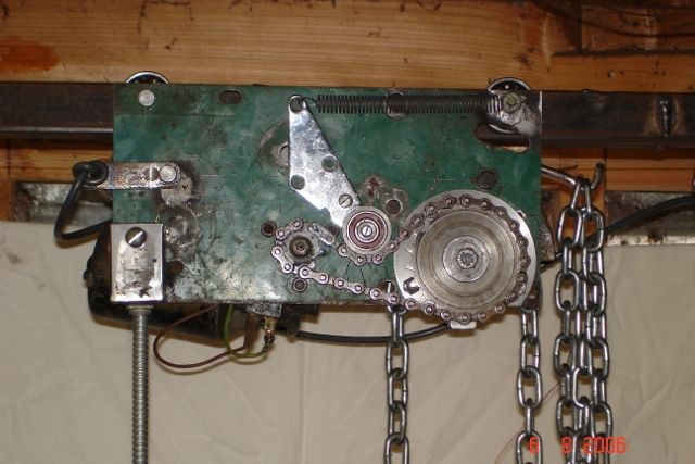

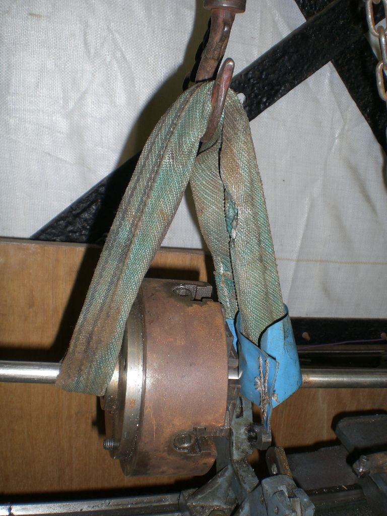

                              I'm just glad I don't use a friends little lathe too often, it's a vintage Pratt, with 16" (I think) chucks, last time I used it was to remachine the ring grooves in a piston for a Lanz Bulldog tractor. Since then he has built a crane for chuck handling. Ian S C
                              #124026
                              Ian S C
                                @iansc
                                dsc00228 (640x427).jpgThe hook is on the left hand chain fall. There are more photos in my album, that show the other side of the hoist. Ian S C

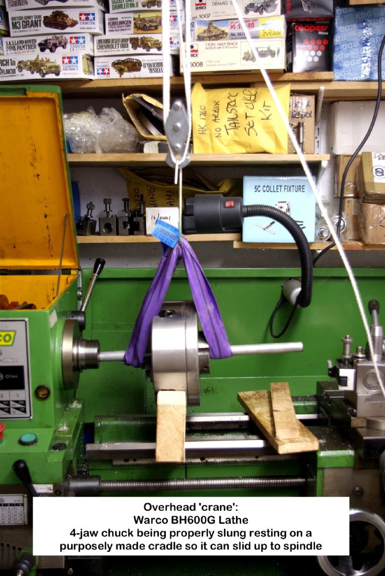

                                                      Update.
                                                      Overhead crane
                                                      I bought a couple of the slings that Nick mentioned, before JohnS' post, and they arrived yesterday.
                                                      Thanks to Nick's description of the way he lifted his chucks, I did the same using a piece of steel tube but with one sling only.
                                                      The chuck lifted easily, and much more safely as well this time.
                                                      I, however, made some wood cradles for the chucks to be lowered onto and nearly melting in the 30 deg temp in the carport, the cut-out in the wood positioning the chucks at spindle height, so all that's needed is to push it up to the spindel and screw the chuck on. So so much easier now!
                                                      For the 3-jaw I had to cut a groove in the centre of the cut-out for the jaw adjusting screws as they are proud of the chuck circumference. Did think of turning them flush, but sense prevailed.
                                                      If I was lifting the chucks by means of the cradles, I would have made them wider of course.
                                                      Just need to figure out how/where to store the chucks now.
                                                      More photos added.
                                                      Geoff – Changing chucks now a pleasure
