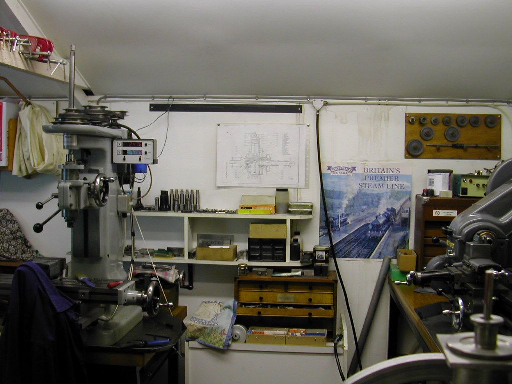

      I don't know if anyone else on here has or had an Ortec DRO. Available from the 'guy who made them' in Guernsey or Jersey if memory serves correct and who was always at the ME shows promoting his product.
      I bought a simple two axis version for my Linley mill about 23 years ago and it has served faithfully without issue until today. We've had some building work done and since I used the mill last they have been cutting paving blocks and overloading the circuit to my workshop blowing the traditional fuses (not CB's) a few times. Whether that has directly affected it I don't know but have done the usual – unplugged and re-plugged the power supply several times along with the two sensor cables – sometimes it's just blank other times incomplete digits and nothing registering from either scale. Looks like it's buggered.
      So, what's a reasonable cost alternative DRO ? Or does anyone have a spare Ortec read out box under the bench says he with hope.
      Any thoughts appreciated
      Cheers – Tug

            Thanks for the input David but no, it was not the wire type but was possibly the first DRO suitable for the home ME using glass (?) scales. I believe (I was told) the owner was sadly killed in a road accident as they suddenly became unavailable.
            The readout is .0005 inches and .01mm – here's a pic of the readout in situ
            It's certainly beyond me to fix other than as previously stated – It's probably best to replace it hence the question – can anyone recommend a reasonable cost alternative?

                            Hi 'Guys', Thought you might like to hear this
                            Thanks to the very kind gesture by '10ba12ba' I now have my DRO back up and running. What makes it even more special is that John has not been well and yet still managed to help out.
                            A really big thank you 10ba, it is so much appreciated. – Samphire will be winging it's way as soon as you let me have an address.
